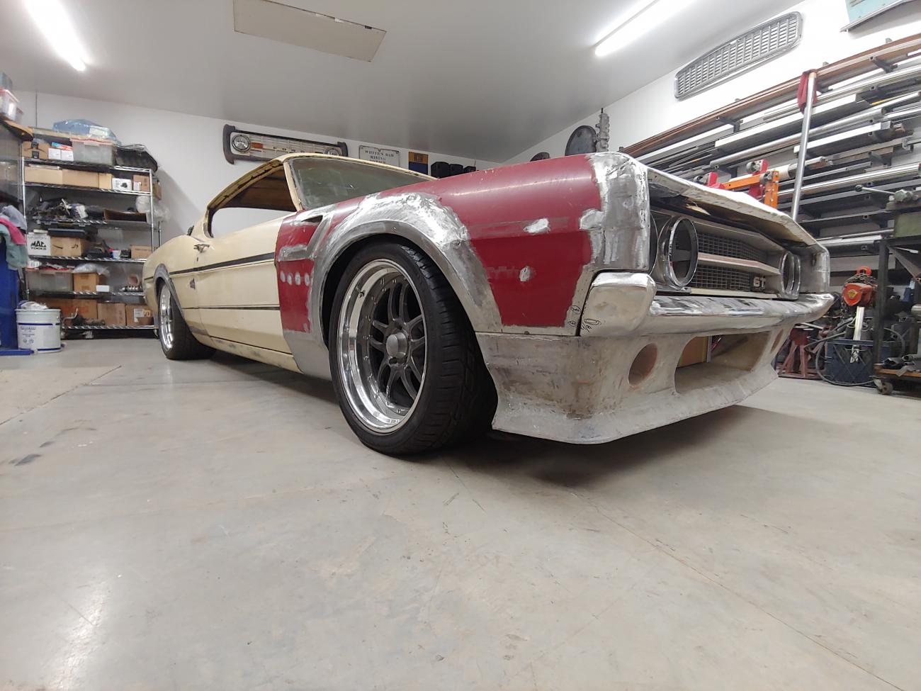

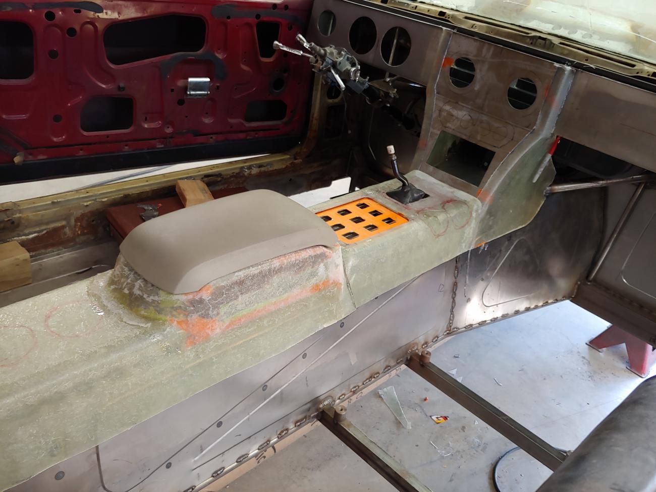

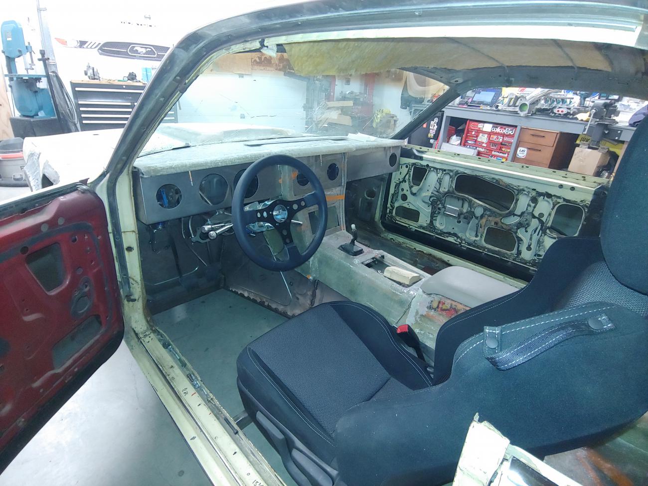

Some update pics. Ordered the guages and stereo head unit and have been working on the dash and console. Got the AC condenser mounted along with the air to water intercooler radiator mounted. Got some fab work done on the rear seats . Had to rework the front seat crossbars for the new seats I'm going with. Worked on the clutch and brake pedal geometry and have them all setup. Still have to fab the throttle pedal. Fuel cell is made and mounted but still have to layout the lines.

Looks great, Gary!

Some of the pieces coming together.
All the switches are momentary and some will operate self latching relays for thier function. There will be backlighting around the switch in the recessed opening.

Excellent! Could you share more about the custom engraved switch panel?

Thanks everyone. What would you like to know about the switch panel Goosedad?
