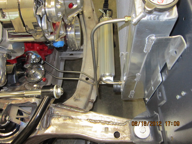

I made some brackets and mounted my power steering cooler. I still have to make the steering lines. I might make them tomorrow.
I, also, installed the transmission cooler lines. What a mfer it was to install those after the motor was installed. I knew I should have installed them prior to installing the motor/trans. They are TH350 lines and they fit right up to the 4L60E.
