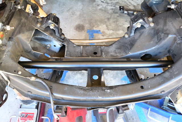

-Coil over conversion/reinforce front sway bar mount.
-Stiffed up the sub frame/body. Seal up any gaps.

Good reason to reinforce the sway bar mount. Not sure if that explained the car was somewhat twitchy during the drive to CC.
DSC_3461

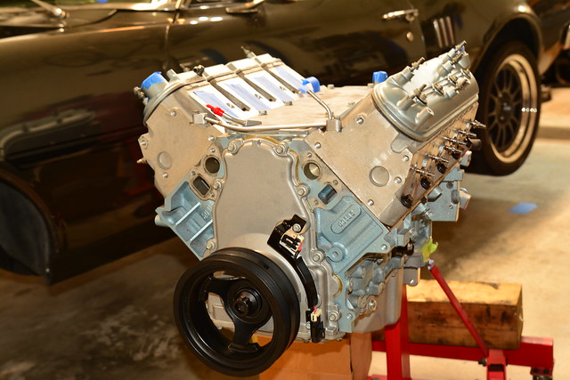

Picked up a rebuilt LS2 short block. Added 243 heads (cleaned up with new PAC springs/ti retainers)

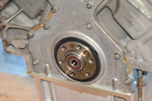

New rear seal/LS2 valley cover.
IMG_0555

Engine bottoned up

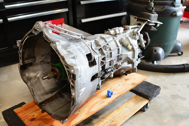

Used TR6060 out of 2012 Camaro SS.

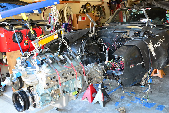

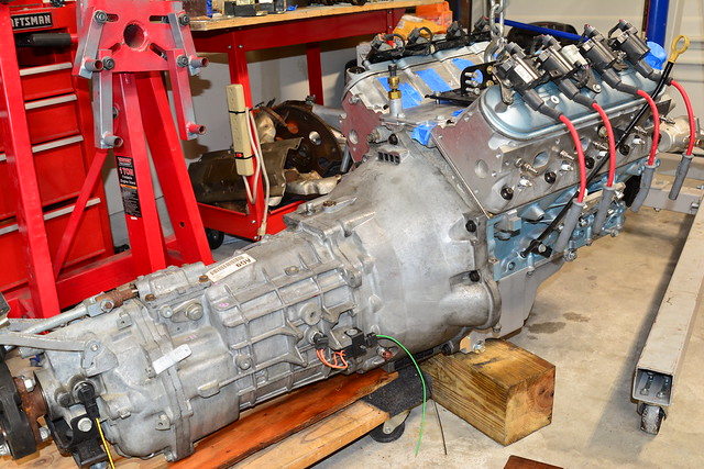

Engine/trans mated up.
DSC_3505

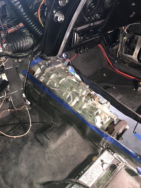

Test fit the engine/trans combo
[url=https://flic.kr/p/LHp9Rm]
[url=https://flic.kr/p/Kcc8tc]

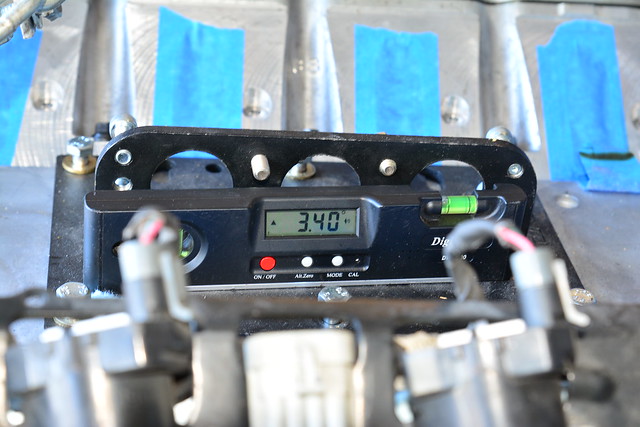

Have it set at the desired angle (roughly 3.4 deg down), with trans tunnel removed.

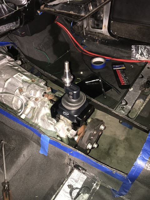

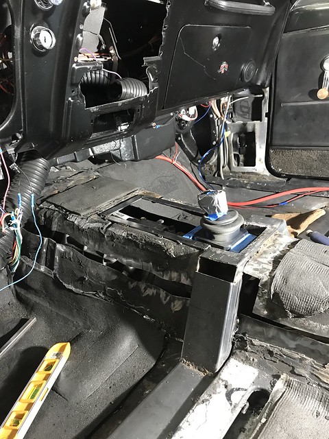

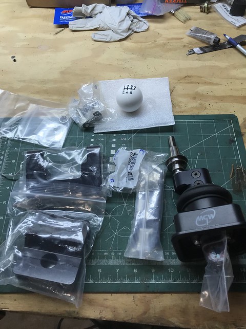

Quick shot of the MGW shifter/adaptor, and a shot of it mounted.
[url=https://flic.kr/p/27KHvRL]
[url=https://flic.kr/p/28LPPDw]

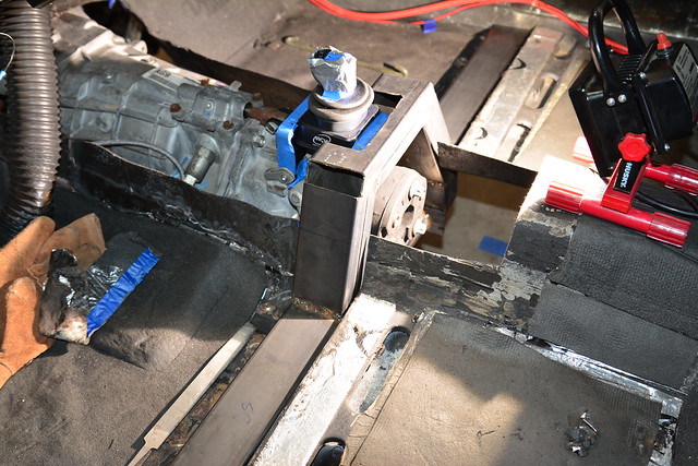

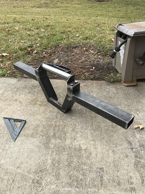

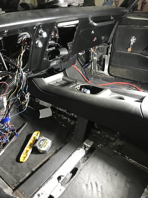

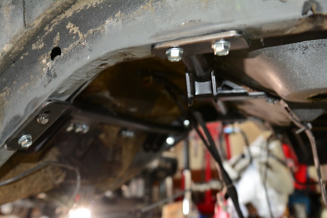

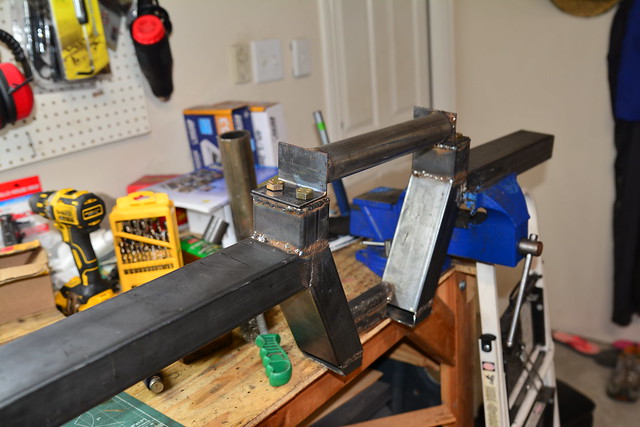

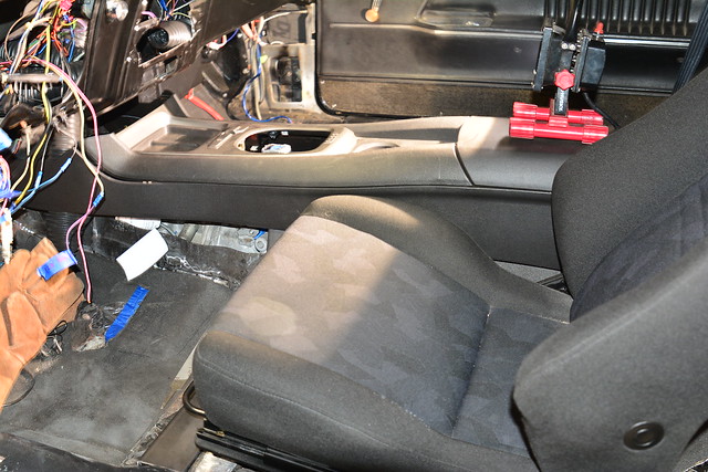

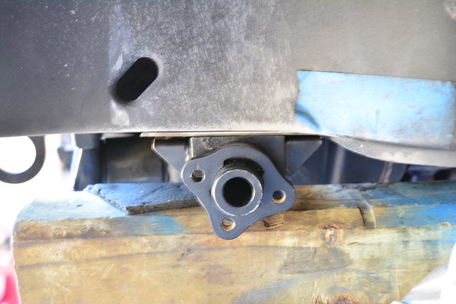

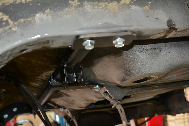

Made a trans mount that ties in the floor board/rockers, similar to DSE/others on the board.
Test fit with the 5th-gen console/seat in place.

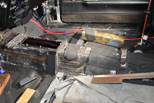

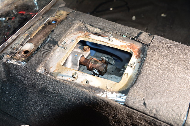

Welded up the trans tunnel/shifter hole; and welded in the mounting brackets for the console.

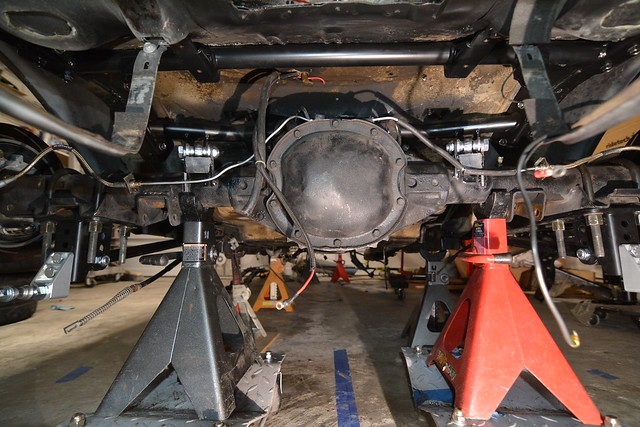

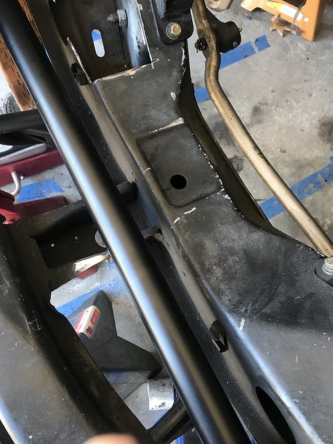

Purchased a Ridetech 4-link from a forum member, and got it welded in place.

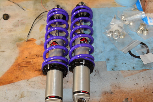

After the engine/trans sat in place, I worked with Ron Sutton in upgrading the suspension - front and rear coil overs/monster sway bar from Ridetech
Got to have purple springs.

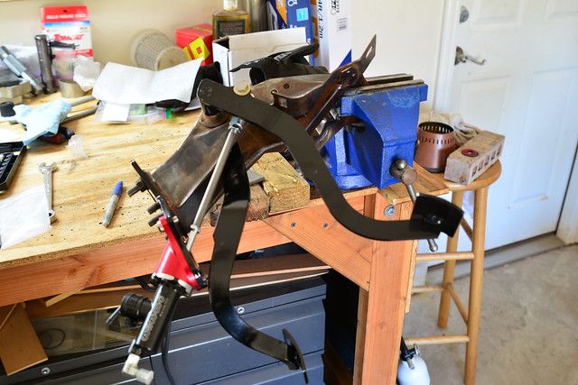

Also got the McLeod's hydraulic clutch conversions mocked up. I didn't take pictures but I welded a bracket to mount the safety neutral switch (which I will use the old brake switch - going thru a relay)

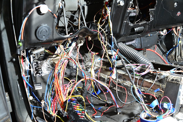

With the mechanical stuff sorted out, I turned to clean up the wiring under dash.
Added connectors to switches/gauges/lighting so that I can easily remove them later - here's one of many connectors.

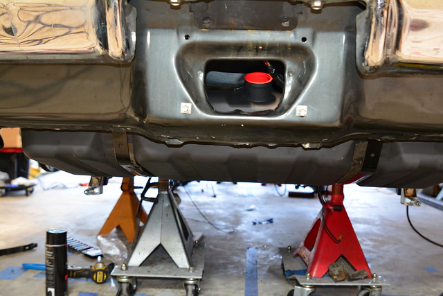

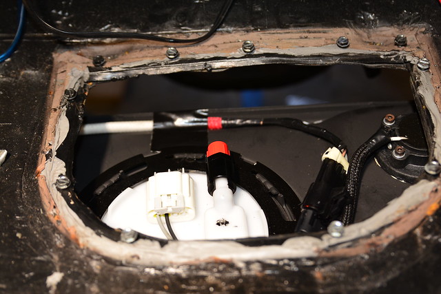

I had a Tanks Inc fuel tank, but during the USCA event, I had to keep it half full to maintain the fuel inside the baffle. So, I sprung for the new (at the time) Rick's restomod tank with 5th-gen pump/corner pick up.

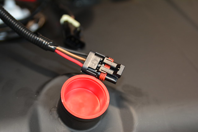

Added GT280 connector to the fuel pump leads.

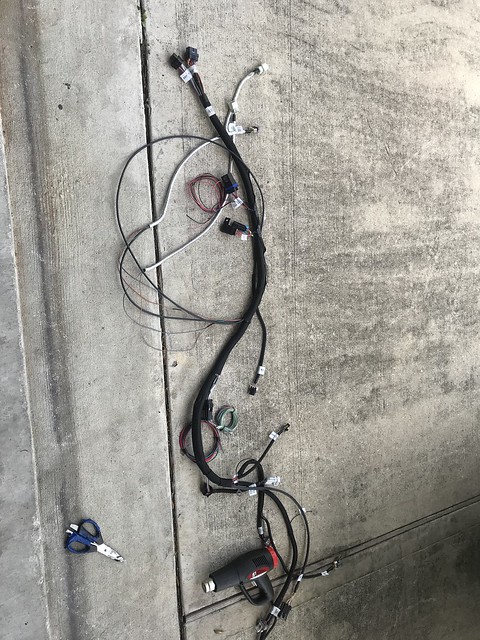

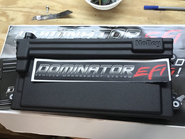

Took advantage of the Holley sale during the Christmas holiday, and ordered all my Holley EFI stuff (ECU/wiring)
Reworked the Holley harness

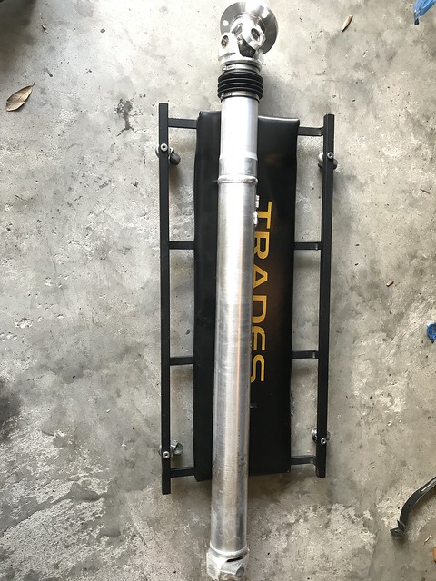

Driveshaft with adapter

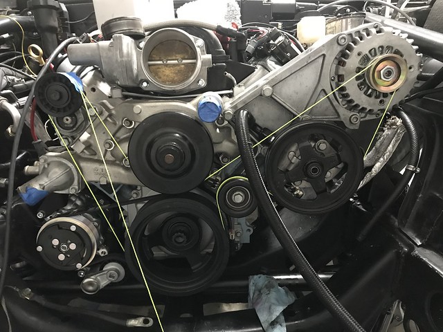

I relocated the AC compressor to the bottom pass side of the engine (stock LS2) location to make room for the engine down bars, so a mini compressor/brackets are need. Also, a new belt is necessary.
Measured for drive belt; and the part number for the drive belt used.
