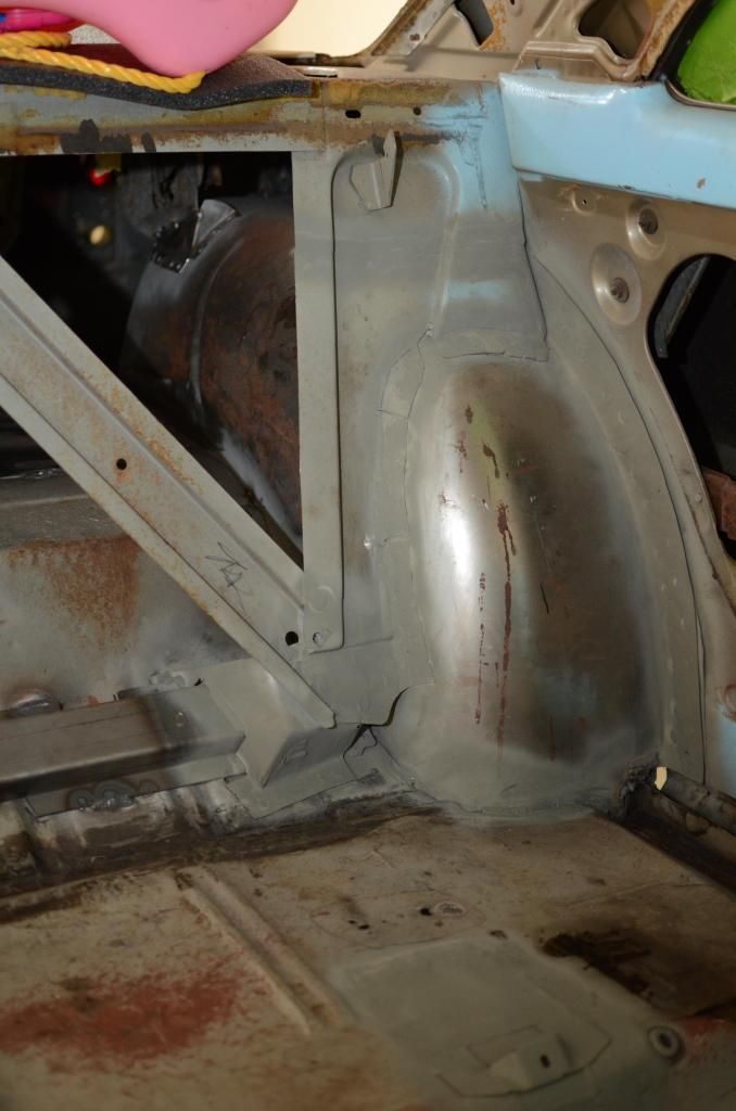

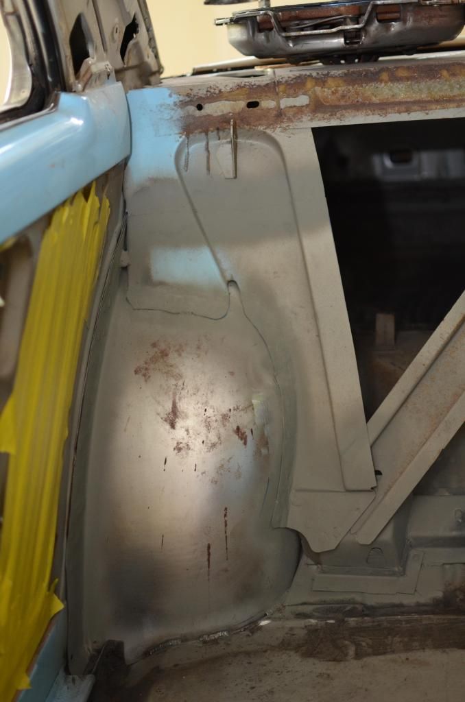

Not really a flashy or cool update but the detail work must go on! I decided to finish the work at the back of the car before starting work on the motor swap. I just don't do well with too many irons in the fire.
So in the past few weeks I've been mainly focusing on my daughter, she's now 8 months old today and she brings more fun and enjoyment to life everyday. But after bed time, I get a hour here and there to make some progress on the ol' car.
First pic, the important stuff in life.

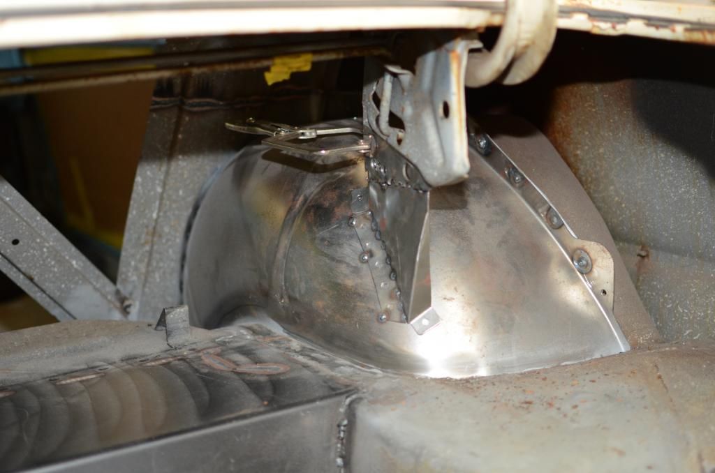

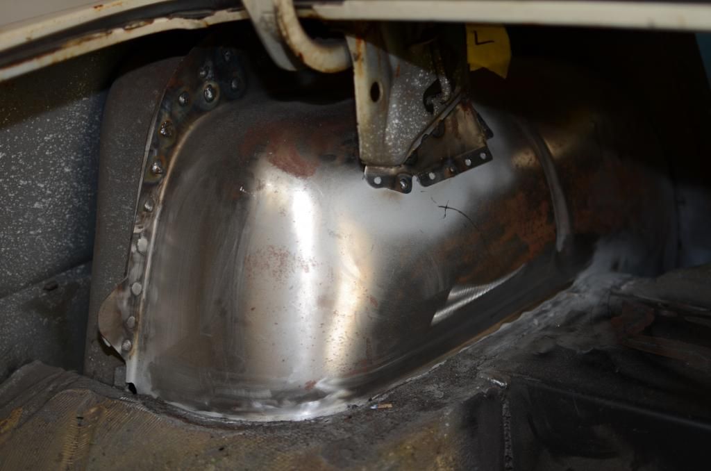

These are some pictures of modifying the rear seat-back brackets and boxes for the dse mini tubs and quadralink
Started on the trunk hinge supports, I decided to just make these both from scratch, the dse instructions state to modify the passenger side mount but I really didn't make since to me what they wanted so I just made a new one.
