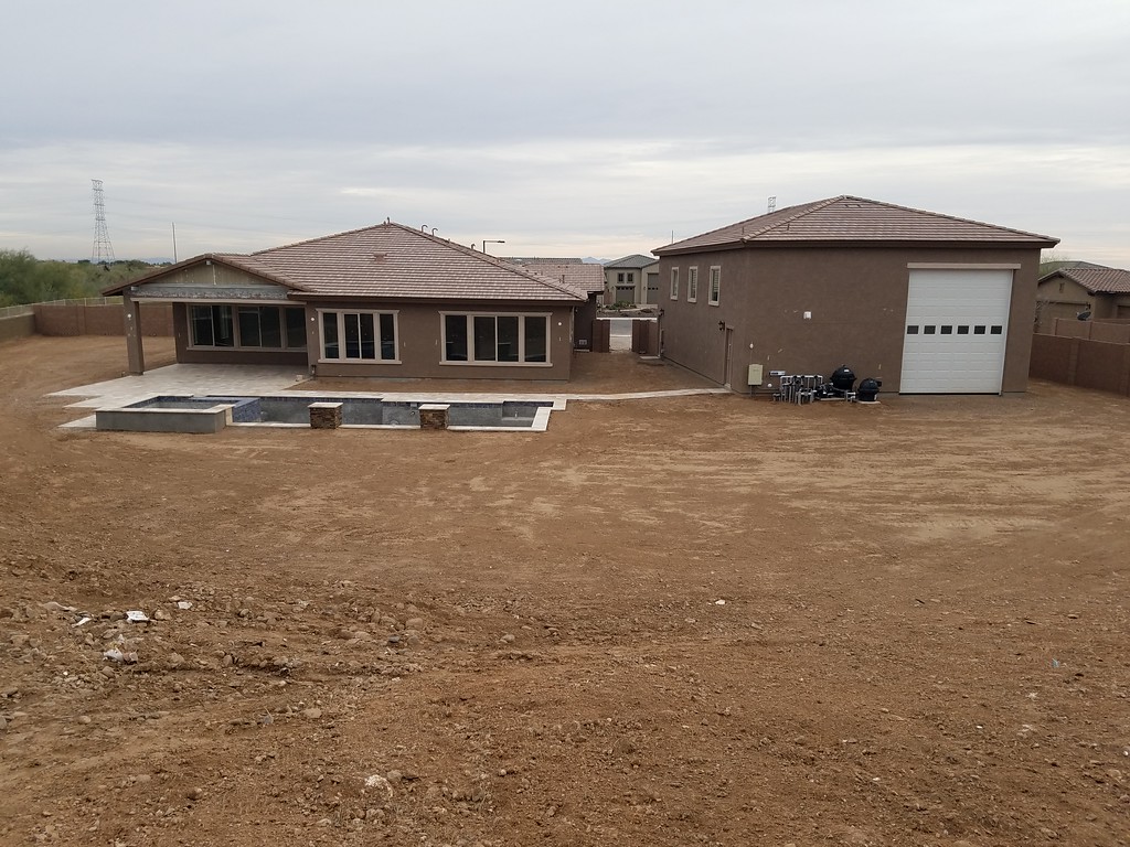

I've got some updated outside pics if anyone is interested?
The builder finished "their version" of the final grade a couple of days ago. It shows pretty much what the lot will lay out like. We have narrowed the landscape contractors down to two and are tweaking the final plans now. Whichever one we chose will be able to hit the ground running right after we close April 12th.
The front yard and driveway...
Area directly behind the RV Garage...
I'm having 1/2" screened rock put down behind and beside the RV garage for parking, turn around and such. The car trailer will be tucked in between the shop and fence when not in use.
The outside AC condensor for the shop will sit along the back wall between the pool heater and the garage door and a Pool Equipment wall will hide the equipment so it can't be seen from the pool area.
Future plans call for a firepit area on this side of the pool from the house. For now we are putting a BBQ island over on the side of the travertine deck closest to the fence.
