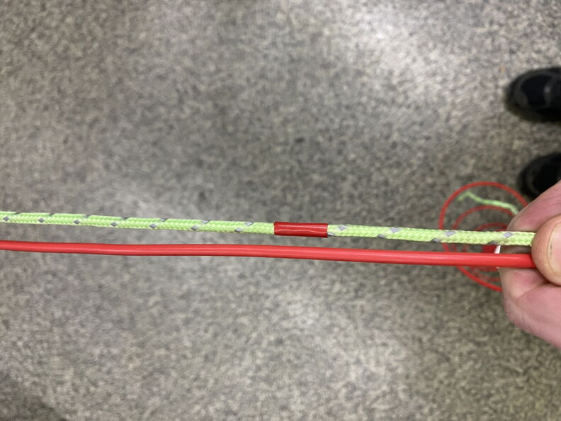

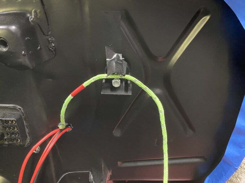

So I have kept the this paracord for years and I use it to estimate wire length.
Anchored it to my the wire and paracord to my vise.
The red tape references the length needed.

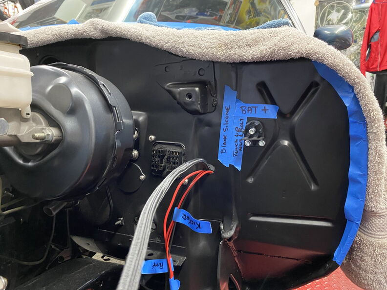

Time to start anchoring the wires.

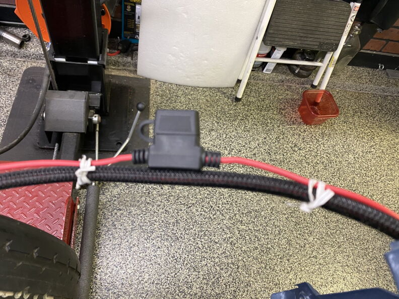

Reminder that I need to install a fuse in the wire.

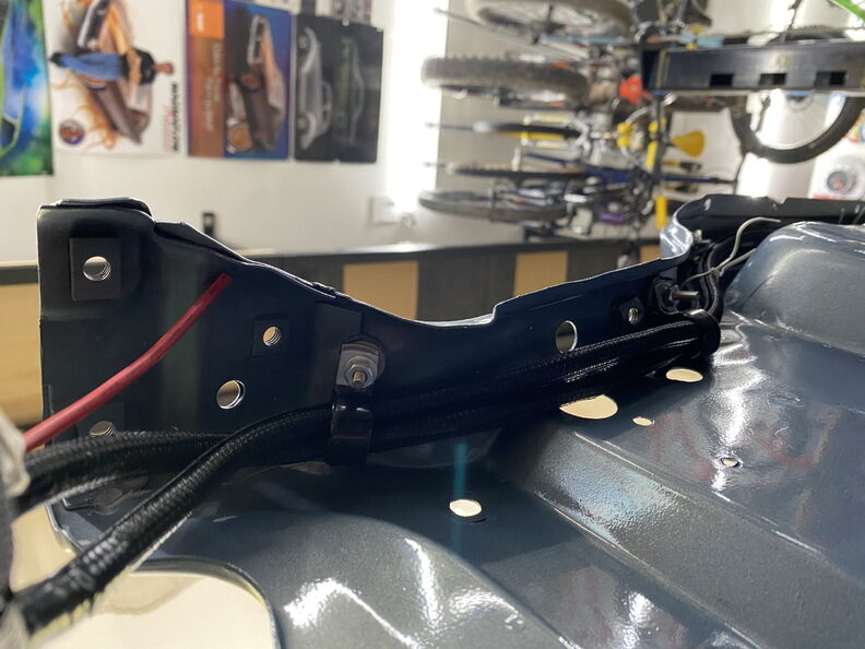

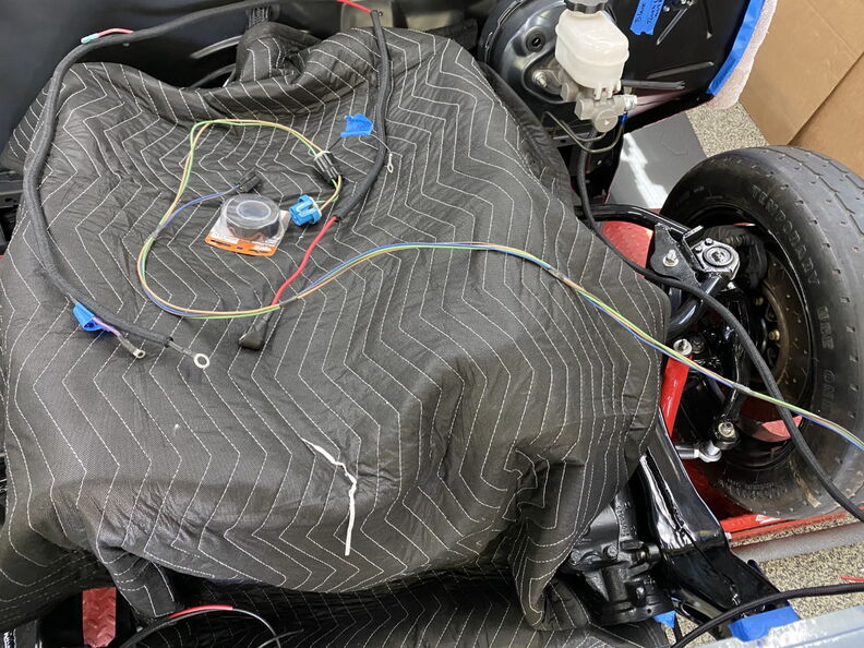

Moving on to the Headlight Harness ( 04-18-20 )

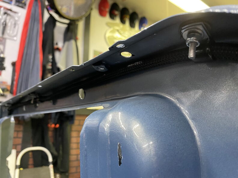

This is the adapter that comes with the DSE Truck Lights for the 2nd Gen Camaro's. Instead of bare wires I put a small piece of Tech Flex wrap on them.
I run the wires under the core support lip for a nice clean look if you happen to look through the grille.
Keeping with the somewhat stock appearing theme under the hood I trimmed the Wire Gutter down a little bit.

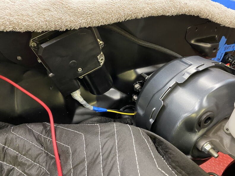

Next up is the DSE Wiper Motor & Harness. I will be removing the plastic wire wrap as it's so 1990's. Just kidding.
Sometimes it's nice to have a helper even of one of them doesn't have hands.
Really trying to figure out a clean way to route the wires.
In order for me not to lose pieces and parts I bag them and tape them to the windshield.

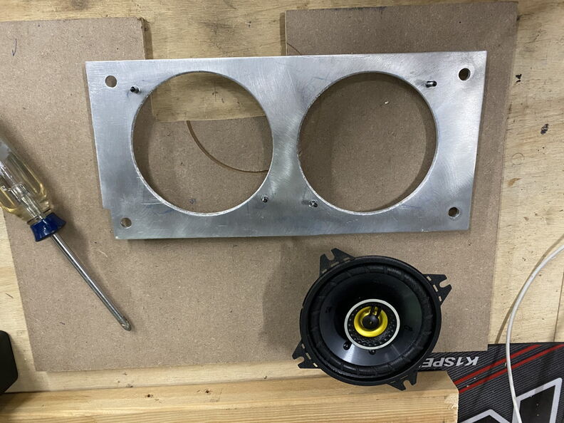

So, I finally test fitted the Kicker Center Channel
