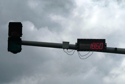

Today the daughter and I took a quick trip to the scales to verify the car weight.............
Weights are with just over 3/4 of a tank of fuel.
3360 with 90 lbs of fuel - Front 55.35% Rear 44.65%
