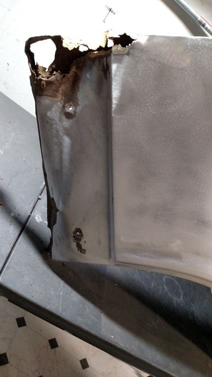

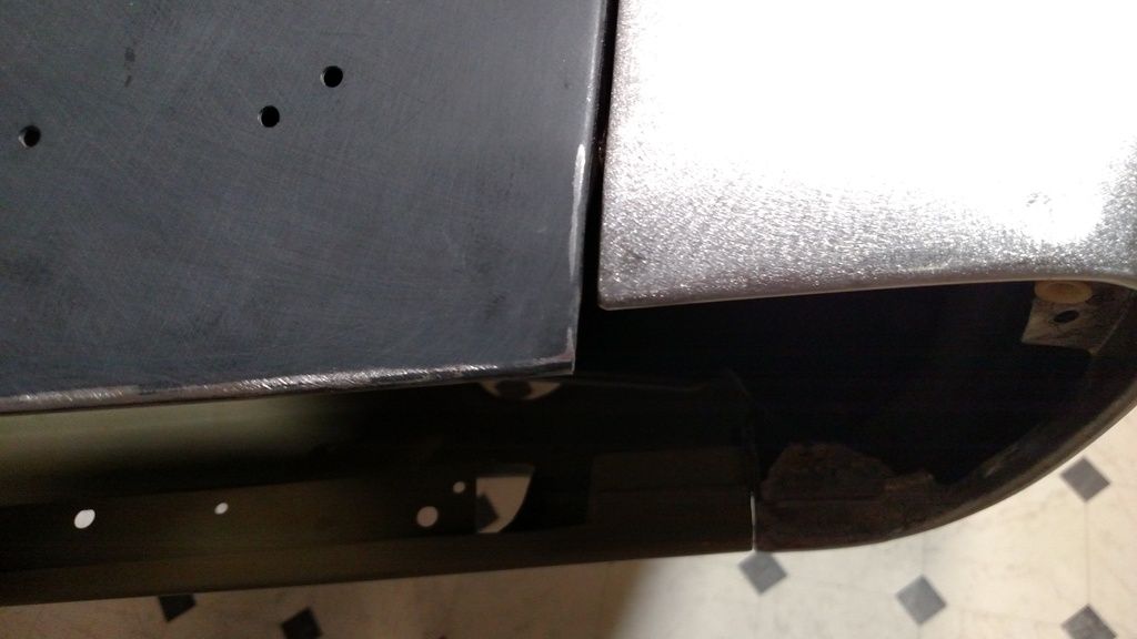

Yeah it does .... now to plan B the bonded AMD fender didn't fit. So plan B, use the original fenders that came with the car cuz I know they fit well!
So, the fun begins, stripped down the skin side to determine where it needs help ... what fun
The passenger side is the worst but not too bad, need hammer and dolly work in a couple of areas but it's not the end of the world. I ordered a patch panel and the brace from Classic so I'll get each fender prepped before the parts get here.
Take a look ....
Man I am so fed up with the repo sheetmetal
thanks for looking ...

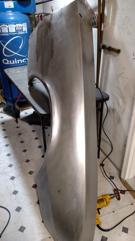

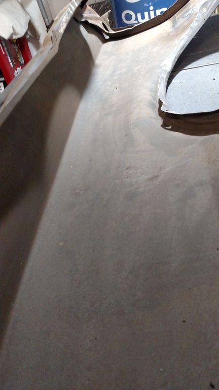

Mechanical abrasion is APTIA! Well. after 6 hours of d/a and fiber discs on the passenger fender, I realized I could never get the fenders as clean as I needed [read between the skin and the brace] so I sent them off to get chemical stripped.
Should have saved my time and sent them out sooner ... the driver's side did need some extra disc work to get the last of the lacquer paint off. Take a look ...
Still needs some work!
I could never get! this clean with fiber discs
Like working with new metal ....
Out with the old ...
In with the new ...
Well. that's all I have, for now, heading to NM for Xmas and some desert riding on the XR650R. I hope all have a great Xmas with those that mean the most ... thanks for looking!

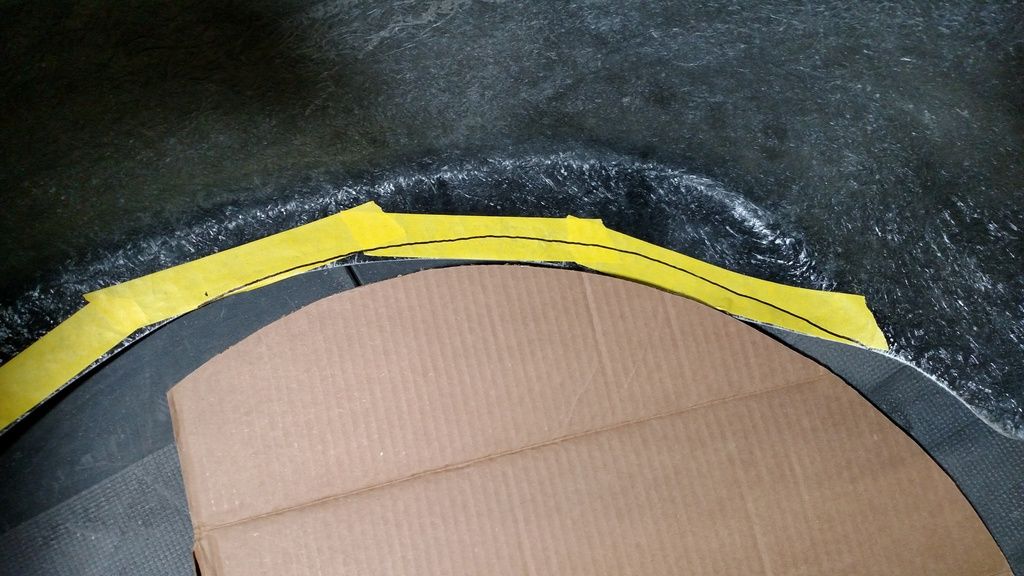

Well, the Glasstek tubs are close they do need some attention, specifically, the radius to match the OEM wheel arch is not the best, in fact,
the whole mold is too wide as compared to the OEM wheel arch. No biggy, I drew the arch on the fiberglass and sanded it down to more resemble the OEM arch.

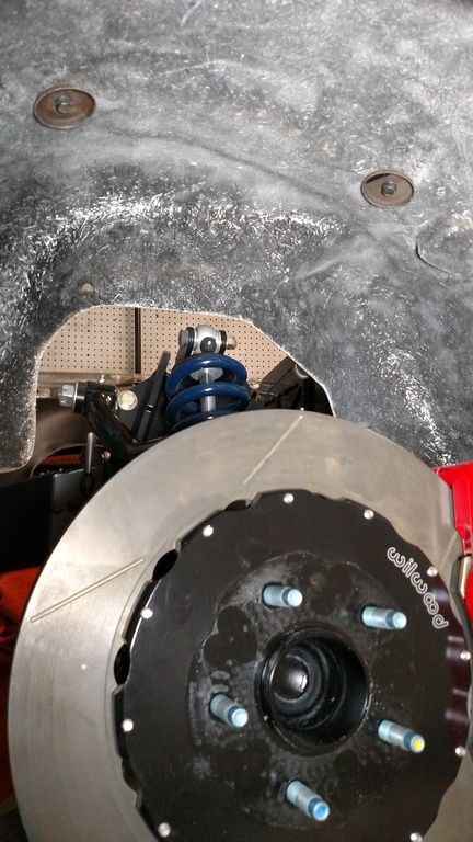

I did grind off the OEM steel wheel lip by 3/16 and hammer and dolly the radius to vertical.
As well as to hammer and dolly the upper mounts to the more horizontal plane to match the Glasstek tubs.
The Glasstek was a good mold for references such as the front drop off panel and the radiator support with dimples in the fiberglass that could be drilled out with confidence.
The only real difficulty was the tub to fender attachment, while the inner had the clearance it still needed to mate up the top brace like the OEM, I even used the OEM fender washers.
Once fitted to the fender I fit the tub to the car and marked the location for the top bolts to the fender brace.

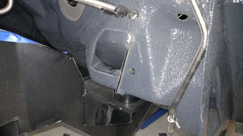

You do need to cut off the OEM fender brace coming off the firewall to allow clearance for the tub.
And my brake lines have to be redone because of the tub that came too close to the MC.
I bent the existing brake lines to exit the right side and enter the right side of the MC .... not sure I like them but for now, they'll do.

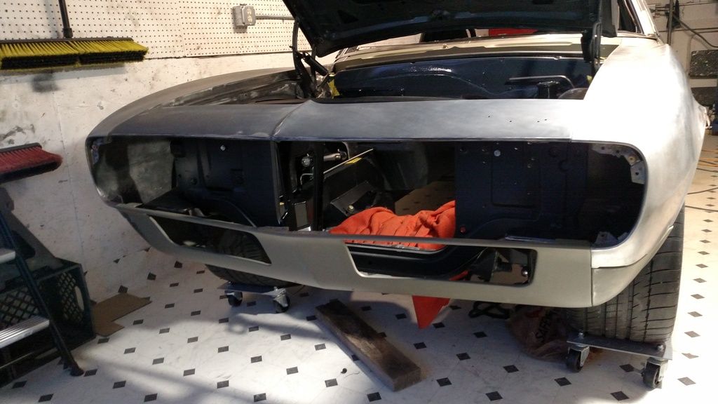

Now I need some help .... trying to get the hood latch assembly to play nice with the header panel. The latch will not just "fall in place" seems the distance between the header panel and the core support (5.779") and the latch support reads 6.082 ....hmmmm.
The puzzling thing is all the parts on the front end are from this car, except the hood, didn't figure on this mismatch.
I'm no rocket surgeon so if anyone has suggestions fire away ...
If I unbolt the fenders from the header and bolt the latch assembly to header and THEN bolt both to the core it pushes the header panel out past the fenders ...
Suggestions ?? Other 67 measurements header to core support???
Thanks again ....

Your aftermarket front clip should have 2 locations for bolting up the front core support. The first location (closest to the firewall) should be for 67-68 camaro and Novas and the second location a few inches forward should be for a 69 Camaro. I think you just bolted the core support in the 69 Camaro location. I may be wrong but on my Chris alstons frame it has 2 locations to bolt up the core support. If that doesn’t work I would just bend the latch assembly since that’s what looks like is pushing the header panel forward that 1/2” or so.
