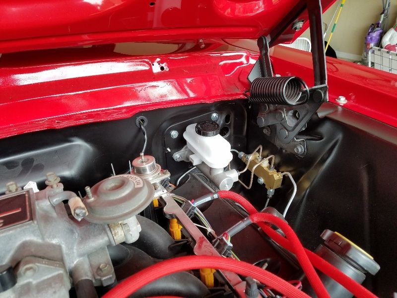

I ran out of room at the shop so I moved this to my house and started working on it again on the weekends.
I had a hard time finding a master cylinder that would clear the cam cover and did a search on line and found this Bronco II master cylinder and it fits.

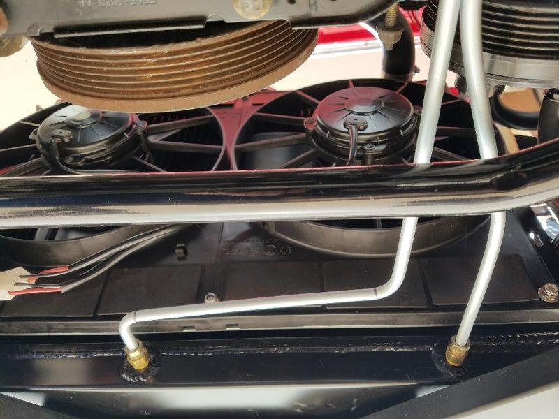

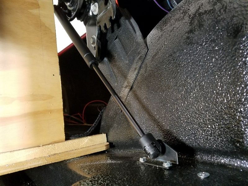

I have been using a board to hold up the deck lid after searching I found these struts from Mustangs Unlimited
My intake was cracked while I was replacing it I found a good place for the AC valve
New intake
Next problem I had was none of the brackets for the alternator would work so we had to cut and modify the first one to fit. Sorry no photo

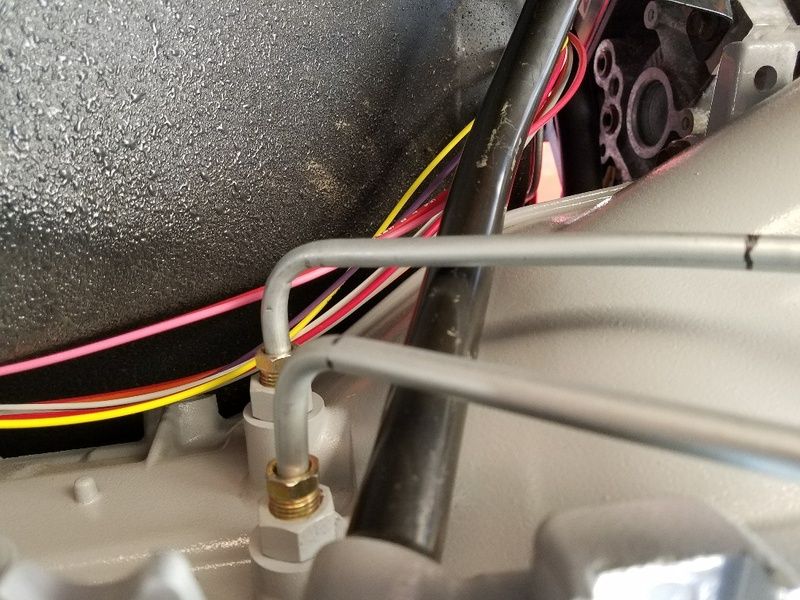

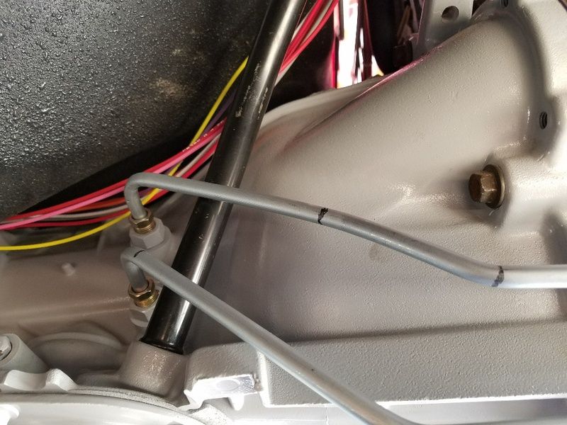

I bought stainless steel transmission cooler lines for the AOD but they didn't fit so I made my own

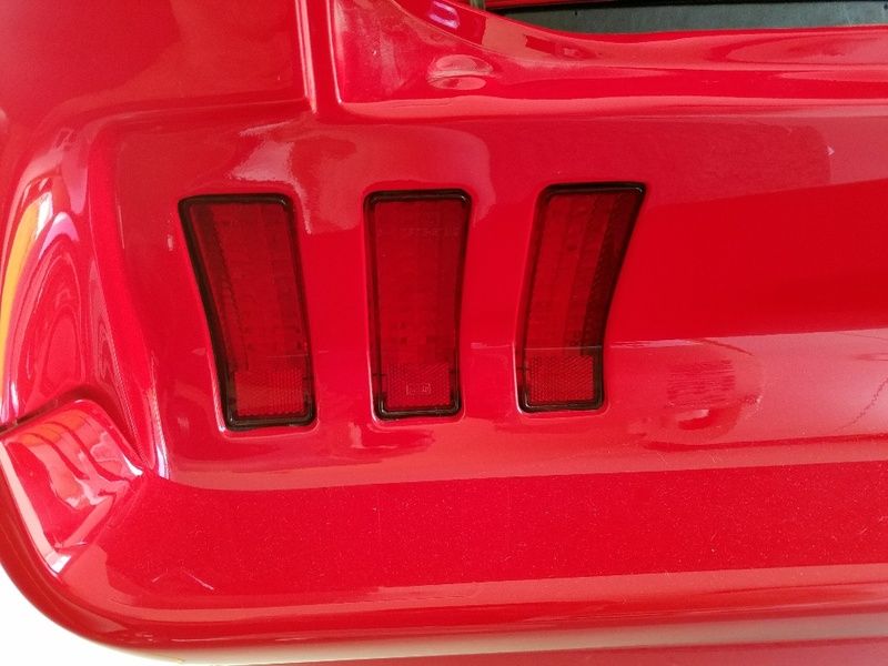

I ordered a set of Vintage LEDs taillights
