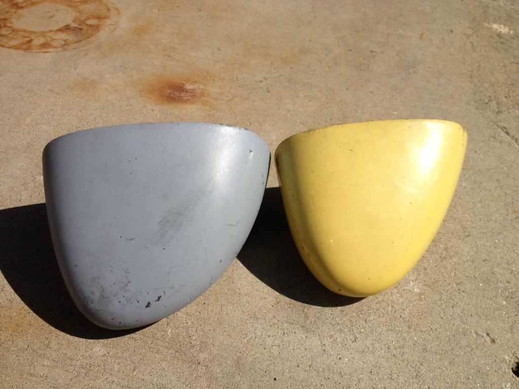

done with my boys project. more work than anticipated and I will still be making a HURST shifter pull handle. the bat is just temporary also working or rear defuser not final
getting back to 69 , hoping to put in a few weeks worth of work.
working on mirrors had two pairs. yellow ones have a smaller mirror housing and mirror sits flush to it which i like but had taller mounting stems than others as you can see. will be using the shorter one to get mirrors tucked in as close as possible.
in order to swap base / stem. remote had to be cut and that just opened a can of warms. everything just fell apart as it held on by the tension on the remote. in order to make it manual swivel type for driver side.I hacked up a passenger side mirror to use it's swivel but being that it was a passenger side made it difficult. after a few hours of trial and error and some fine tuning it got done. very happy with solid and crisp the mirror motion.
looking to recess them into door for final level.
