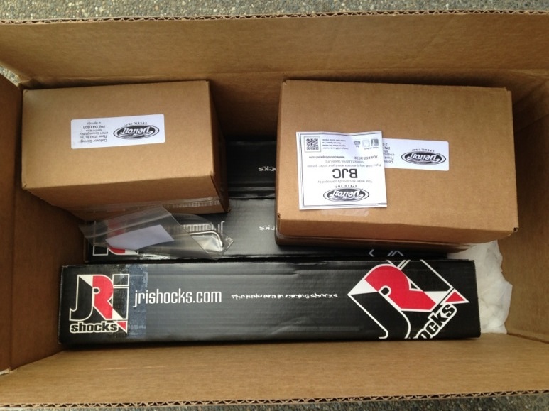

I switched from ridetech to DSE JRi coilovers. The JRi's showed up the other day and fit right in the car. After looking over both brands they both do a great job on fit and finish. I can't say one is better than the other. Just a little different design.

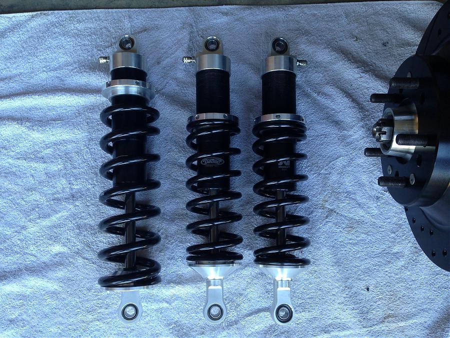

JRi test fit in the car.

DSE sent me the coilovers for the speed kit front and quadralink rear. The rear springs are shorter and lighter weight rating. The rear coilovers are also a little different design with a bump stop on the shock shaft and a snap ring lock for the bottom spring holder. The fronts have a heavy duty o-ring instead of a snap ring. I also like the drilled rather than notch style spanner nut. It seems like it will look nice longer and not scratch as easily or get banged up from adjustments.

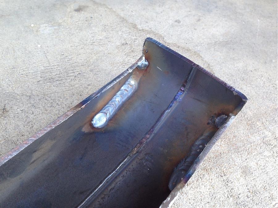

I started work on the support between both cross members on the subframe. I started with 2x3 rectangular tubing but it looked too massive so I cut the top off and tapered the front. My plan is for the angle to meet up right at the edge of the front cross member.
