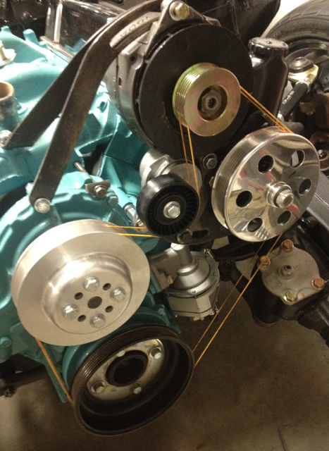

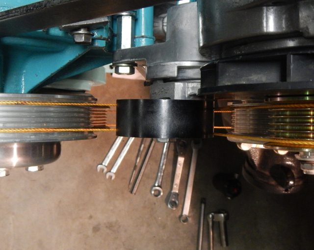

recently made some progress getting the serpentine accessory drive assembled.
Size:  328.7 KB Name:  assembly2.jpg
the tensioner was pulled off a shelf at my local NAPA parts store.
getting everything to line up properly didn't happen without a little cutting and grinding.

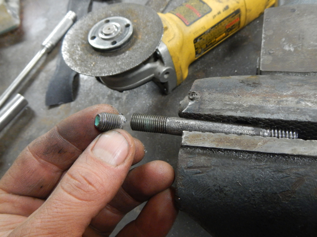

the threaded stud at timing cover was shortened 0.75" then a 1.00" long coupling nut threaded onto it allowed thru-bolt for the lower mounting point of tensioner.

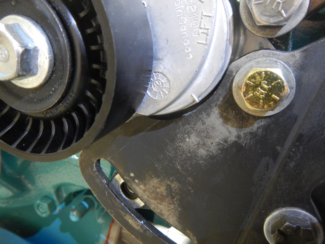

upper mounting point of tensioner at upper power steering bracket thru-bolt.
at this location i had to push the tensioner back into the alternator bracket to line up with the other pulleys.

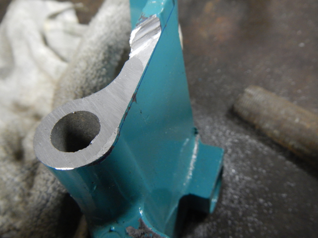

underside of lower alternator mount needed to be slotted to align mounting points.

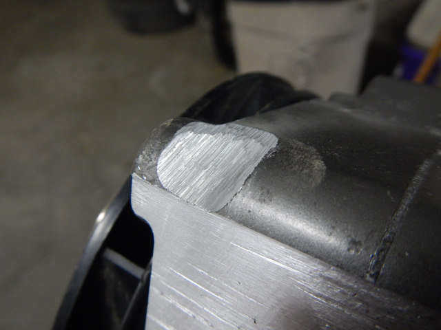

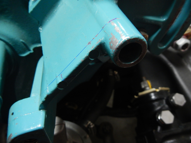

power steering bracket was shaved to fit tensioner housing.

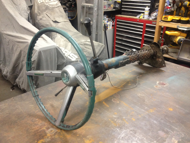

it seems like i can spiff-up the steering column with replacement bearings, bushings, etc. from inline tube and ames.
i'll just remove the column shift handle, clean it all up, replace worn or un-useable equipment as necessary, paint it and re-install.
and yes, as you can tell from the original paint on the steering column, the stock interior color of this vehicle was turquoise. someone painted black over it before my parents got the car.

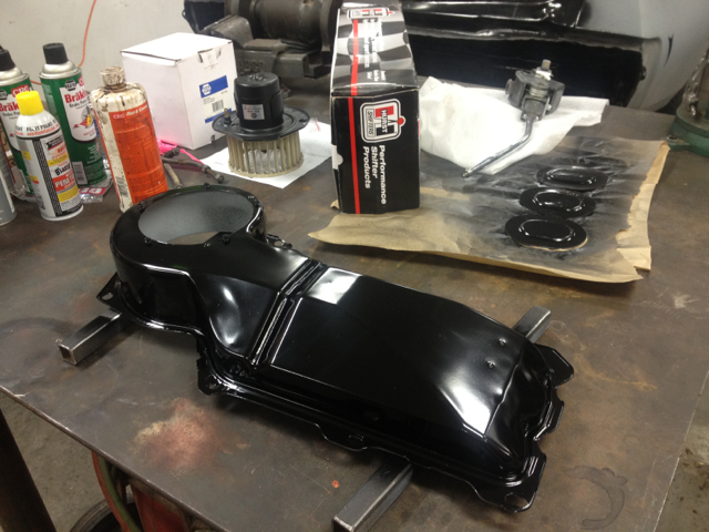

the blower motor box cleaned up pretty nice and i found a replacement blower motor in town.
the heater box which mounts to the inside of the firewall will need to be replaced because at some point my father modified it to install a larger heater core.

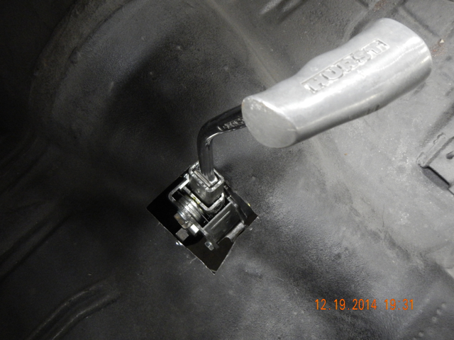

i knew i was going to have to cut a hole in the floor at some point... and the other day i finally got down to figuring it out.
also, i got all the shifting rods and the speedo cable installed with no major headaches.
from here i plan to order a shifter porch, console mounting bracket kit and console kit from ames/inline tube/opgi/etc.

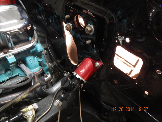

thankfully the firewall was equipped for stock clutch linkage so i plan to mount the mcleod/wilwood clutch master cylinder at this location.

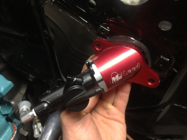

starting to get a better idea of what it will take to get the clutch master cylinder in place.
with the arrangement shown in the photograph the rod lines up with the pivot on the pedal very well, but i needed to cut a hole in the firewall to make it work.

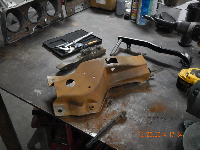

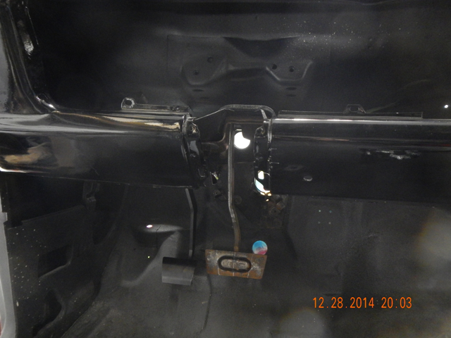

got the pedals hanging for a look at what i need to do there.
of course the brake pedal is for automatic transmission application.
i would like to use a replacement from manual transmission application, so i'm looking around online for one.

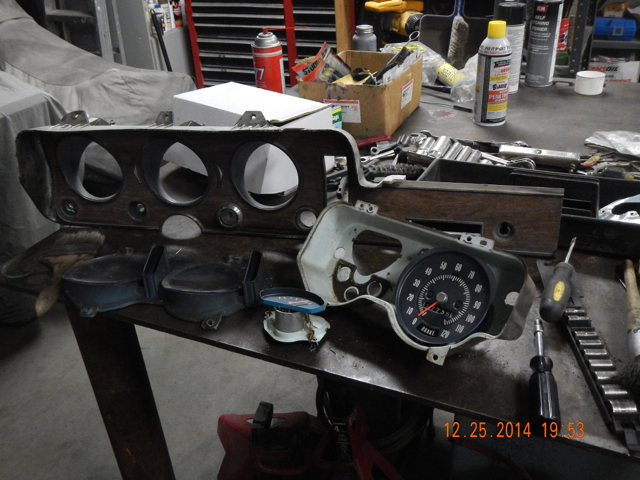

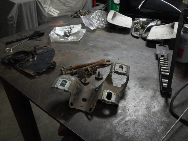

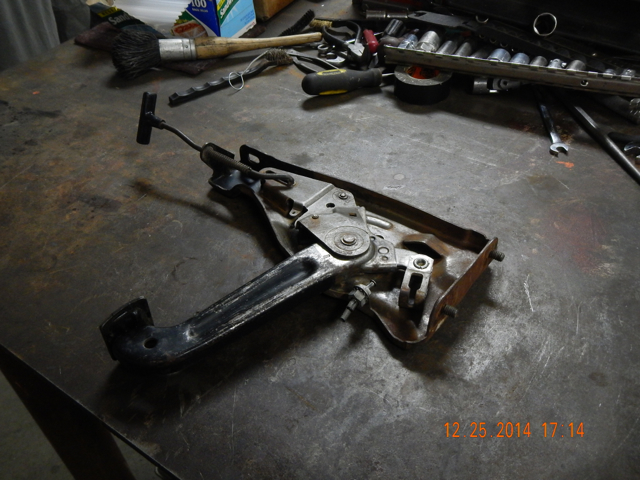

and lots of detailing...
