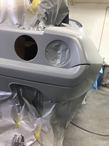

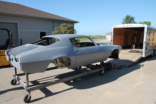

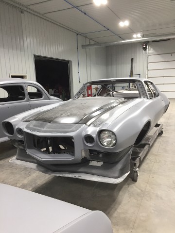

I should have explained better when the pics I posted were taken!! I received the Fesler glass in late November IIRC. I had the exhaust, brake and fuel lines done by the time the glass showed up. I got the IIMuch vents mounted and plumbed, and some other miscellaneous stuff done and the car went back to the body shop in early Feb. Also decided I didn't like the cowl area and stole an idea from John (Goosesdad)!! Thanks buddy!
Much better!!
The guy that was doing all of the carbon fiber fitting and glass work had a serious medical issue and missed a few months of work.
Random shots from the body shop mid summer
Then the shop moved into a new building first part of August.
Steve

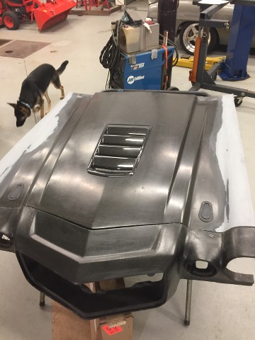

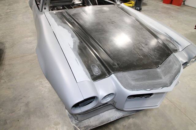

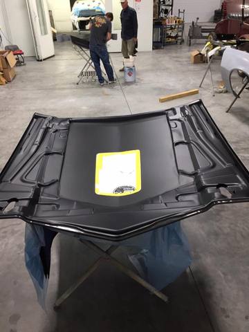

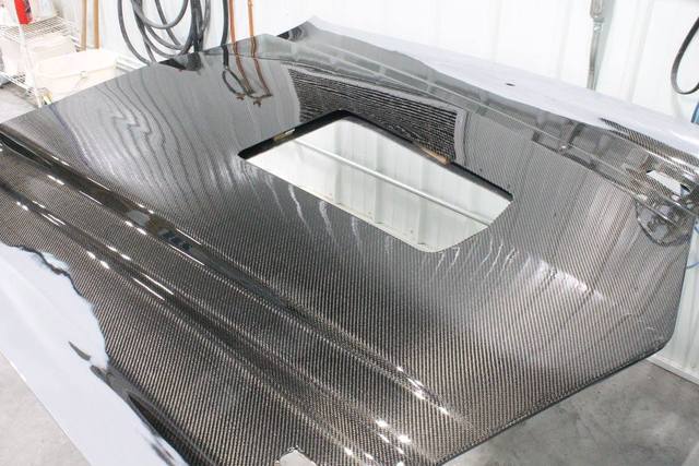

I'd been trying to decide if I wanted to do some kind of venting in the hood. I liked the vent in the Z28 so much I bought one , got up the nerve to cut a hole in the hood we had already spent a ton of time getting to fit and.........
Made a cardboard pattern for a retainer to fasten the vent down from the underside, cut the actual piece out of 1/8 aluminum and rolled it to match the shape of the hood.

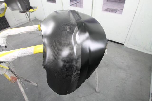

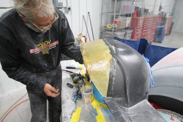

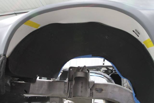

I decided I wanted to use Anvil inner fenderwells but they didn't fit the stretched fenders too well
So we cut the outer third or so off and rebuilt them with fiberglass to fit the fenders.
Cardboard backer in place
Cardboard ground away and adding more fiberglass
Finished product, painted the fiberglass areas black and then matte clear over everything.
We got some of the clear primer that Ringbrothers talked about in their carbon fiber video series and shot the hood and nose. Works very well for filling in pinholes and wet sanding the entire surface
Here's a shot of the bottom of the hood, had a lot of work to do on the outer area so painted that black, left the center carbon and then matte clear again over all of it

cutting up a carbon hood ..... big balls ..hats off to you. I tossed around the idea . My balls aren't that big lol
I had the pattern for the cutout made and taped to the hood and was still trying to decide if I had the guts (or the balls, lol) to do it. My boys were saying they weren't sure and then I sent pics to Randy Johnson (D&Z Customs). In his words "Just do it, it's only carbon fiber"
