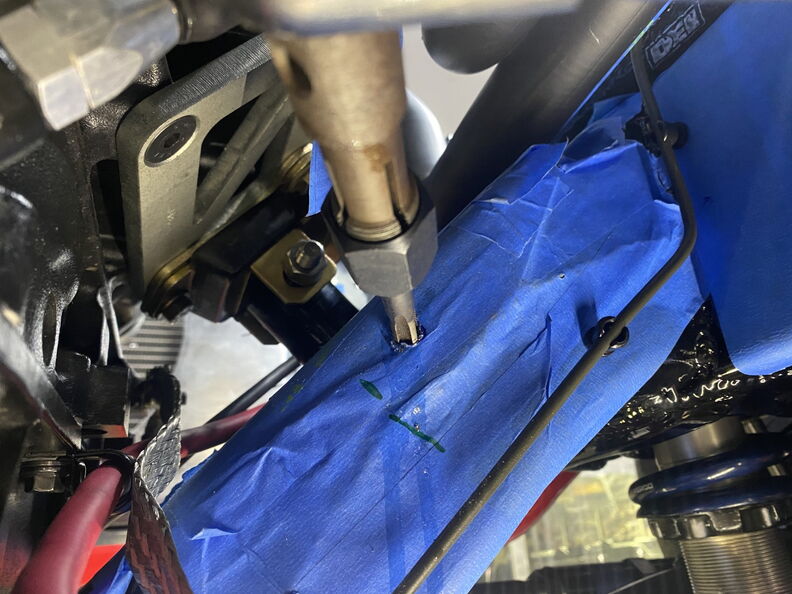

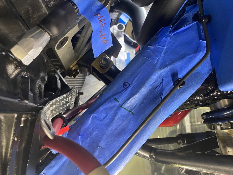

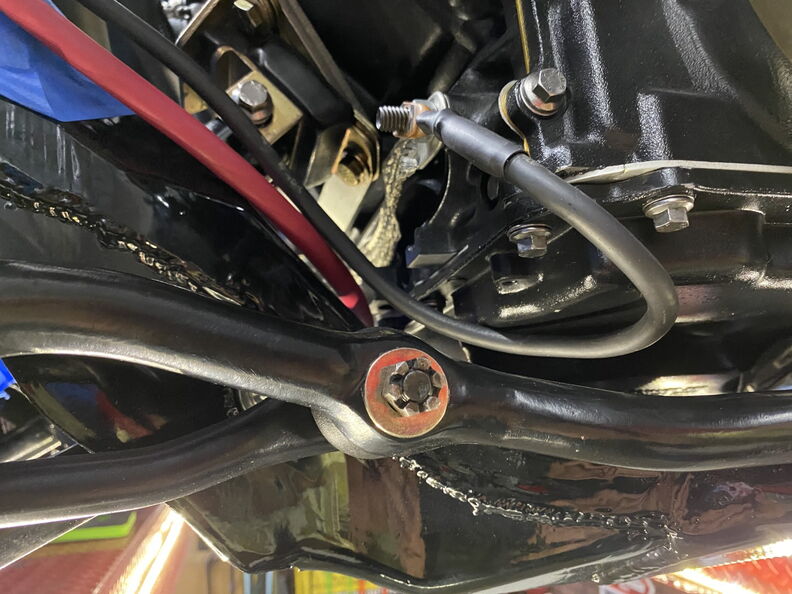

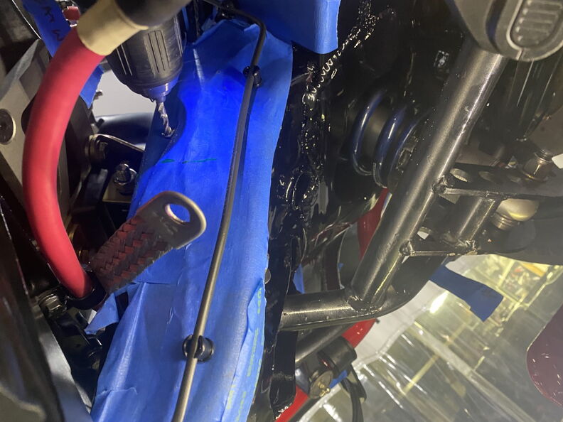

So my goal is to have really good grounds throughout the chassis and the body. After spending sometime watch HP Performance wiring video's I am going to take what I have learned and apply it to the car.

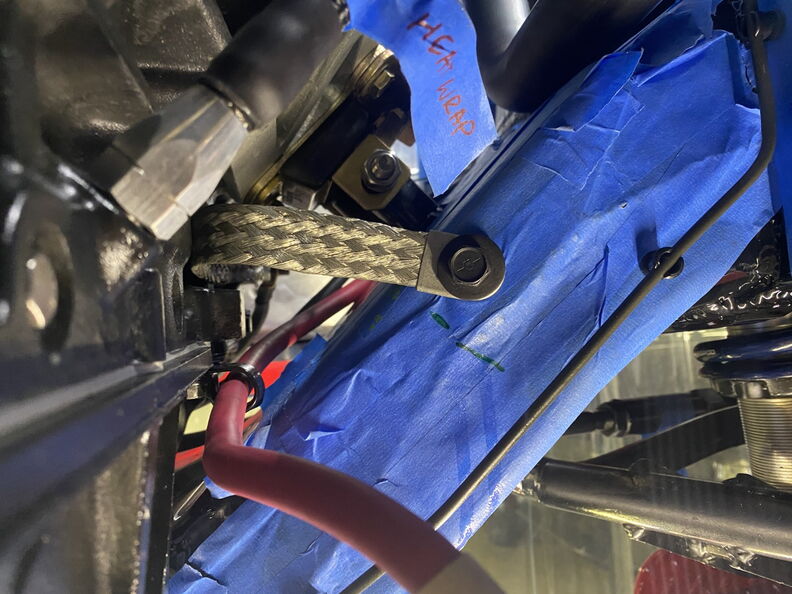

The Ground from the battery runs directly to the stud on the block and I have added a ground strap that goes from the stud to the subframe.
Of course all the tools came out for this little project.
Thankfully the drill fit in the gap perfectly.
I used plenty of oil while I was tapping the hole as the last thing I want to do is figure out how to get out a broken tap.

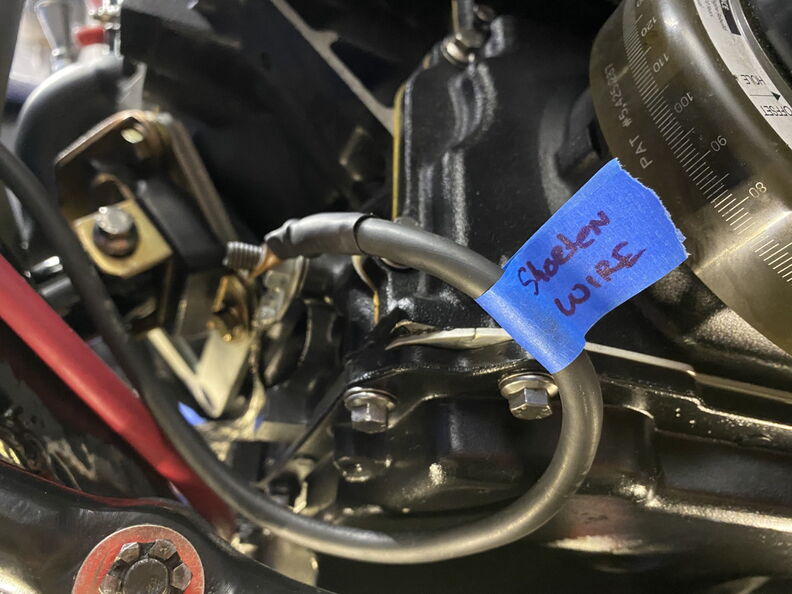

Once all of the wiring is complete I will remove the tape and remove a little bit of the powder coating under the ground strap. I will also change the bolt that is holding the ground strap.

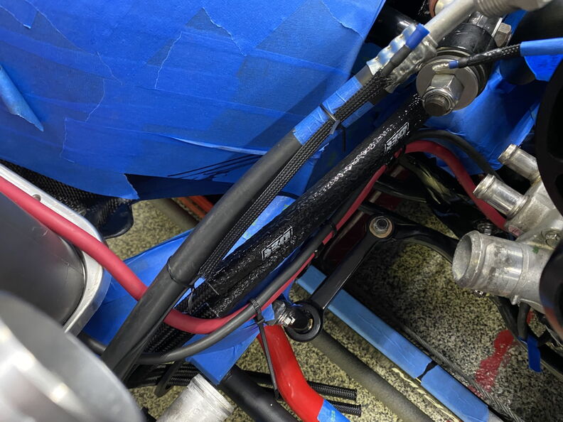

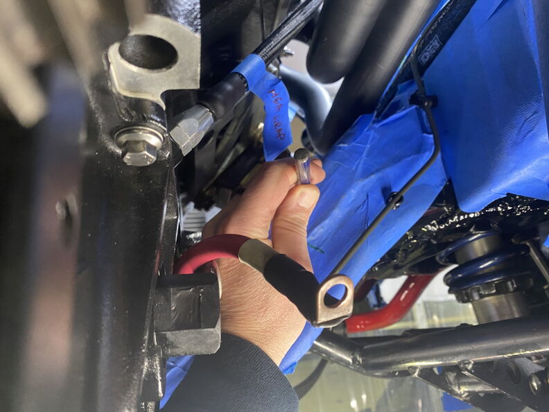

Mocking up how the ground wire will run back to the battery.

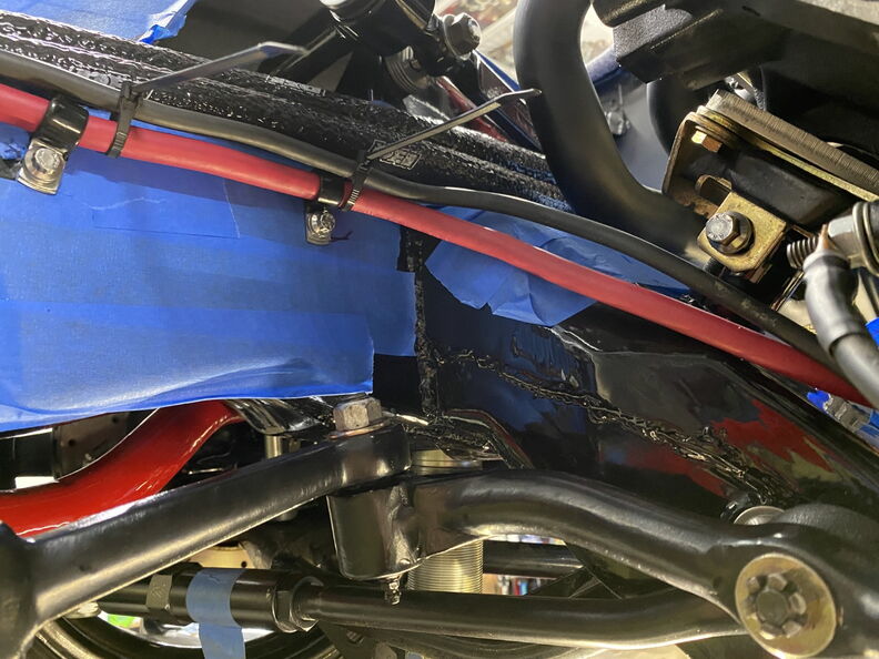

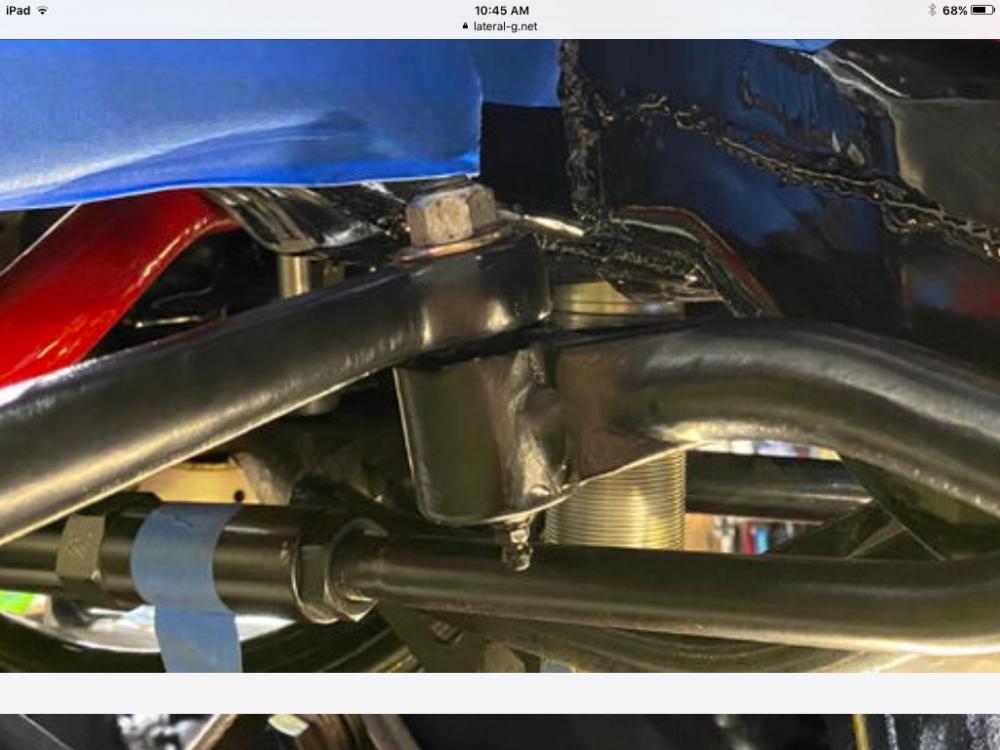

Marty......please tell us that's NOT A WELD on your tie rod center link!!!
Nope it’s a Moog Center Link. I’ll have to look to see what the reflection is that picture.

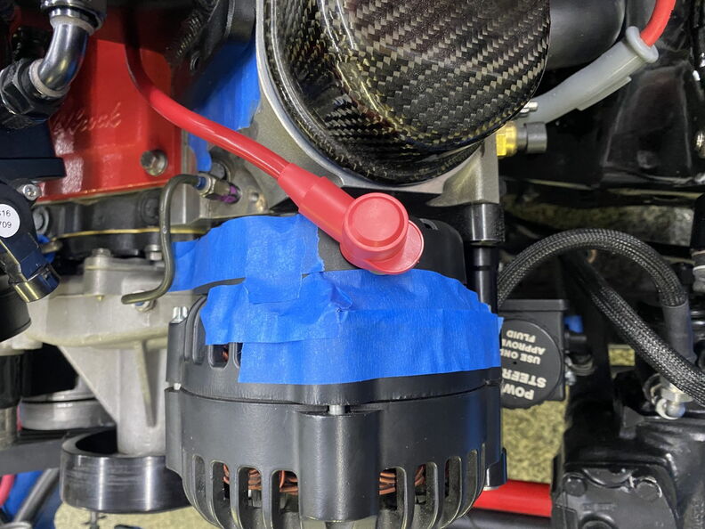

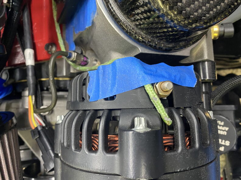

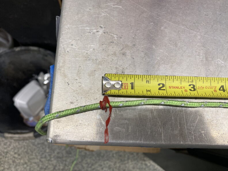

Today's project is making a new wire to the Alternator.

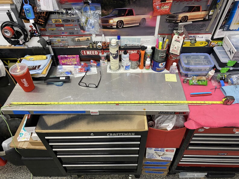

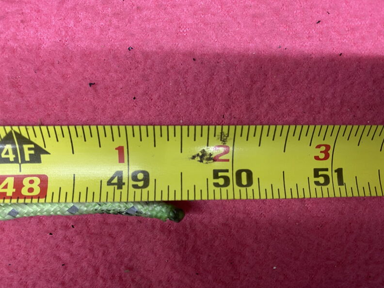

I love the string method as you can lay out and get an almost exact length you will need when you cut your wire.

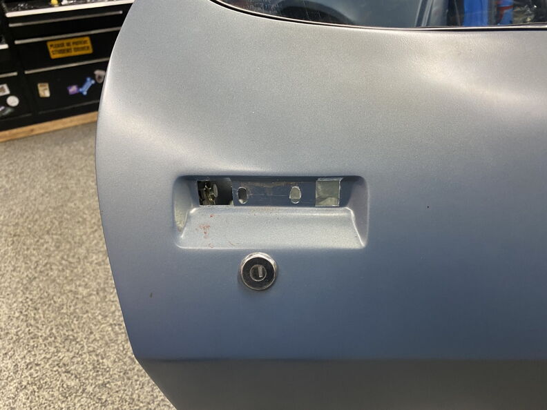

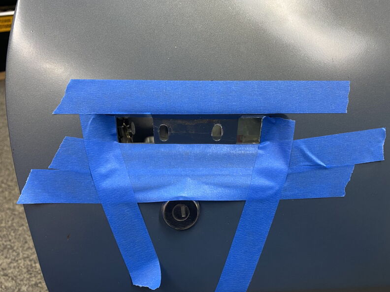

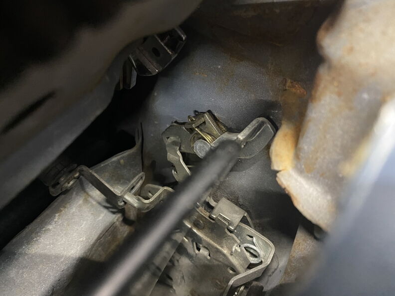

So this is one of those "sure why not now" irritating moments. Yep, the rod fell off the door handle again. Ugh !!!
This will make me feel better.
How could I have used all of these tools ??
All better now and door handle is back on.
Back to the Alternator.
