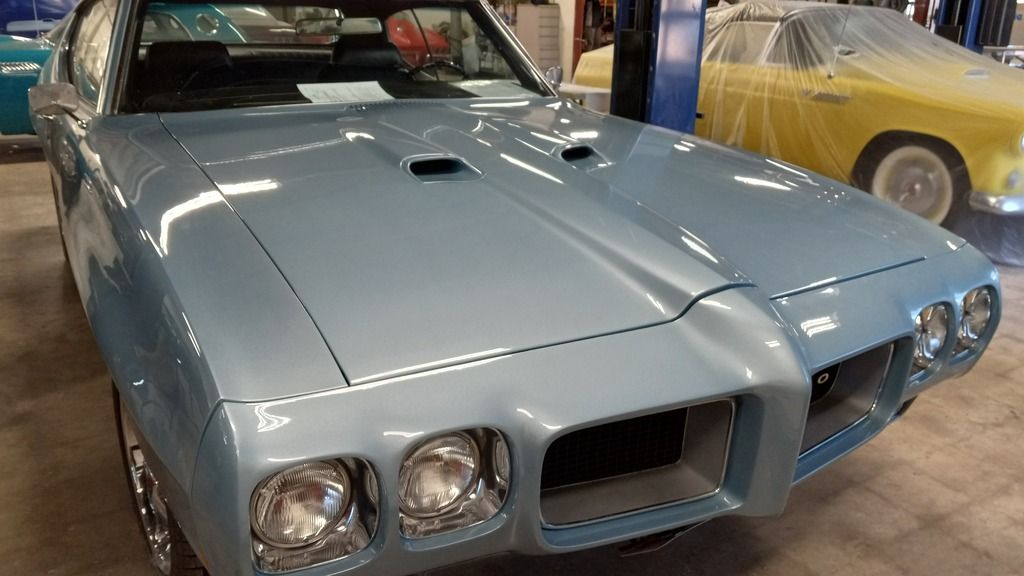

Right now I'm lead on a 1970 GTO ... repair and repaint the endura bumper, fit a Dynacorn hood with a functional cowl induction system and align the front end sheet metal. Pretty blue paint but lip stick on a pig is still a PIG!!!!

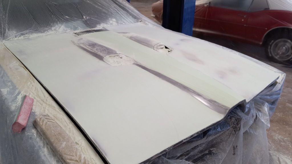

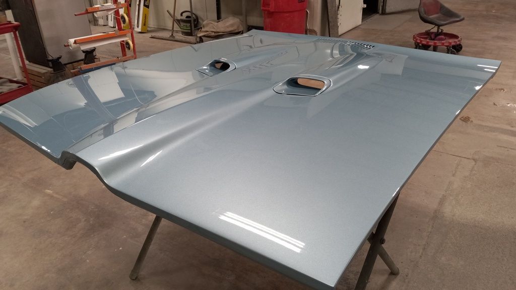

Here's an update in no particular order .... some work pictures, the GTO Dynacorn pos hood made 'mo better, endura bumper cracks fixed and blended the fenders and cleared, wet sanded and buffed to perfection.

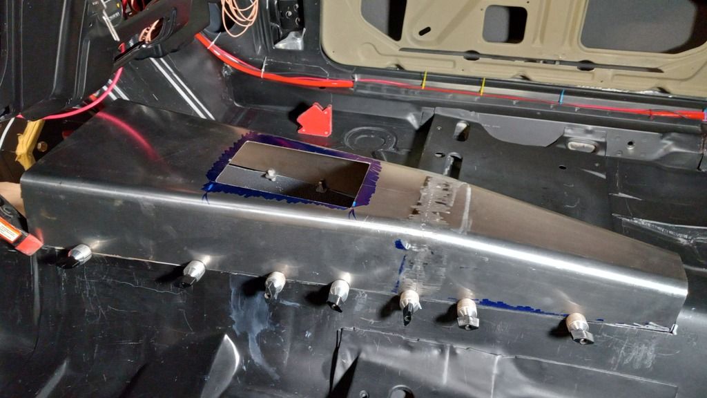

My Camaro ... working on the tunnel still. Bought a Bowler T56 tunnel cap and been fitting it to my car ... it's close, measure 12 times and cut 2 times. SO, I have it real close but not happy with the width of the front so I'll use the break at work to match the width of the car.
Oh, and the transmission mount that came in the kit was not the correct one ... seems I needed a reduced height mount to lower the tail shaft and get my 2.5 degrees and keep the headers from hitting the floor pan, lol.
Mo better!
Ok, back to the tunnel cap ...
Pull the engine and tranny again ...
Measured a dozen times and cut twice ... she's close, giving about .75 inch clearance on the transmission. I need to decrease the angle of the sides to get closer to 12" in the front to align better w the car. Then do an angle cut and weld the back to slope into the back.

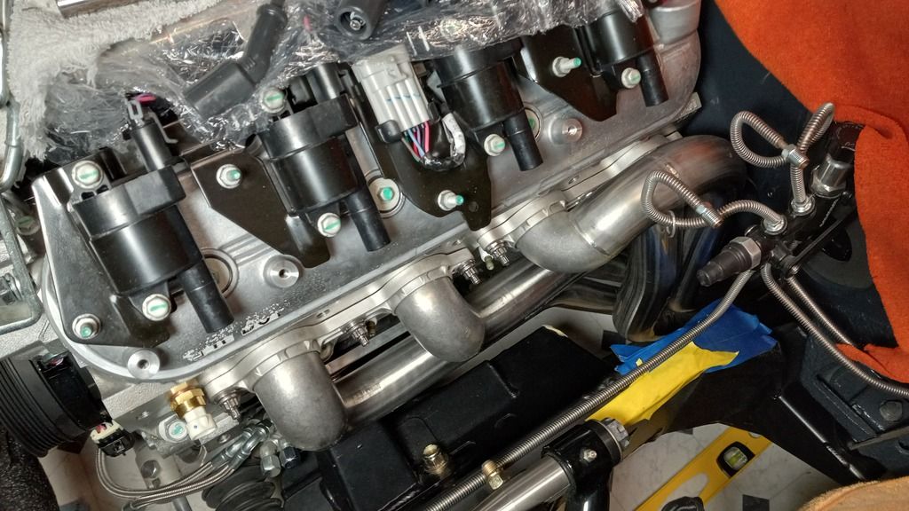

ARP head studs are the cat's pajamas!

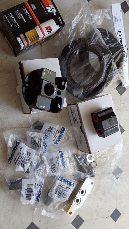

Started collecting some oiling system parts. Improved Racing's 205 thermostat, remote filter and the plumbing. Need to decide on the cooler soon!

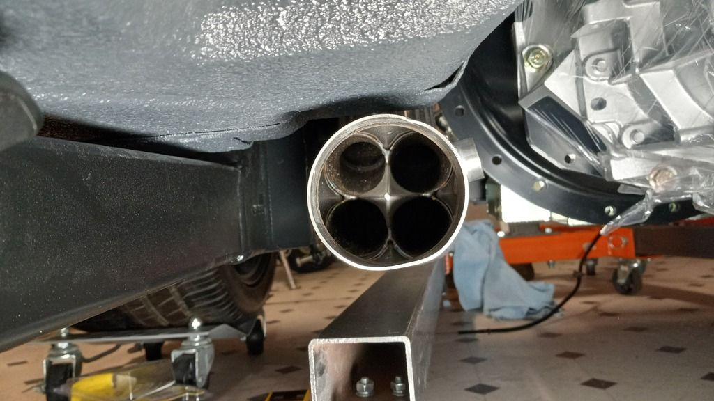

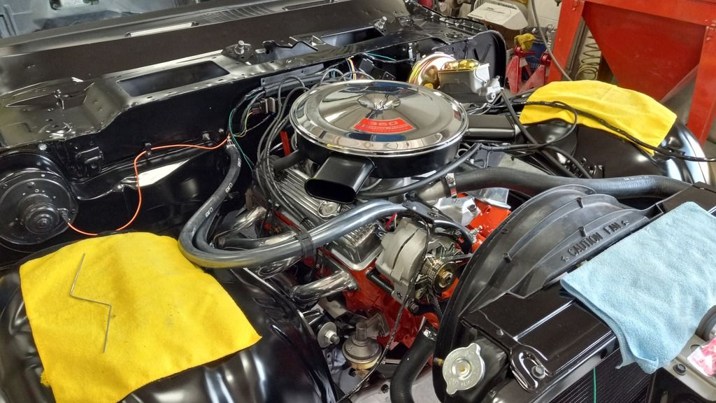

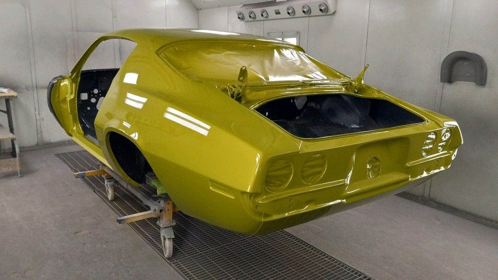

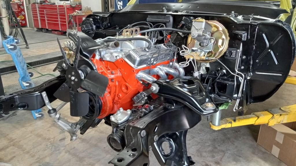

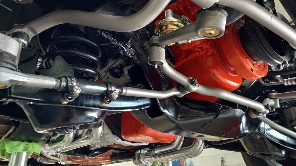

Been on the 71 Z28 for awhile now, plumbing, electrical, brakes, suspension, transmission, and what ever else she needs. The car was painted on April 19 and this is update ... working on the exhaust system this past week!!

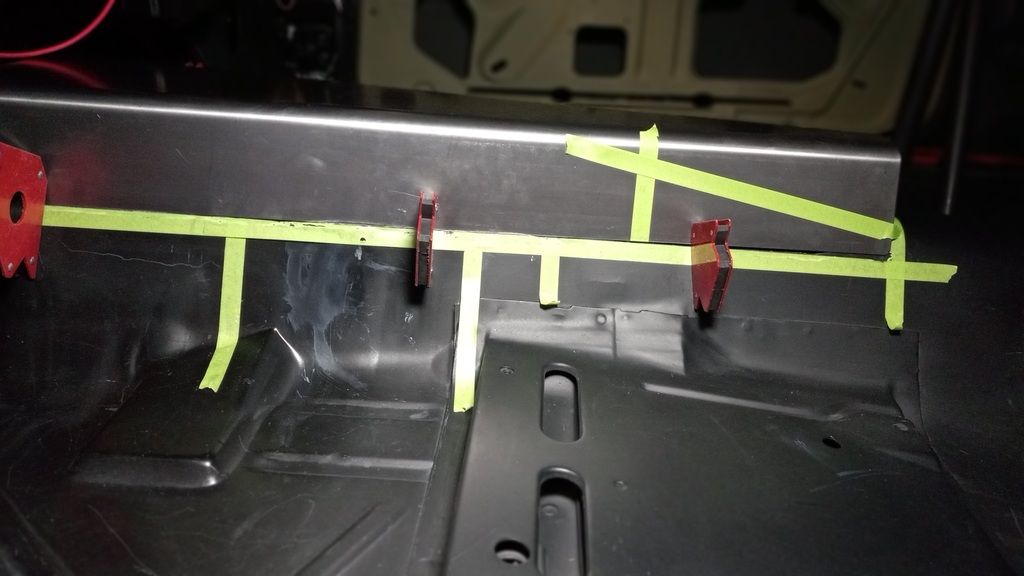

Now my Camaro ... cut up the Bowler trans tunnel and welded back with an angle of the dangle to meet up with the back of the tunnel w/o making a center console. Of course there is an access hole cut for future maintenance should the shifter plate need attention
Couple hours later....
Working on the transition to the firewall section but one day at a time ... thanks for looking!!!
