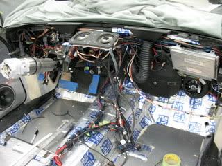

We stripped it apart

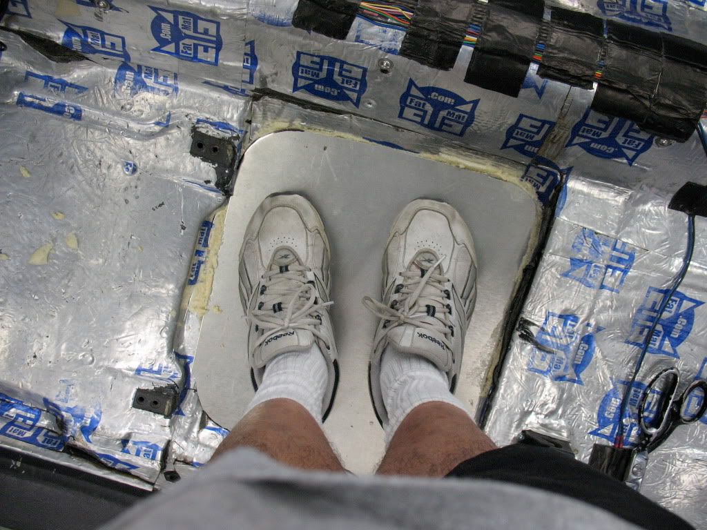

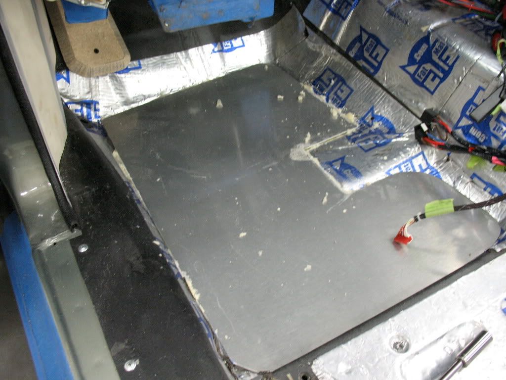

flatten out the floors,And no you won't even lose room.... 1/2 inch at most, Makes the carpet lay flat without bumps, I use pour foam to seal and fill the voids then we dynamat over aluminum blocks heat and sound, I will load more pics of that step later

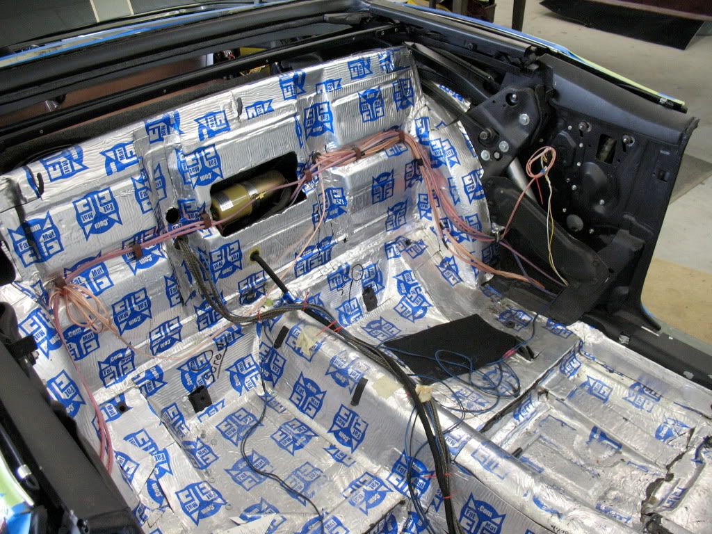

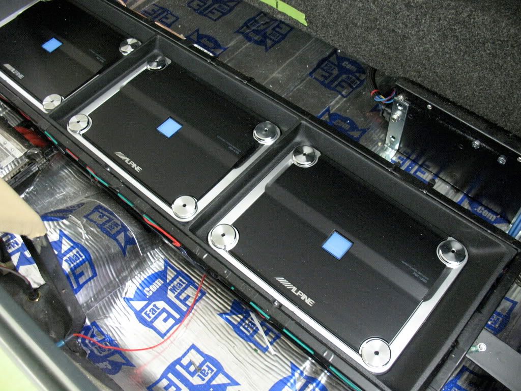

Trunk area, You can never have enuf sound
I am loading more detail pics later and will start showing the pretty pics when I get them in order
