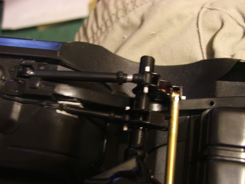

Well a small little update for tonight. Only one picture, but its taken me about 3 hours worth of work to get this one little part done. I've got the passenger side lower 4 link arm done. Well its mocked up. Teh part that mounts to the housing is done. And, as I type this I realize that I've made a mistake. The adjustable end should go on the housing side, and the stationary end goes on the chassis side of things. Well looks like thats going to require some correction. Anyway, this is the way all 4 4-link arms will look. The uppers will be shorter. They are constructed of brass, aluminum, and styrene. Painted flat black, followed by testors dull cote, and finished off with machined aluminum bolt heads and nuts from Hiroboy.

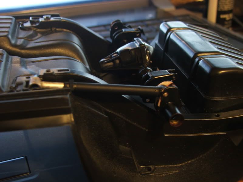

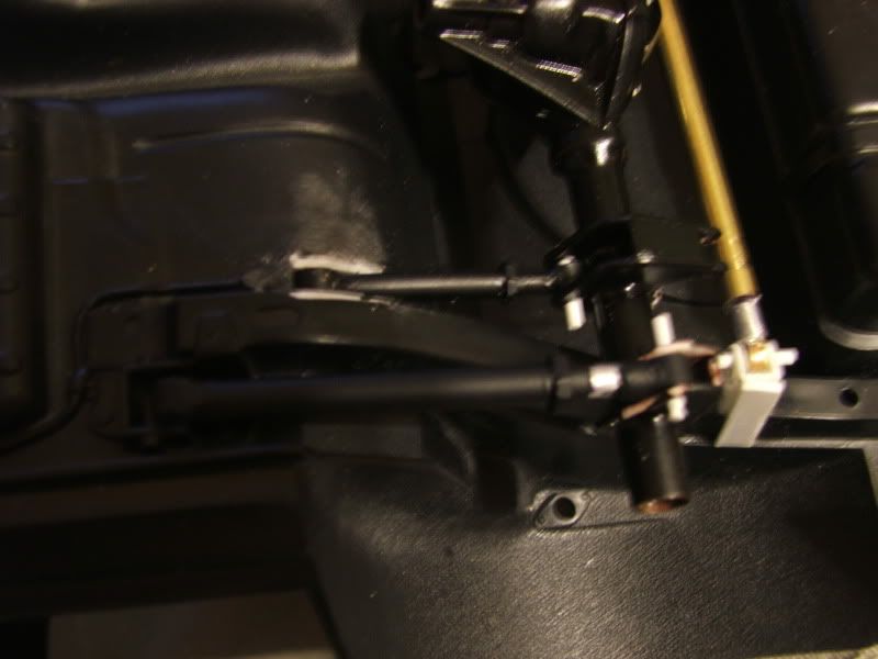

Got some major work done on this guy. The rear 4-link is pretty well finished up as far as fab work. I may have to break apart the inner bars and adjust them a little bit, it looks as though the pinion angle is going to be a bit out of whack. I'm still unsure as to how I'm going to secure the outer bars as everything else is drilled and pinned with styrene rod so that it will actually articulate. There may be enough for me to build a box to attach them with and insert it into the front leaf spring mounts after everything is detailed. the only thing not painted as far as the 4-link goes is the panhard bar. It may need some adjustments as it looks as though right now it may be in the way of the coil overs. They aren't complete yet so I haven't been able to check. Enjoy...

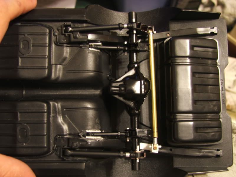

Just a quick photo update. I cut some styrene circles to help me mock up the rear end and get the lengths fo rthe 4-link set correctly. I also used these to get an idea of what this beast is going to look like at ride height. I noticed that I'm going to have to re-work the front sub frame, yet again. The cross member that spans the length between the a-arms is hanging too low I think. There is a possibility it may be about right. I'll need to get the front suspension just about worked out to know for sure. Enjoy...
