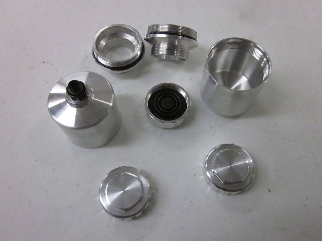

I had a PM on our reservoirs.. about how we made them.. 3 pcs reservoirs..
This pic will show the machine process & sealing of reservoirs..
Cris Gonzalez
