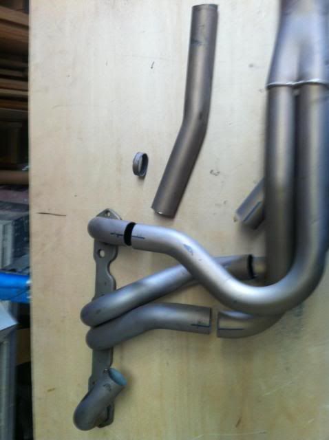

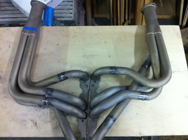

One option, as Vince can appreciate is to modify a set of headers, VS building a custom set. Some headers lend themselves well to this.
Well after smashing several set of headers, trying to find better ones, and offering to help manufacturers re-design there headers for better ground clearance, we decided to take matters into our own hands! We had a set of Hooker Super Comp headers that fit pretty well, with near equal length primaries and 1.75" tubes. The aweful Hooker ceramic coating had gone to sh*t in less than 2 years,the "Hooker" badge had fallen off, and the bottoms were now a bit flat, so we had nothing to lose. We were able to section about 3/4 out of each tube to move the collector up approx 3/4". Our goal is to get the car about 1/4" lower in ride height, and gain a little more ground clearance. For now all the tubes are fit and ready to be TIG welded, but for now they are just tacked together to test fit. We will be doing a new custom stainless exhaust to snake around our new torque arm rear suspension, trying to fit a true X pipe in about 10" of space, wish me luck!
marking the tubes
fitting everything back, and aligning the sections
both sides tacked together

there you go!
Before you put them on for good, ship em out to Doug's to be put into production.
have fun tig welding 4 & 6 LOL
