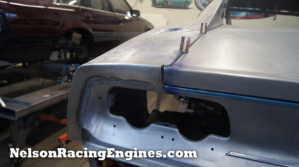

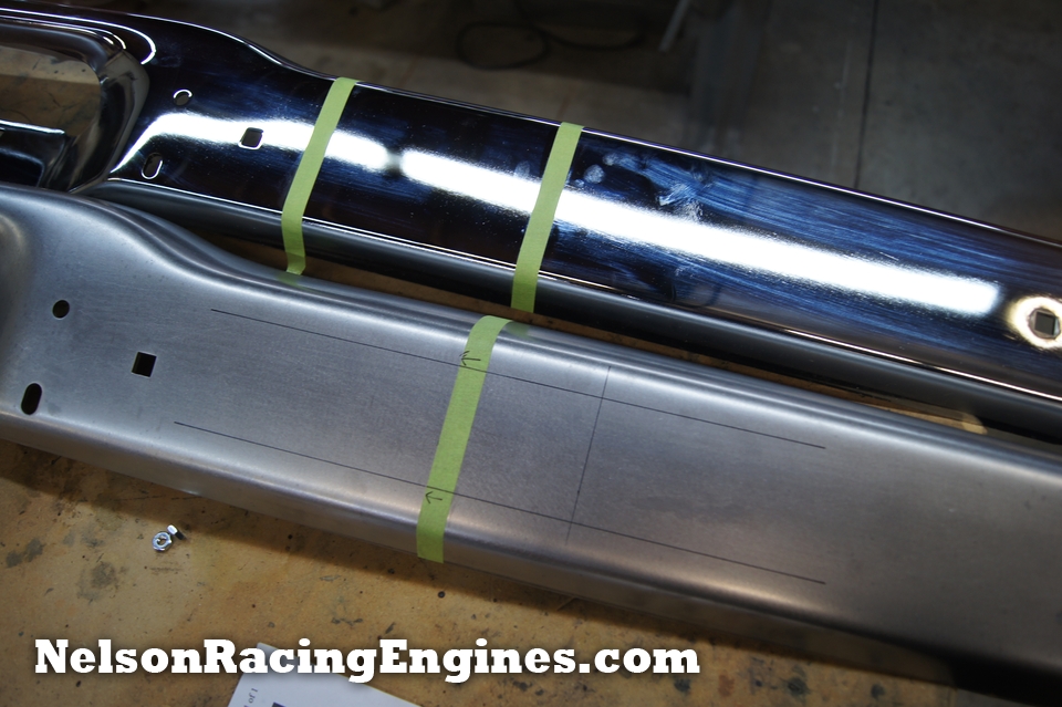

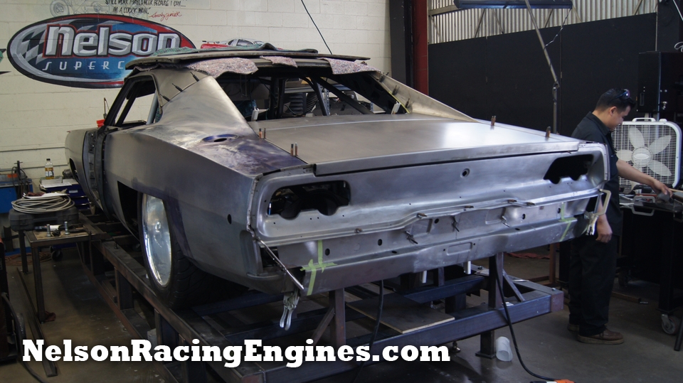

Default Maximus

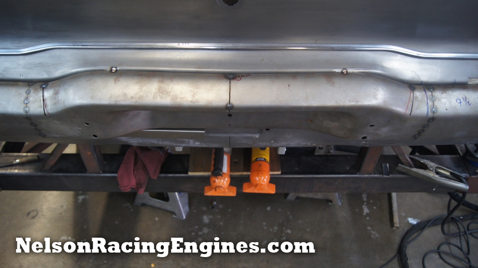

Okay ton of work of the series of these pictures

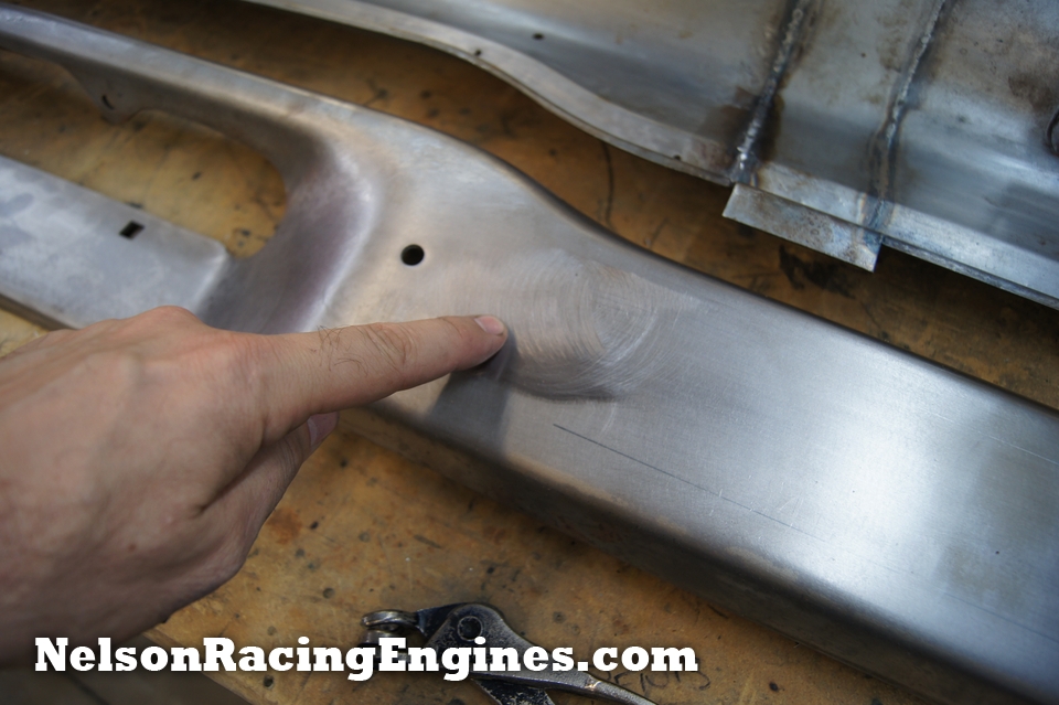

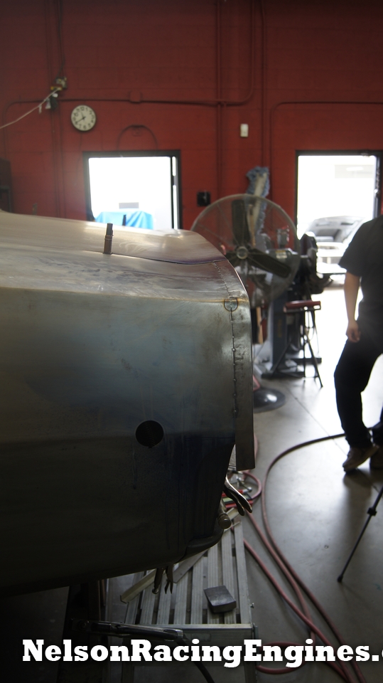

Here's some shots of the process of widening the tail and bumper we wanted the lights to be inn the same position they were originally so we added to the center.And filled the bumper bolts added studs so they mount from the back side then chopped the heck out of two bumpers two get one
We decided we did not like the way the factory bolt on tail pieces looked so we decided to make our own from scratch and graft them into the quarters so they are one piece for a really slick look

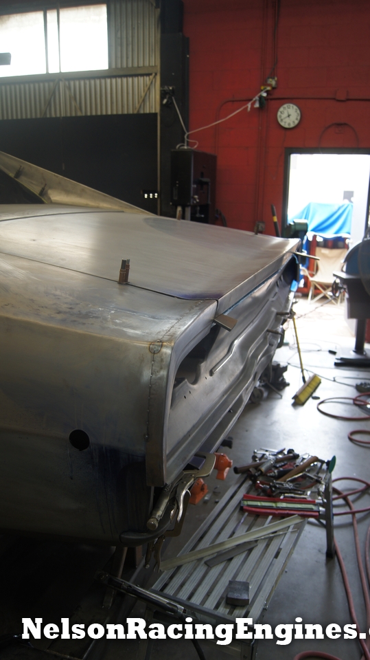

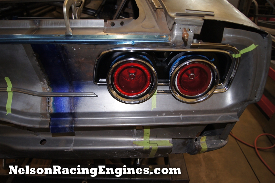

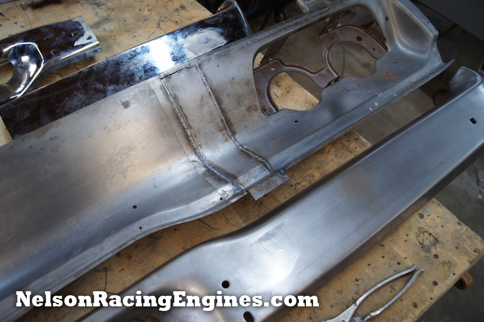

Posts: 85

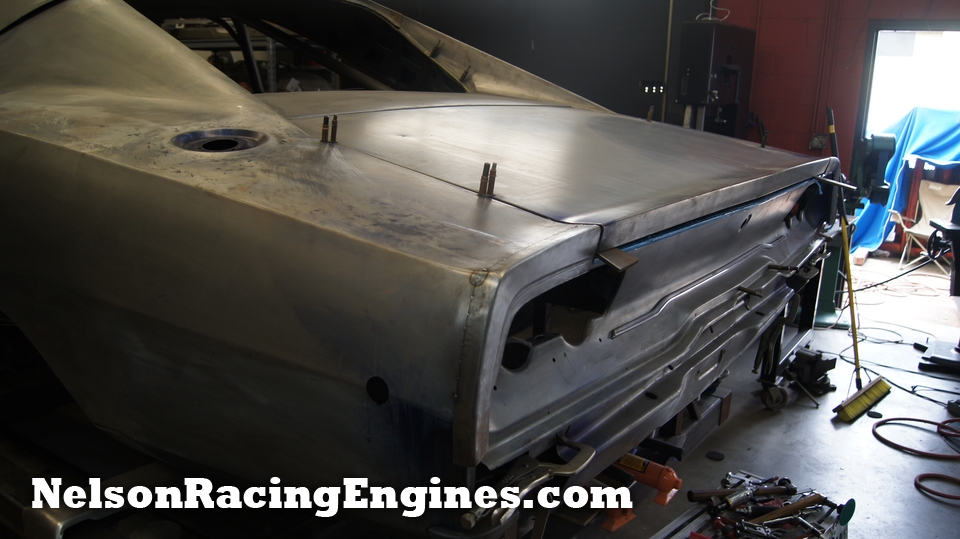

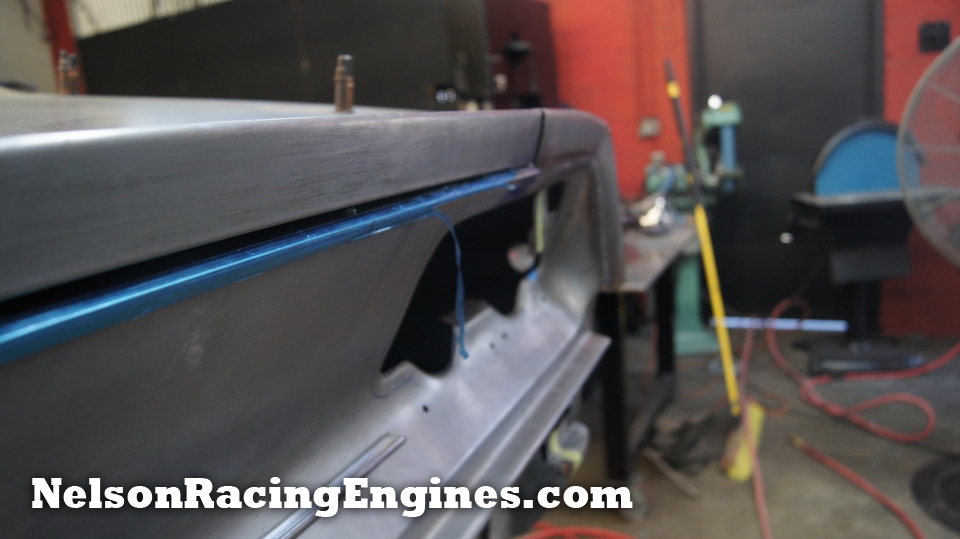

Default Maximus
Here are some more shots of the process
