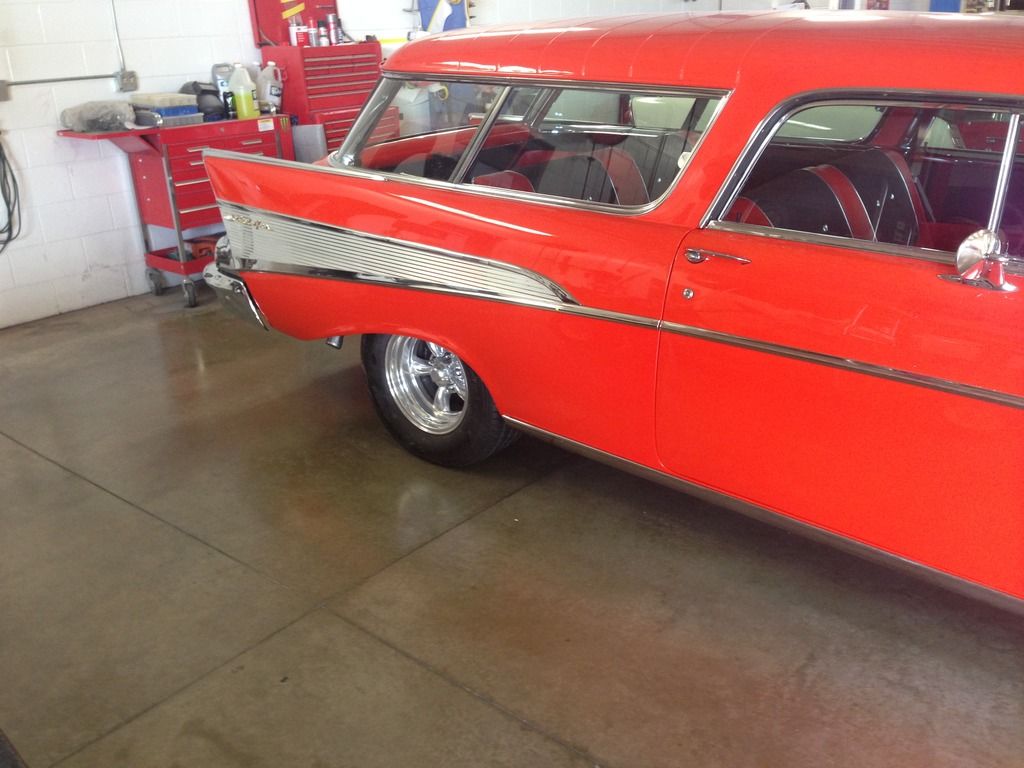

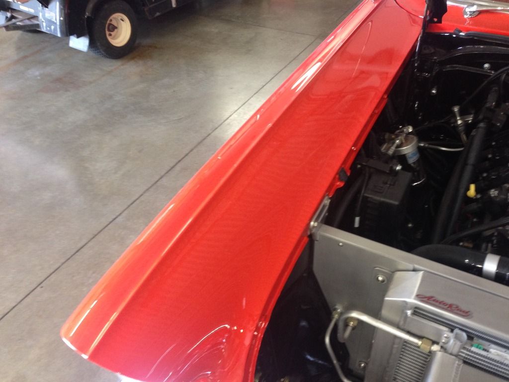

Stopped at Frame Up on the way home and in my mind I knew that the drivers side header was not going to fit............we had talked about cutting , welding, and recoating.......LOL.........both sides were installed when I got there, just some slight dimpling was all that was required.......Should be finished tomorrow.......LOL......By the way.........the Headers came from Speedway ....................
Drivers side
Passenger side............
