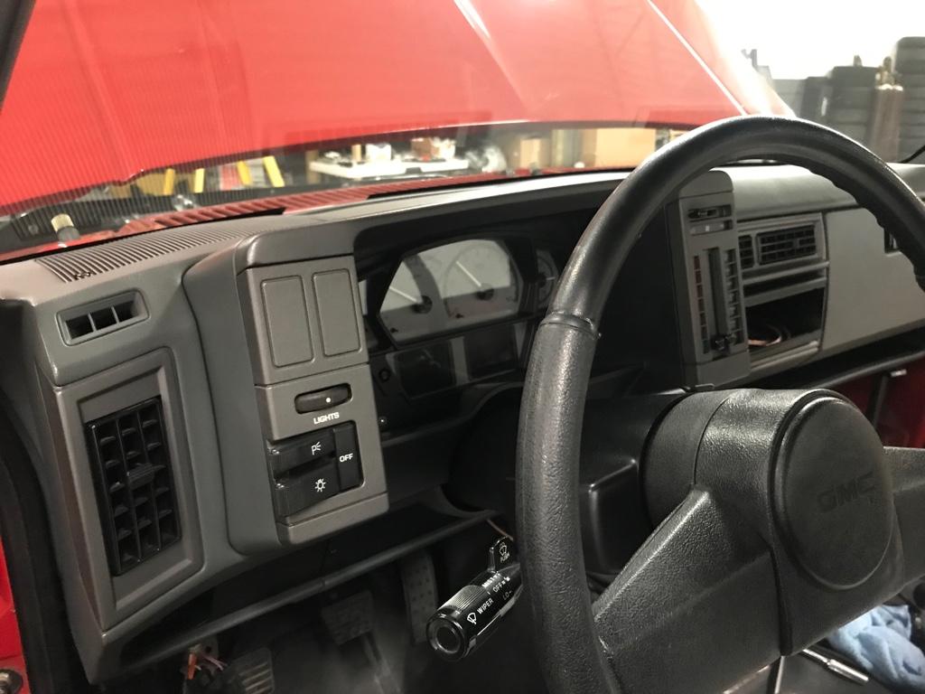

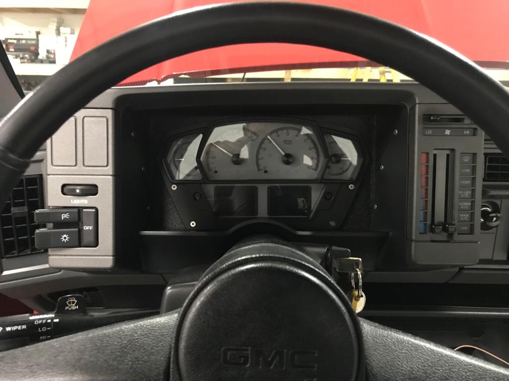

Originally Posted by choffert1 View Post
That looks awesome!
Do you have more pics on how you made that cluster fit in the s10 dash? I really like that idea. I have been looking for options for my Syclone.
From Matt.
The plastic was shaved down on the backside for clearance. The top flange was shaved down on the billet face plate to shorten it up and the center lower on the bullet piece was notched to clear the column
