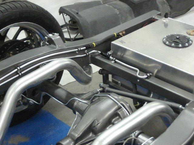

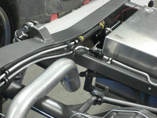

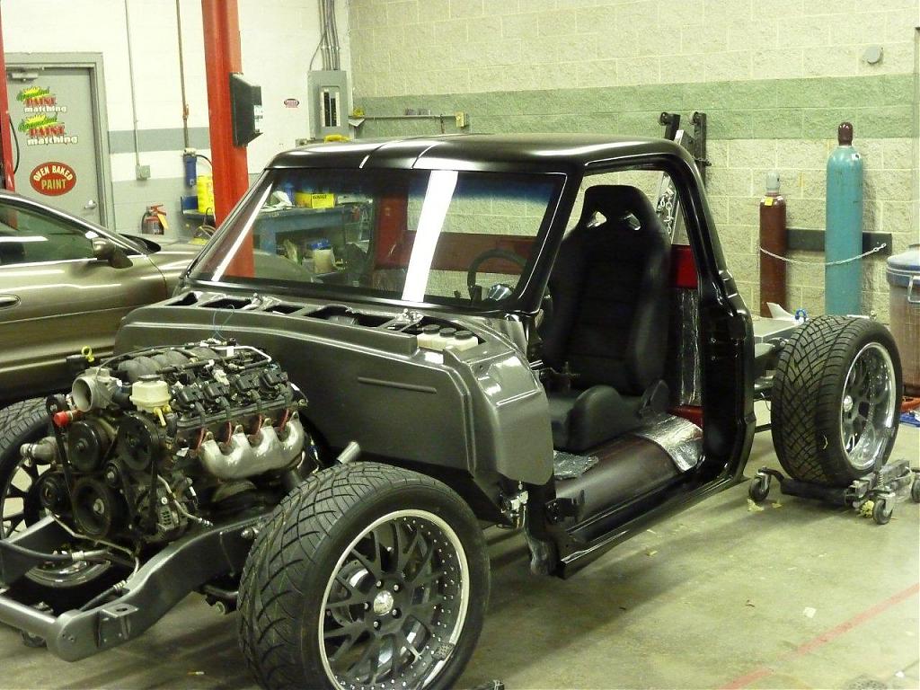

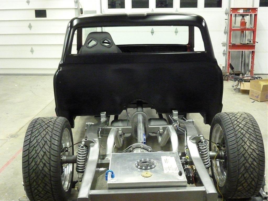

few update pics, ive got the brake lines all done on the chassis & the fuel system done to the reg/filter.im waiting for my goodies from street & perf to wrap up the chassis. im planning on getting it running with no body on. thanks for checking in & thanks for the complements. bill

Nice job, I like the hardlines everywhere.

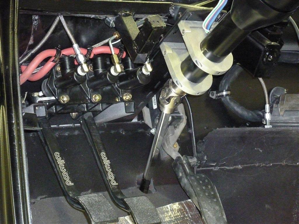

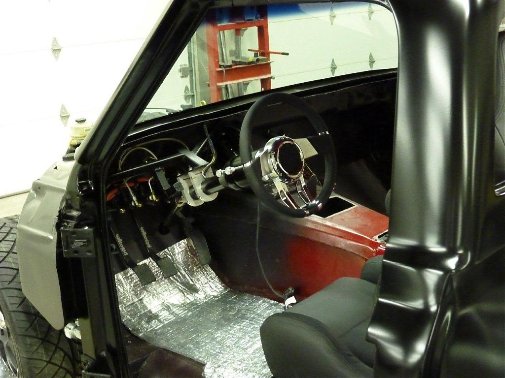

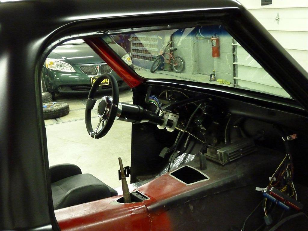

few up date pics, plumbing almost done. brakes are blead,fuel sys sealed up ,stearing hooked up. starting to look like a truck. thanks for checking in bill

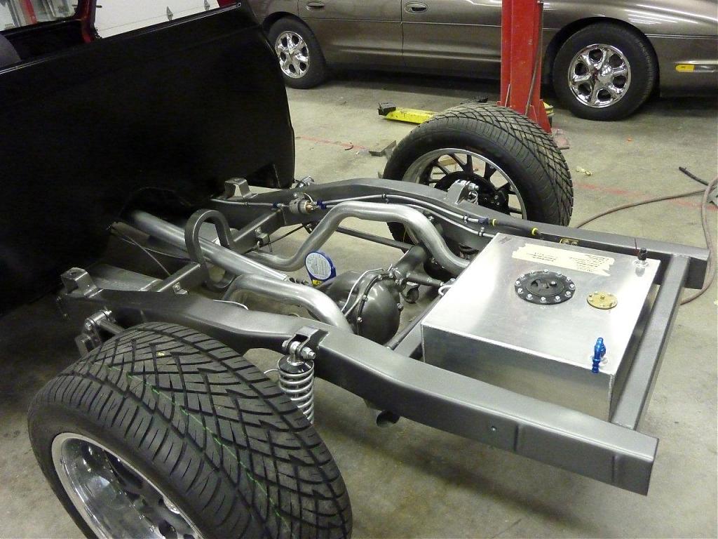

The only thing i see is the fuel cell. I have seen those tabs rip off. I have the same style cell in a project im doing and i built a cage for it to sit on. That way the weight of the cell isnt hanging off those tabs.
