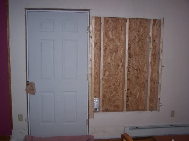

Now from in the house. I still need to insulate and blue board and get someone to skimcoat it. I also have to rewire the outlet on the left . It was connected to the one on the right. I was all set to do it but only had 14/2 and its wired with 12/2. That was a surpirse.
I just got intouch with my plumber. He will come next Monday and move the radiator which is infront of the door.
If I was you, I'd just leave it there. That way, if you get any drafts under that door when you have the garage door open, it will heat up the air before it comes into your living space

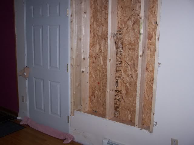

I had a little progress yesterday. The plumber came by to remove a 6' section of base board so the door into the garage could be finnished so it could open. I gave him a hand , we started at 8:30 am it was out and plumbed back in by 12:00. Then the fun began we tried to bleed the system. My water pressure is almost non existent. It took forever to fill the system. Then to bleed the air out was fun. We had to do three zones 3 times each. One zone has two kick board heaters, they held so much air it was a pain. The plumber who did the baseboard replaced the kick panel heater in the kitchen a few years ago. When he did he put ball valves on either end so we used them to finally get it bled but it was 3:30 when we finnished. Another 3 hours of extras I didn't count on. But thats how it goes. Atleast its done.
Here's where we removed the baseboard.
