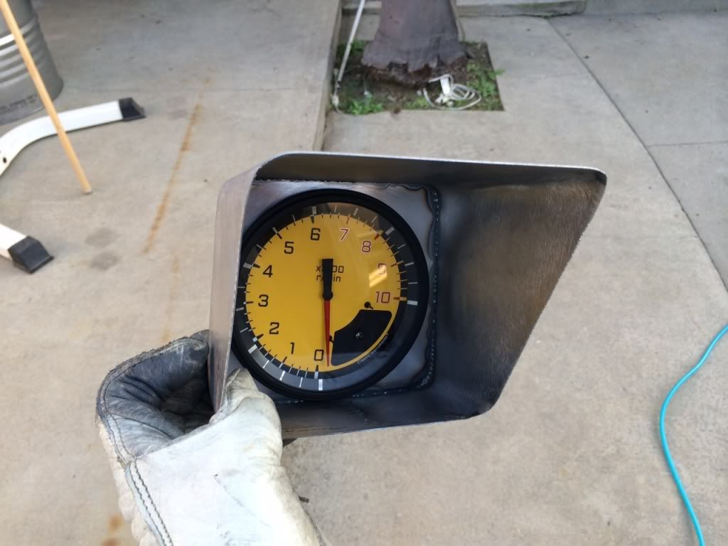

was looking to use original lens in order to keep the dummy lights and turn signals but the 5" gauge was just a tad to big. it worked but had just a bit to much point of view overlap and it would just look to stock once painted. so i went in bit of a different direction..
picture of initial plan
this is the way i'm going with it,
question….. what tool can I possibly use to get rid of weld on those inside corners ( picture please ). they are way less noticeable than in picture but would like them gone.

Posts: 726
That looks great!
As for the weld showing through like that, what about remaking the piece that the gauge actually attaches to and bending a lip on it. It would be flush on the backside and would push the gauge forward a tad unless you engineered it all with that lip from the getgo. Just a thought
  #165
Old 02-03-2014, 07:49 AM
It looks Nice. How about a Dremel tool with a stone or carbide bit in it, or you could put some all metal or bondo to round out the rear corners to match the shape of the top of the sheet metal. Either way it's going to look great.

Originally Posted by makoshark View Post
That looks great!
Both good ideas
Tx

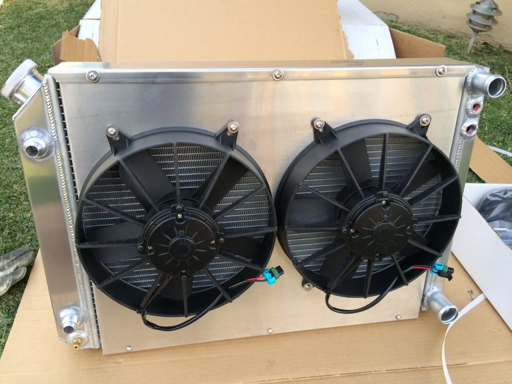

Testing iPhone pic download
So I just received this from entropy radiators

Old 02-09-2014, 05:25 PM
66fury's Avatar
66fury 66fury is offline
Join Date: Feb 2013
Posts: 238
Thanked 9 Times in 8 Posts
sexy !!!!!!!!!!!!!!
