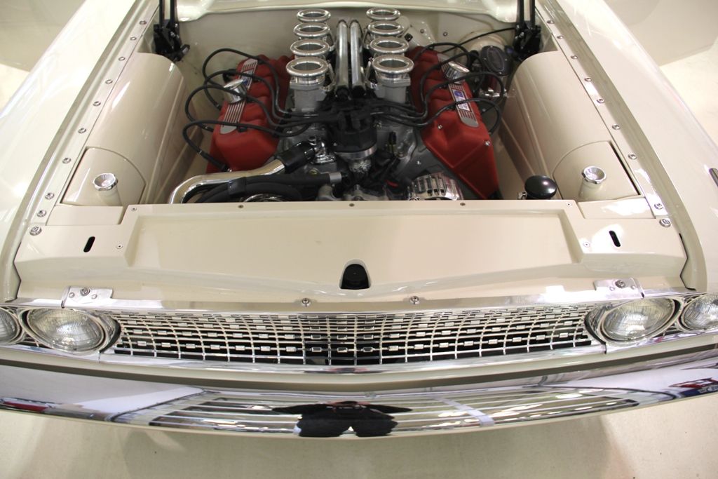

And then this showed up....
Not a Ford guy, but damn that's sexy.
HELLO!!!!
Holy Mother of the Ford Gods.....
