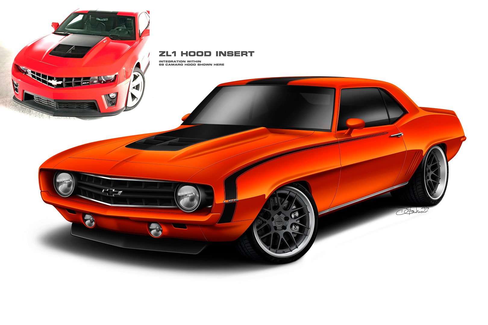

We have decided that in order to gain some more clearance between the engine and the hood we are going to make a custom cowl hood that actually accepts the same carbon fiber insert that is used on the modern ZL1.
We expect this route will also help keep things substantially cooler under the hood as well.
His new rendering shows the same custom grille he designed but uses the cowl and carbon fiber insert from a modern ZL1.
You'll notice the center hump in the middle of the stock 69 front valence panel looks a little "forced" as it transitions into the cowl.
To remedy that he softened the hump making it look right without bringing undue attention to what is going on. It should look nice and clean when done.
Since the new ZL1 hood is aluminum, we chose to fabricate a facsimile of the ZL1 cowl out of steel that would except the carbon fiber insert and then be grafted into a steel 69 cowl hood.

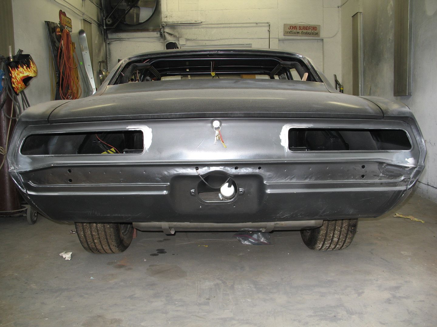

Back to the car, the final metal fabrication and gap work is underway. All the mock up, electrical and plumbing work is almost complete too.
The car should soon be going to body and paint!! We're hoping like heck we can drive it this season.

Looks really nice and I love the hood. I am not sure if you are away but ASC Composites makes the replica ZL1 Scoop

Thanks Syborg TT, for the tip on the ACS aftermarket version of the ZL1 hood scoop.
We think we're going to opt for the exposed carbon fiber look of the factory scoop.
Unfortunately, GM is pretty proud of that scoop and is pricing it accordingly.

There is a guy on Camaro5 that makes a full carbon version at 1/4 the price of GM's
http://www.camaro5.com/forums/showthread.php?t=194371
