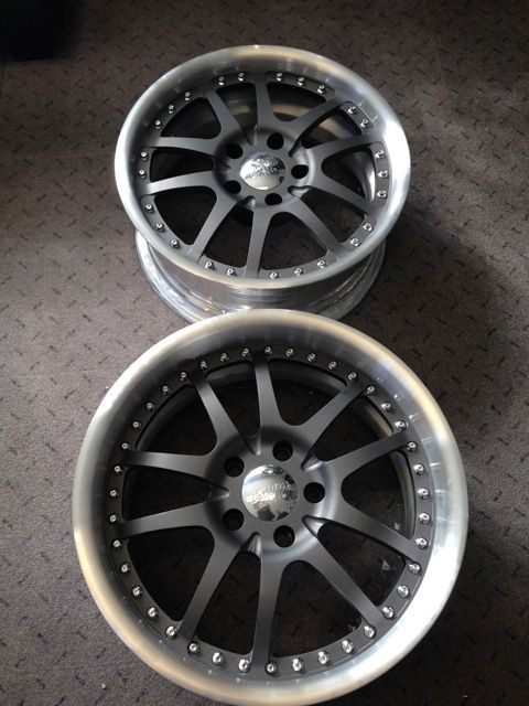

I spent the day today getting a bunch of Radiator hoses cut and fit...........I'm gonna be gone for a couple of weeks and when I get back the wheels and tires will be sitting waiting to be installed.......So.....the list of things that remain to be finished are......get the rear speakers installed......hook up the power wires to the power antenna.......Bleed the brakes one more time.....Get the Exhaust system installed .......and get the front end aligned.........heres a pic of the wheels....

Ken your doing a great job on this car,one of my favorites builds,been watching it all the way.That will be a fun ride when finished
