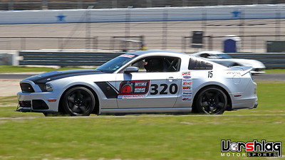

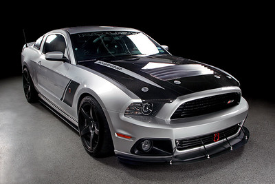

He focused a lot of his attention on a 2013 Mustang GT (below left) road race car and silver Subaru Land Speed Racer (below right) that were in our shop that day, with recent work completed by Vorshlag. The owners of several cars we have built were also in our shop so he could talk to multiple customers face to face.
This type of research is smart, because not enough customers really check the background and skills of the shop building their dream car. They might hear about some shop that a friend says "check this place out", then without much further investigation they drop off their car and hope for the best. Well, this guy didn't take our word for it - he came to our shop when several customers and their cars we built were there and learned a lot.
