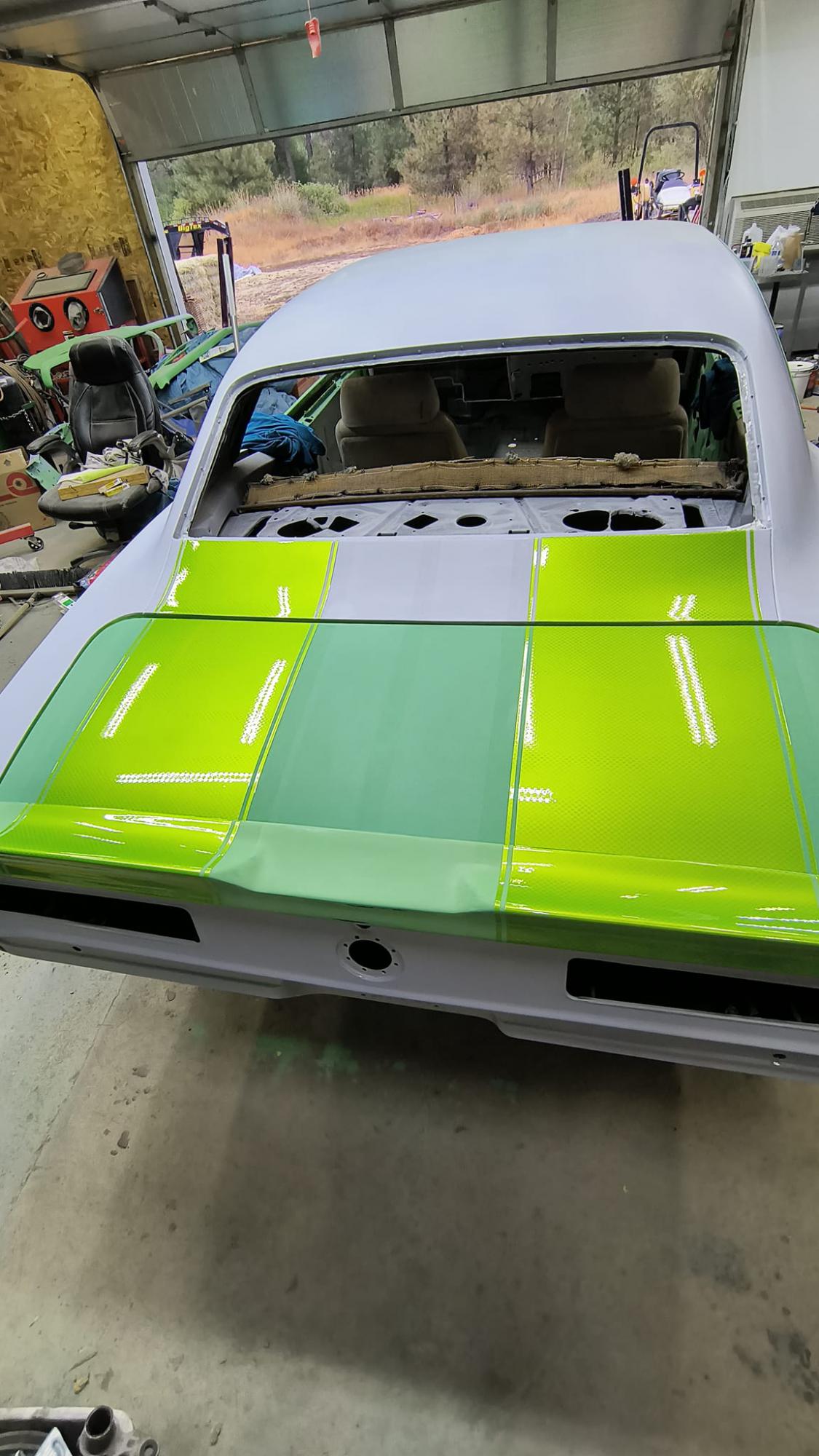

Thanks Chris!! I managed to get a little body work done on it today.
