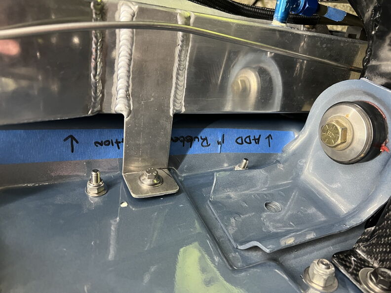

Yes.....closed cell (wetsuit-like density) to prevent high pressure (fan forced) air under hood going to low pressure area in front of radiator when stationary.
While you're at it......open up the core support rad attach holes and install grommets to prevent twist in the panel from tearing up your tank ends.

Sponge Neoprene Stripping W/Adhesive 1-1/4in Wide X 1in Thick X 15ft Long
Originally Posted by Beechy View Post
Existing bolts and washers but need nylon nuts.
Good news is the radiator is sitting on the factory rubber mounts and the upper bolts are sitting in 3/4" Well Nuts to allow for movement.

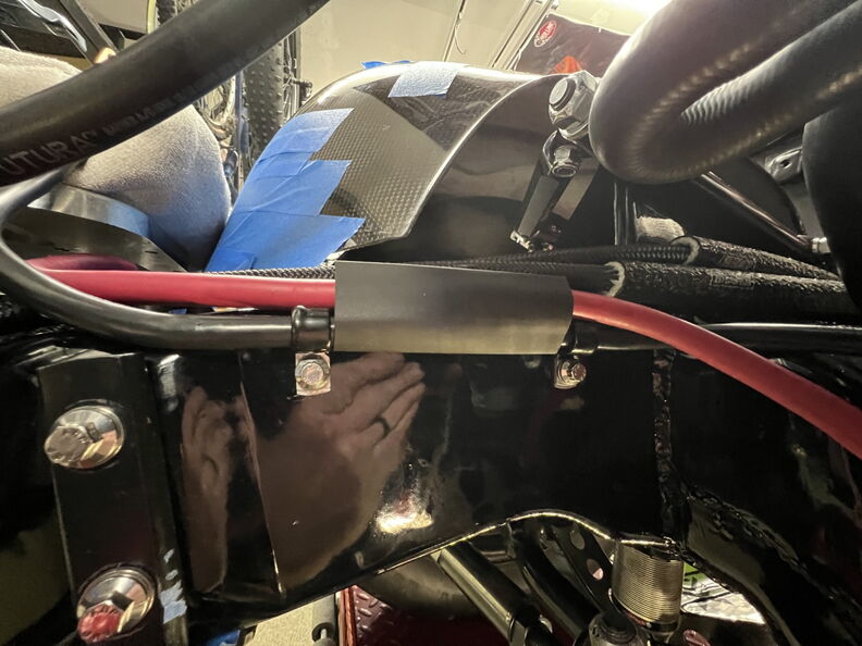

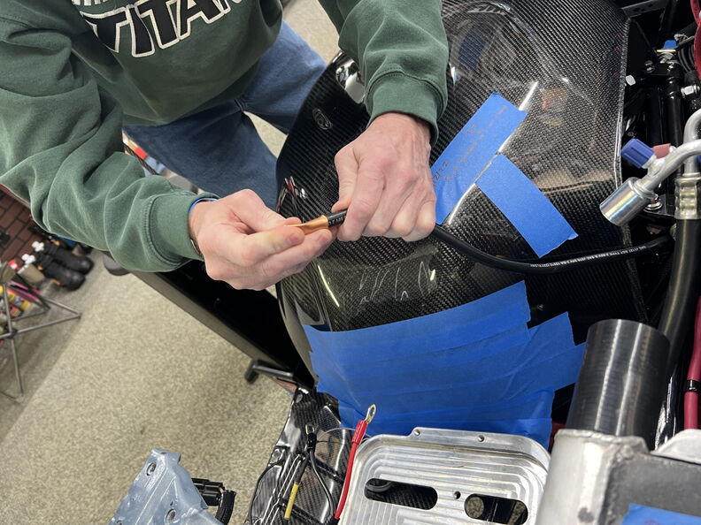

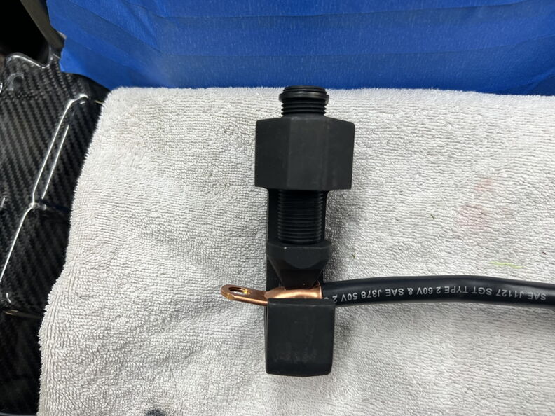

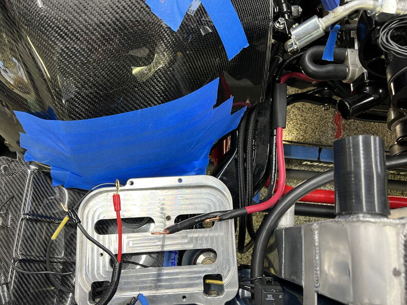

Default Battery Ground Redo ( 02-12-22 )

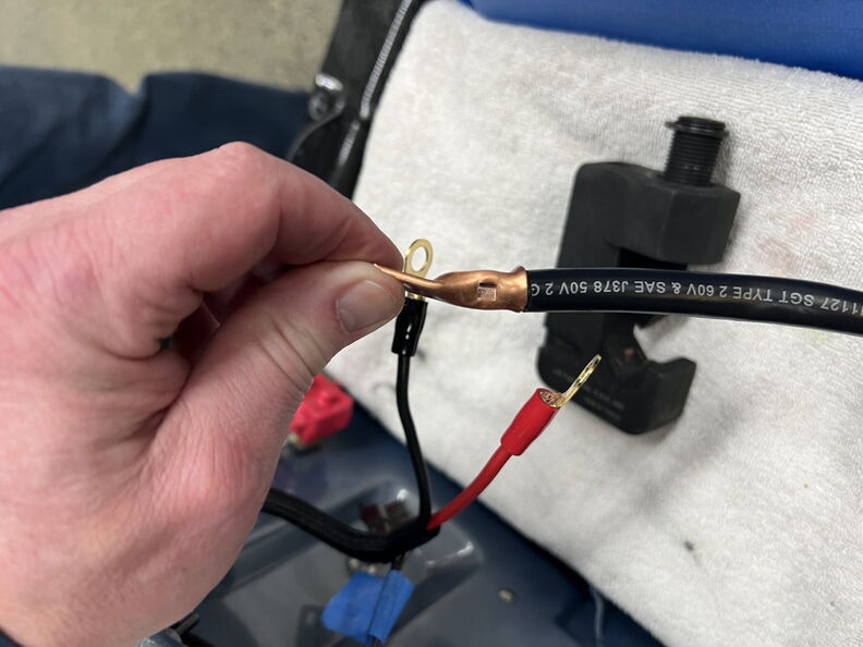

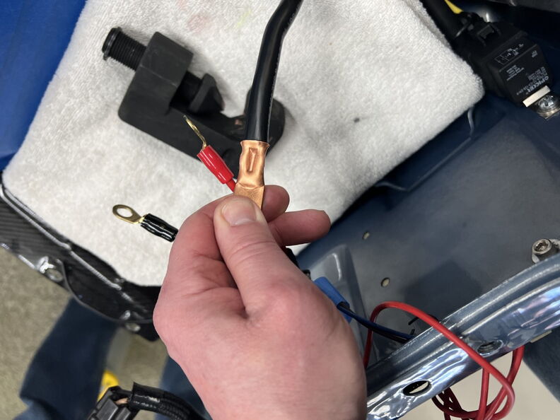

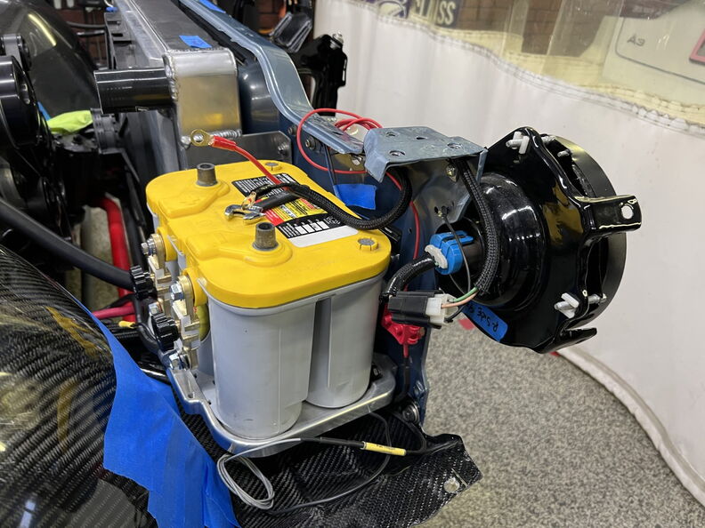

Today's project need to be simple as I had a short window to go work on the car.
Man was this stuff hard to find
I know it's shocking but I finally have a picture of me working on my car.

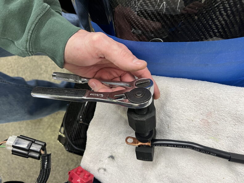

Mike brought over his crimping tool which made the job go much easier as I didn't have to remove the wire.
I really want to buy one of these.

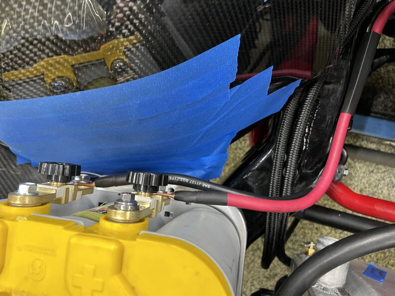

Wire Routing
marty-mj

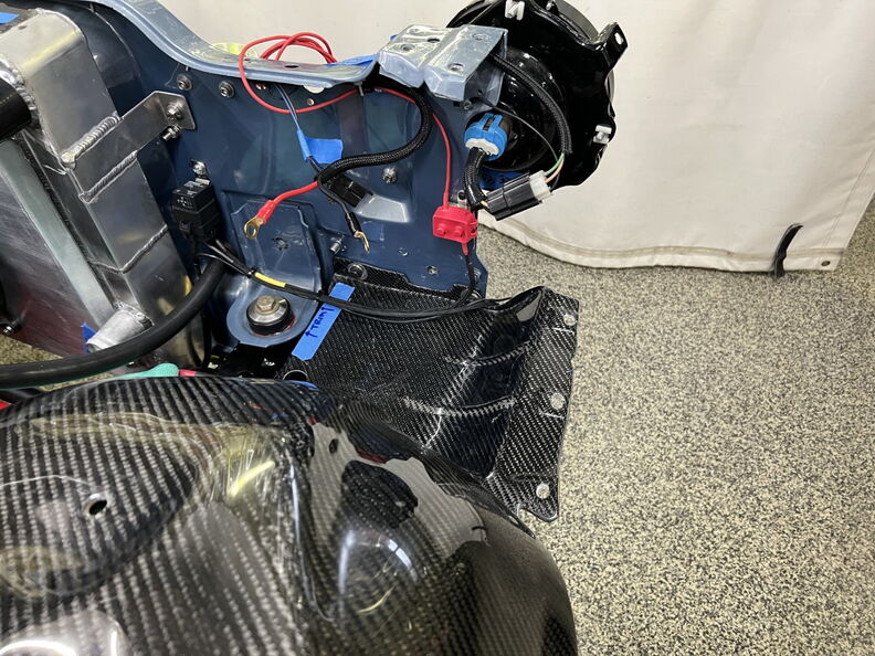

One Question/comment..... on you gas tank vent tube... the valve... if its the one I'm thinking of it has to be straight up/down or the valve doesn't work. I bought one thinking I could get it to work in a spot I had on the frame rail... but if you tilt it at all, the valve closes. So you may want to verify that the valve works in the angle you have it mounted.
So, I have thought about this over and over and I feel like you have confirmed my thoughts.
marty-mj

Another radiator close out option I used is this one... clips around the core support opening vs. adhesive:
https://smile.amazon.com/Black-Rubbe..._t3_B01ANO6RVI
If you take the valve, hook it to a short line of hose and then try to suck/blow through the hose, while tilting the valve....if yours is the same as mine..... you will note that as soon as you tilt it from straight up vertical, even just a little .... it stops functioning. Its pretty sensitive to being tilted at all, which I guess is a good thing if you wreck the car and dont want gas pouring out of it
Yep, it's the same one you had and now it's time to look for a new routing & location.
I found the stuff that came from Vintage Air so I just used that. However this looks way nicer.
