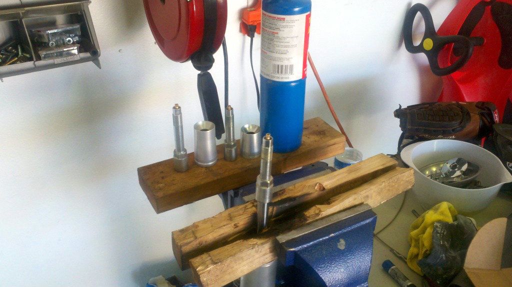

I had fun with the car last week at the Socal Challenge. I put about 20 hours the week prior just looking for loose bolts. I was looking for any issues etc and noticed the driver side coil over was blown out.
The threads ripped out of the lower body
I never felt there was any travel from day one. I have no idea how long it was like this as the car was always firm. I have SPC arms which have a built in drop which made the already short shock shorter. I used 650LB springs at the time. These Varishocks were going to be changed down the road as I already purchased Ridetech rear coil overs so this just moved the fronts up on the priority list. I called Ridetech in the middle of the week and they shipped me a set front single adjustables the same day via Fedex. I went with 700LB spring at their suggestion (225 rear). What was really nice is they have options that will extend the shock. I was not sure which one I needed so I bought both the standard height and the extended. I tried the standard first and needed to raise the car more.
Mike @ Ridetech advised that I would need to use a little heat from a torch and some wood to keep from crushing the shaft.
They use thread lock on these and for a while I was loosing this battle. I am sure it is easy with the fixture they use.

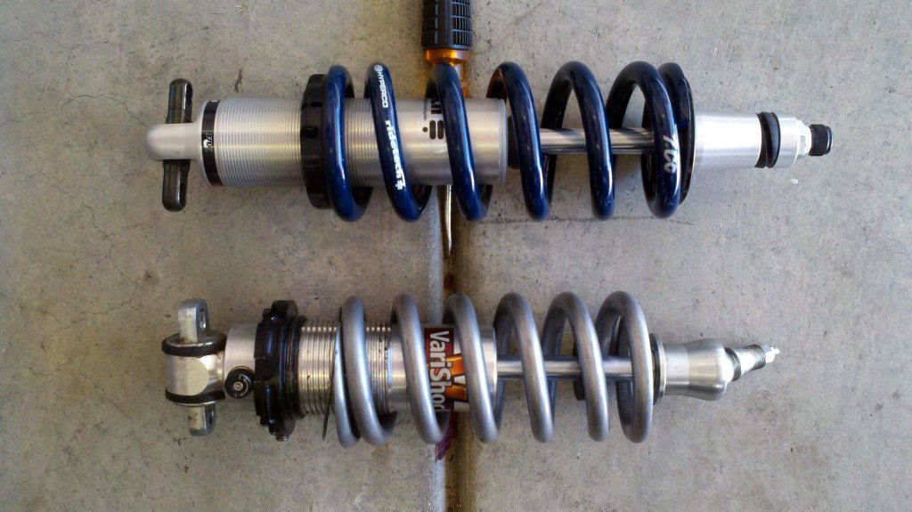

This picture shows my old and new (with standard height before I changed) coilover. The Ridetech shock is far superior in feel quality. The other brand looked and felt like junk imo. I am really please with the ride and performance.

For the price I think these are some of the best shocks
Not only did my ride improve but I picked 2-3 seconds at the Adams AMP track from last March. Shocks and tire pressure were the only things that I changed. I still don't have and id do any shock adjustments yet. This is the main reason I went with single adjustable as it will be a learning curve for me.
