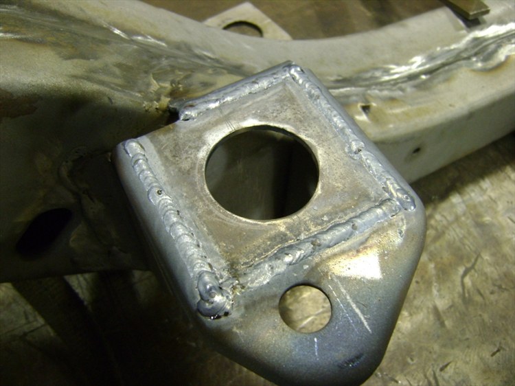

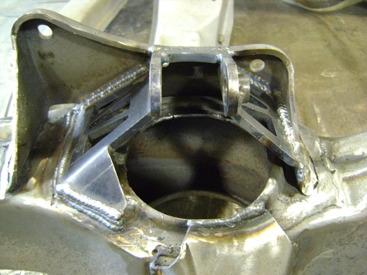

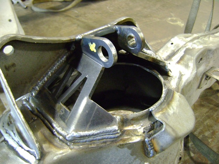

I finally completed the Chicane coilover conversion on the subframe. I'm also working on an installation procedure for Blake and Roger at Speedtech for this conversion. Whenever it's finalized, the goal is to post it up on the Tech section of the home page if Scott will allow us.

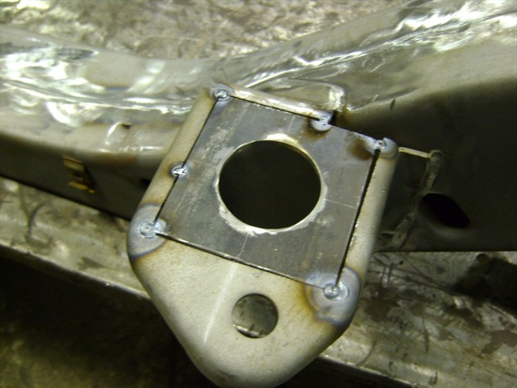

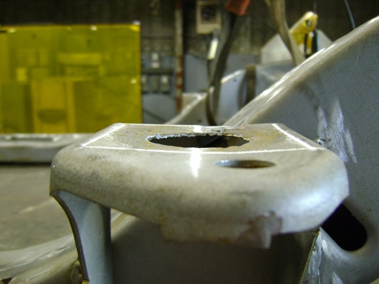

The seams have been welded up on the frame and I plan to body work it this weekend and maybe get some primer on it. As a last minute decision, I opted to repair the front body bushing mounts. Both were pited pretty good but the passenger side was actually dented.
Here's a few photos of the brackets welded in and the subframe mount repair. I'll post more when the frame is fully assembled and has some primer on it.
