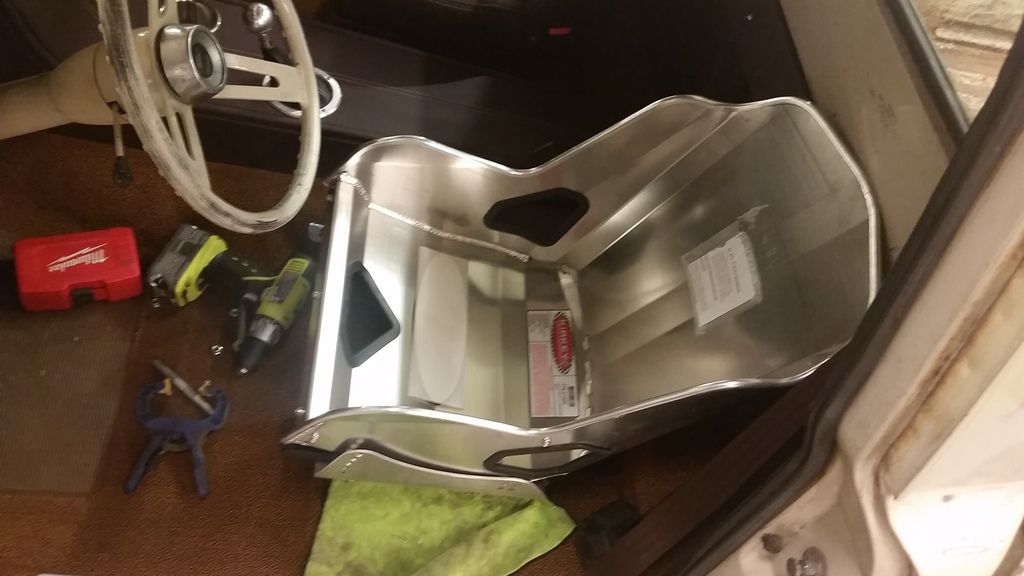

Also got this and the cover yesterday so got a little bit of mockup done. It sucks...but man it holds you in the seat right where you should be, pain in the ass to get in and out of but Ill take that if I can focus on steering.

So in mounting the seats and thinking about a harness bar, I am wondering what exactly I should do to mount the harnesses? I am struggling with the height of the harness bar as it needs to allow the harness to be less than a 20 degree angle to the bar from my shoulder, but that would actually put the bar above the top of the seat with the low back buckets and the cab being right behind me. I think I am just going to build something and see where it lands and hopefully nobody hassles me too much about it. Any input on this from someone that is more experienced with these than me?

Obviously its for safety, but not the kind of safety a massive regulation roll cage offers. If its just to keep you planted in the seat (more or less) does it need to be exactly to what a crazy cage requires? What are the main points of having a harness with a 20 degree shoulder angle? Mostly this is me adding to your thoughts with mine.

The back of the cab is double walled correct? You may not be able to get to 20 but I think as long as it looks correct you won't have a problem in tech.

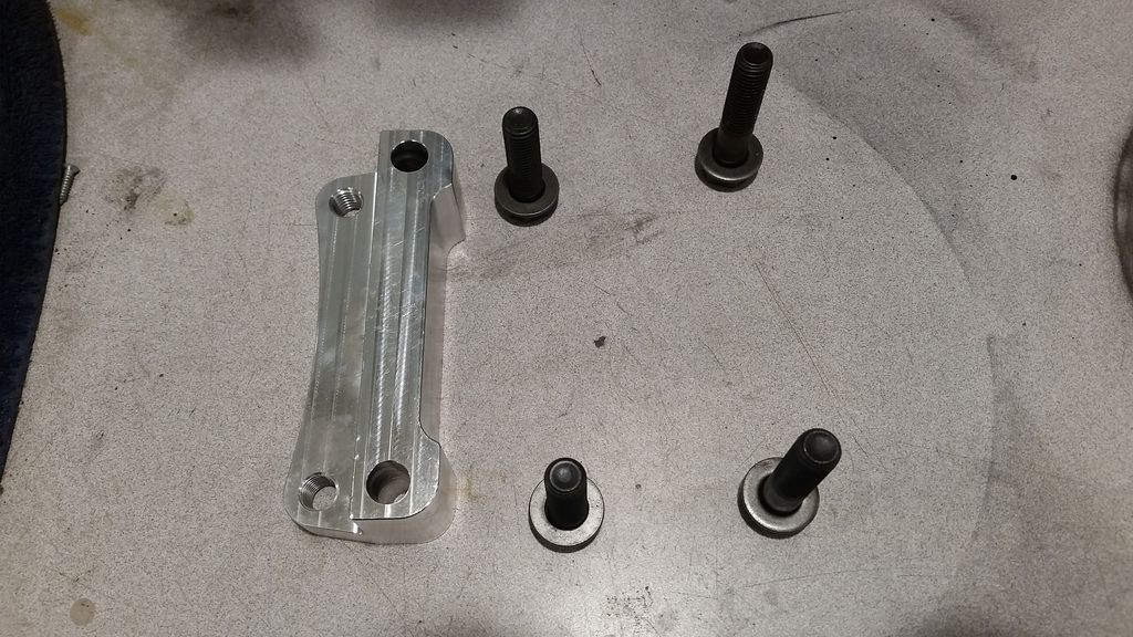

What I started with this morning.

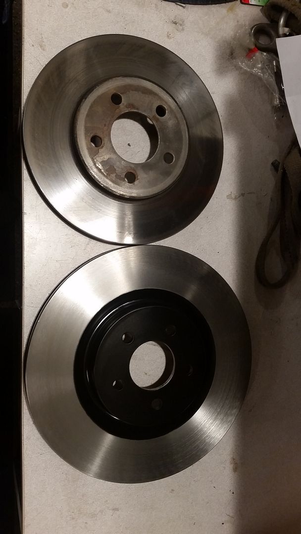

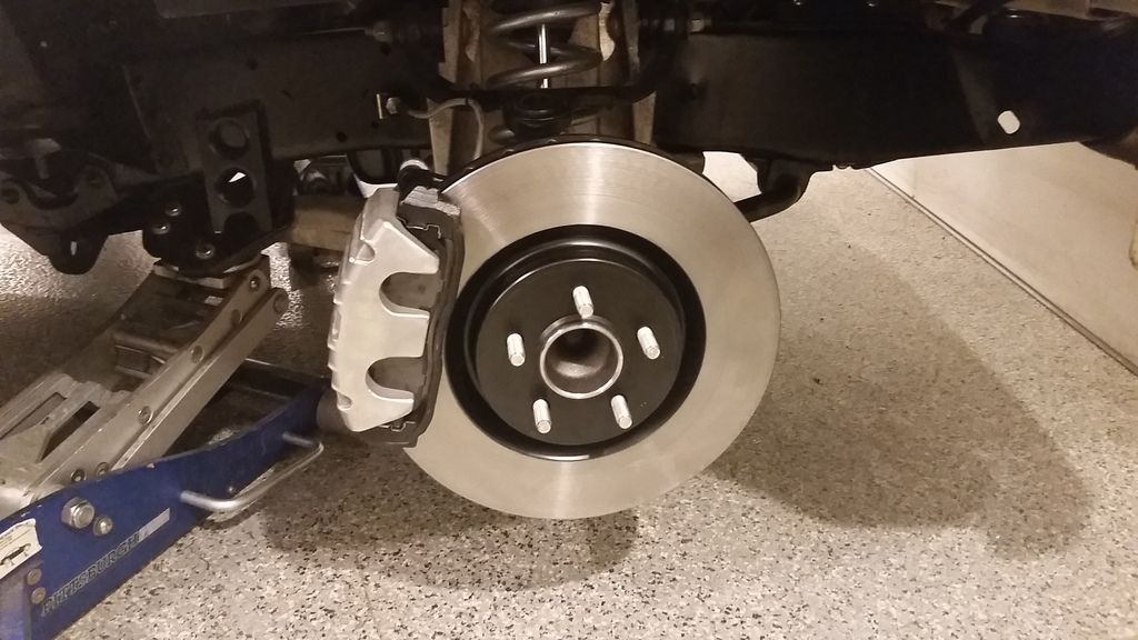

So you can see the brackets here in the photos, they are really nice quality and the hardware came with them. They adapt the crown vic frontend to the C5 corvette PBR aluminum calipers and run the 14" GT500 rotors.
The Rotors needed to be opened up at the center of the hub to fit over the crown vic.

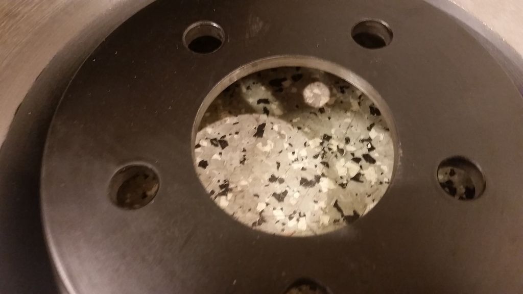

You can get the idea from the photos of the size difference from the photos. Stockers are 12" and the upgrades are 14"

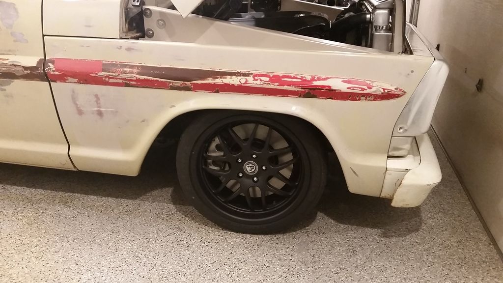

I had to make some provisions to the calipers for the smaller wheels..you can see I made some changes with the grinder to these. I have about 2mm clearance now to the caliper from the wheel...its tight but it should be just fine.
I love the fact that it is OEM looking but biggg..
I likey.

Nice brake solution!
Now duct some air to them and you're good to go.

Before and after says it all! Damn nice. Im surprised you had to modify the caliper, but i guess that is due to the high offset wheels.
I thought so too and kept with the OEM Theme of the truck. Thanks Sieg and appreciate you sharing some killer photos with me.
I am working on the brake ducts this week, hope to have them done before next weekend.
Actually the fins are on the back side of the caliper where the mods had to be. Its likely because of the aftermarket 18" wheels have a thicker hoop than the OEM ones. I have seen a couple people be able to run this setup with 18" FORD wheels. It is also a 14" rotor, its pretty good size.
