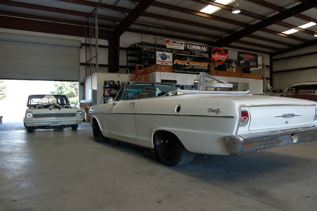

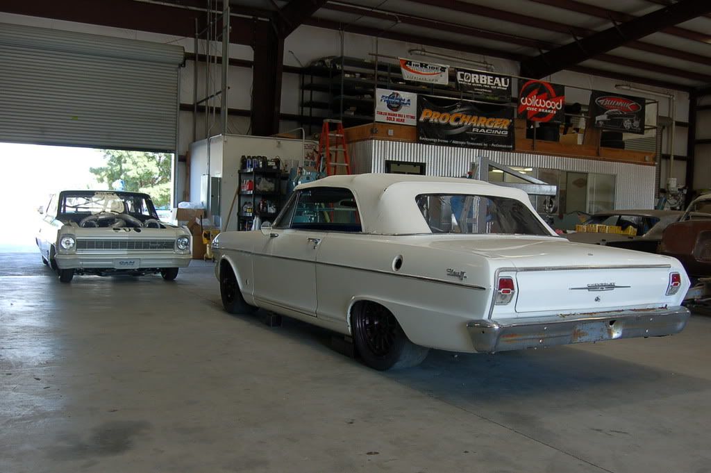

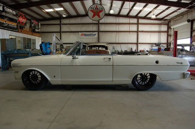

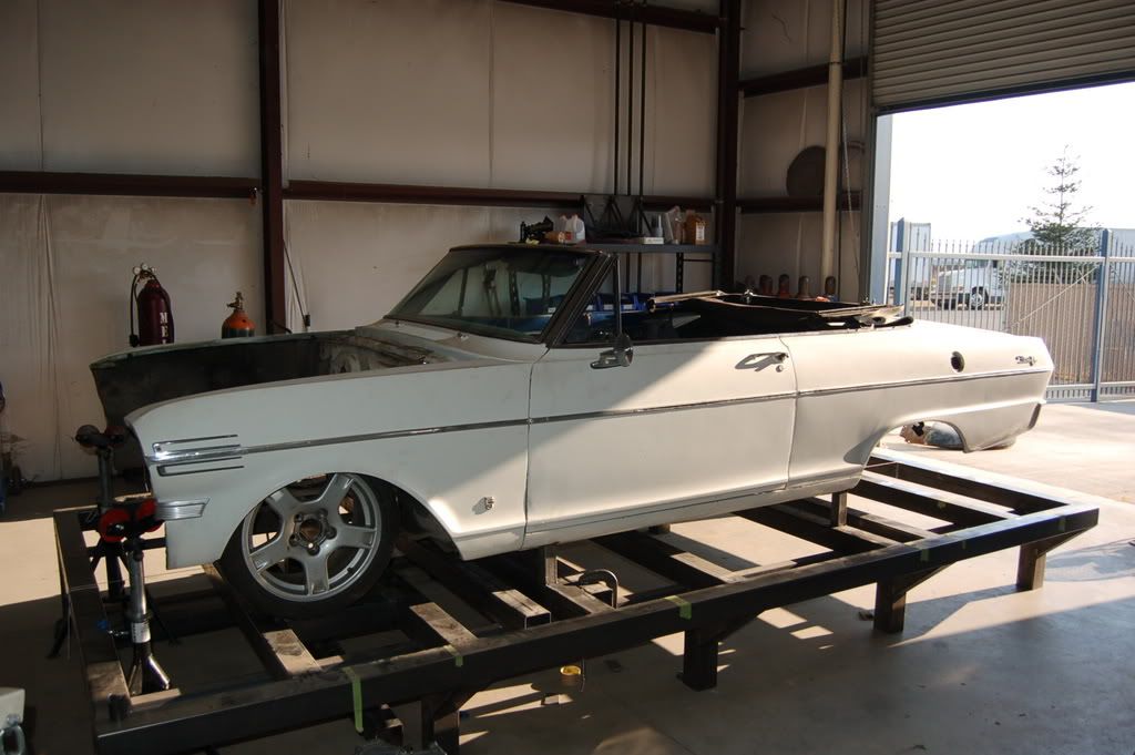

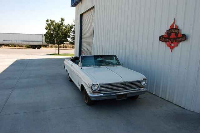

As it arrived at IRONWORKS (a.k.a. Novaworks):

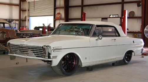

IRONWORKS wasted no time in dismantling the Nova to determine a proper ride height. Here are some mock-up photos:

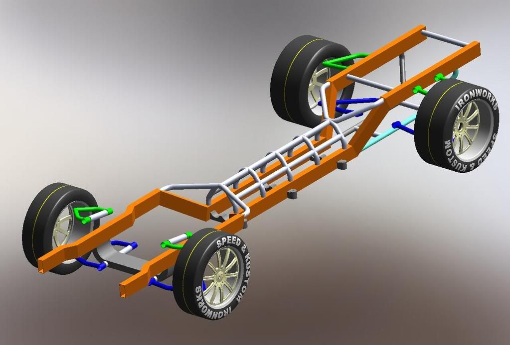

Here is my initial frame concept modeled in SolidWorks:

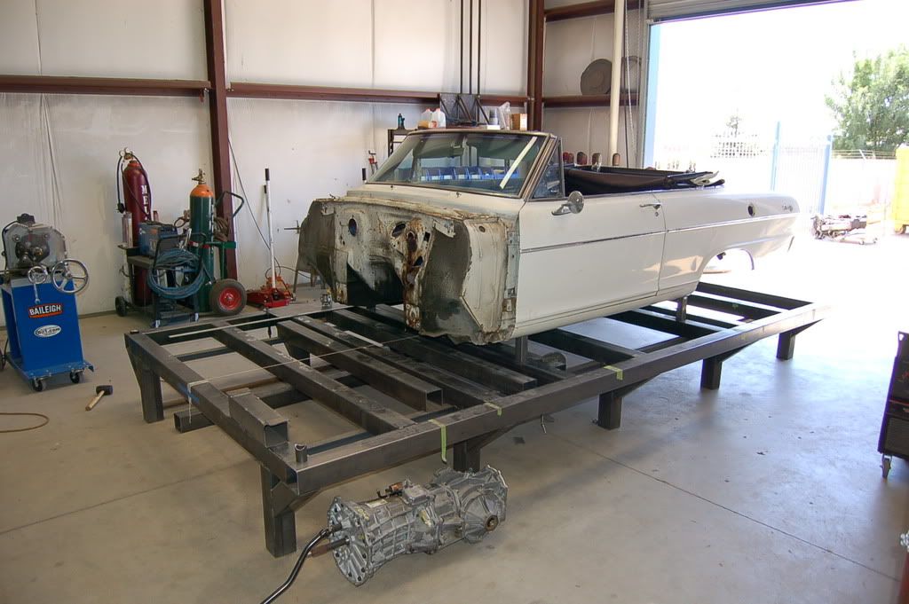

On the frame table:
I love using SolidWorks to model my ideas!.... it's a sickness.

Old 07-31-2008, 07:11 AM
HWY Nova HWY Nova is offline

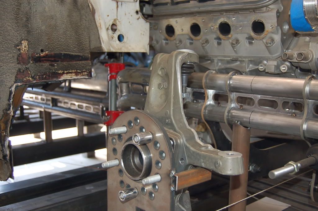

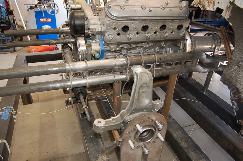

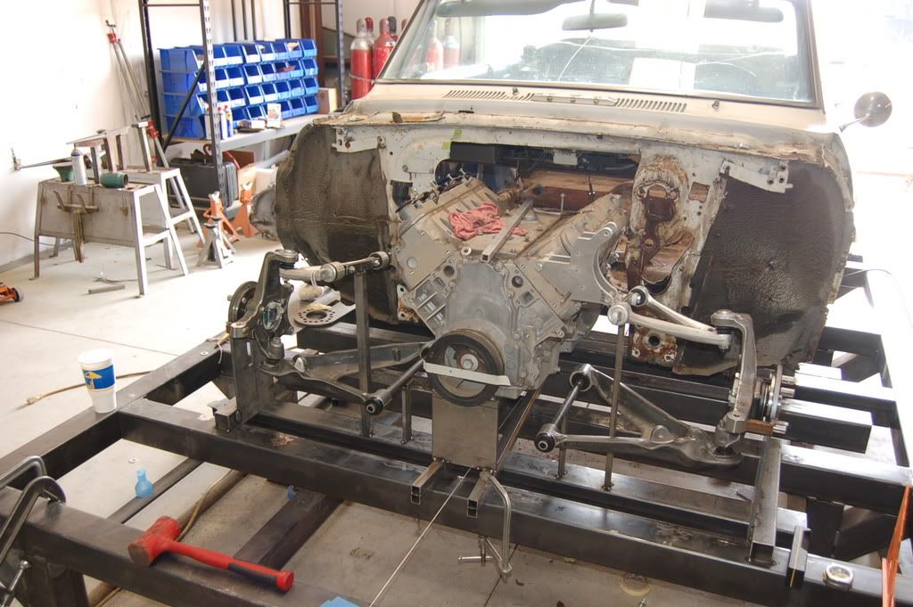

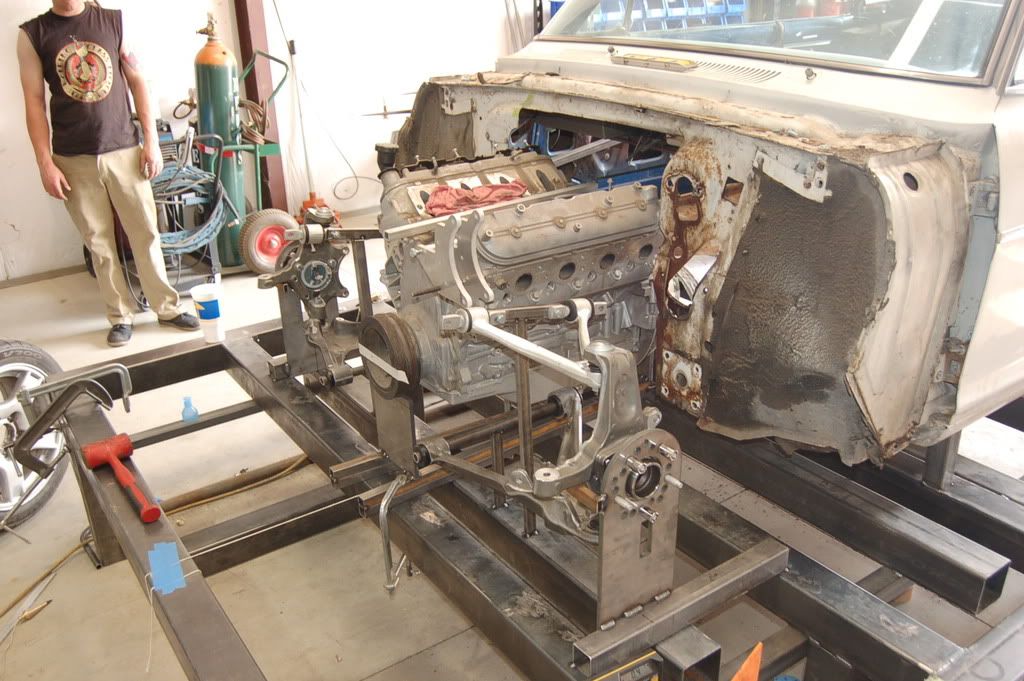

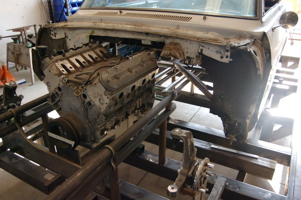

Default Front Suspension Mock-up
A shot with fender and initial wheel placement:
Here is a shot of the front suspension already in-place:
Another view:

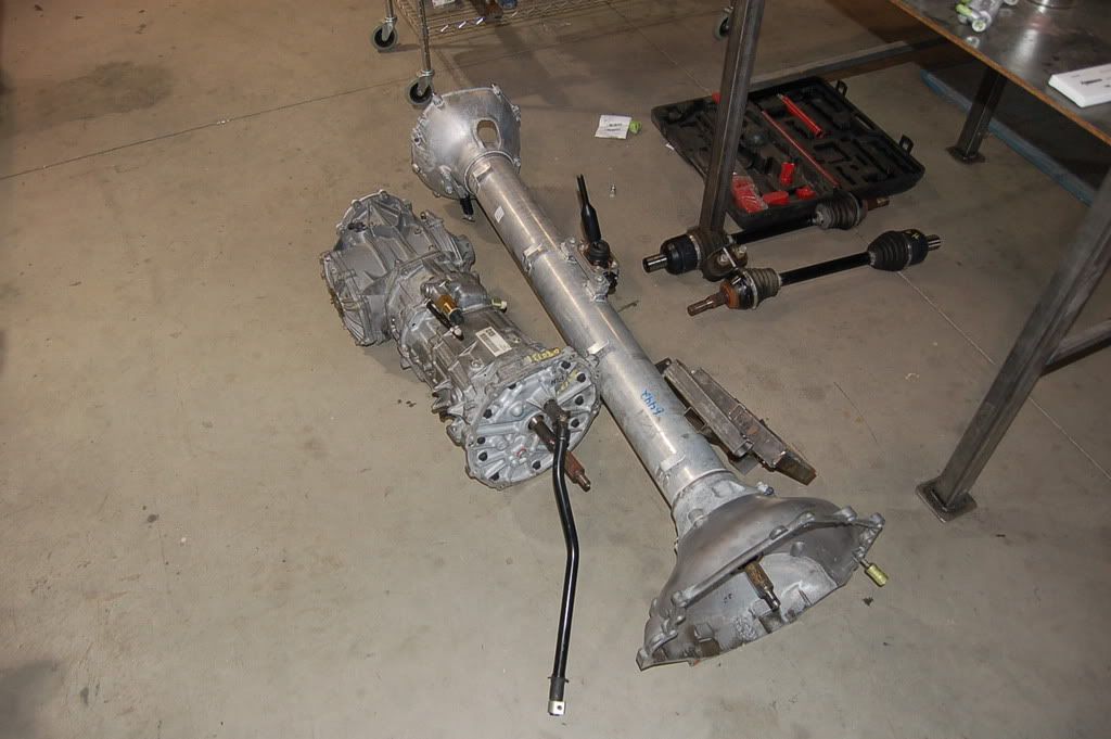

Torque tube, transmission, and transaxle:

Default Frame rails

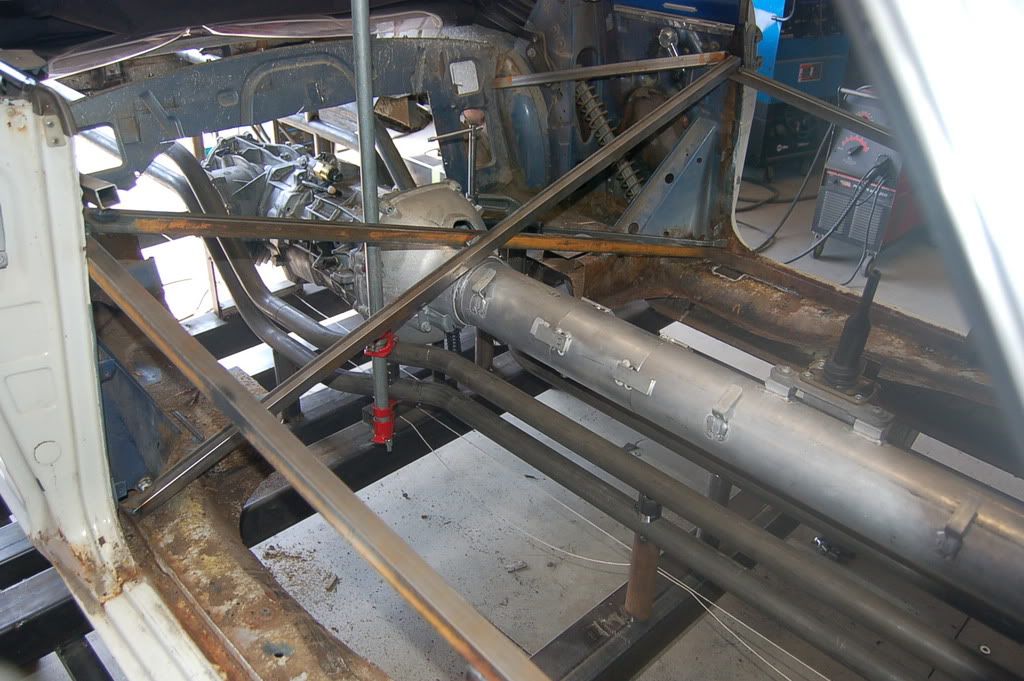

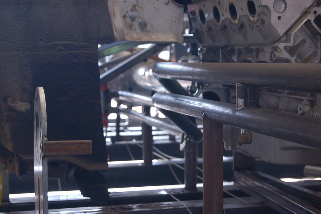

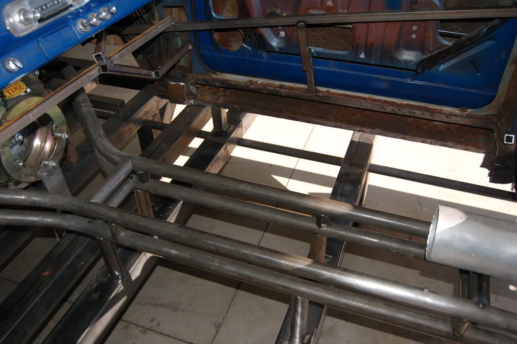

The initial frame layout design called for rectangular tubing (2x4), however, after a few discussions, we decided to use round tubing (1.75 x .12 wall).
Initial frame rail layout:

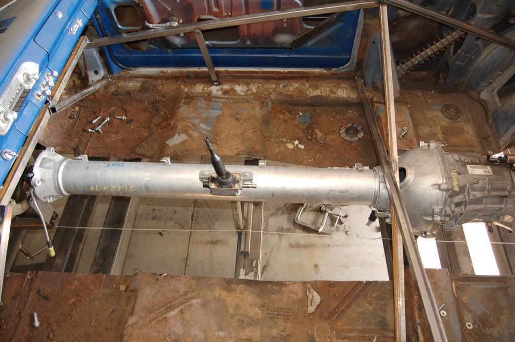

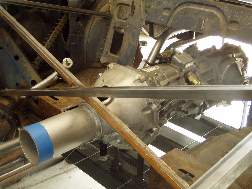

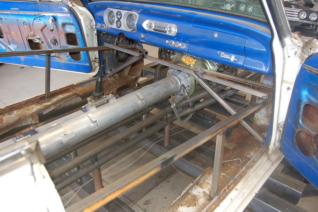

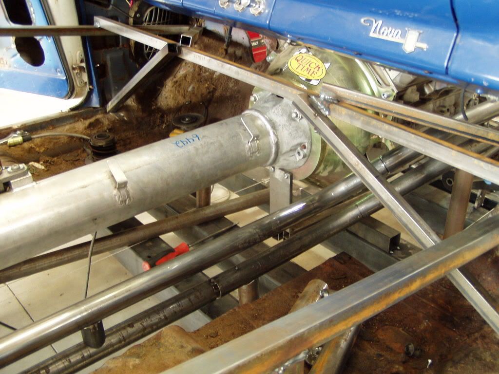

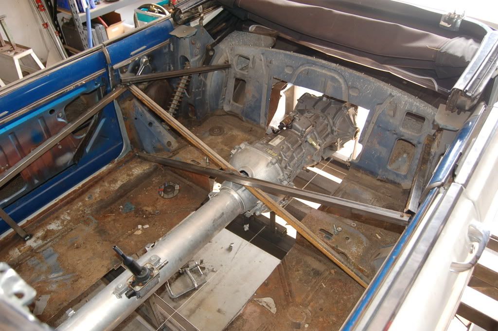

Default Torque-tube
The torque-tube had to be lengthened to fit the car. IRONWORKS cut the tube and mated the forward section (with the shifter) the the new Quicktime bellhousing. From there it was easy to (temporarily) add a section of aluminum tubing:

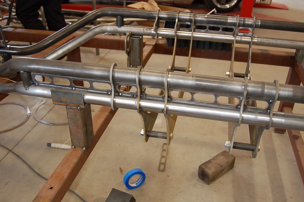

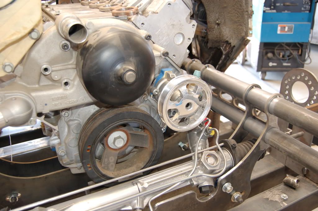

In order to make the frame rails stiff, we had to add gussets in between the parallel rails. We looked at several different configurations and ended up with slots:
All of the bracketry is designed on SoildWorks. The files are sent to a water-jet company, and the parts are produced. I love it.... from the computer, to the water-jet company, and in our hands quickly. Rodger will tell you that he is picking up water-jet parts daily...... sometimes hourly!
More frame photos:
