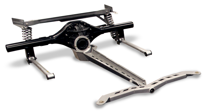

a BIG Thanks to Jay at http://www.speedtechperformance.com
He's been real patient with me, answering all my questions, and now I finally have my rear suspension selected.
They're going to help me modify a 1st gen Camaro torque arm
Man i am stoked!

A torque arm is a solid choice for a set it and forget it usable rear setup. It’s nice to see to you continuing to move forward on the Torino. You’ve done some nice work on her.
