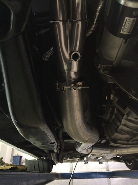

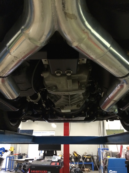

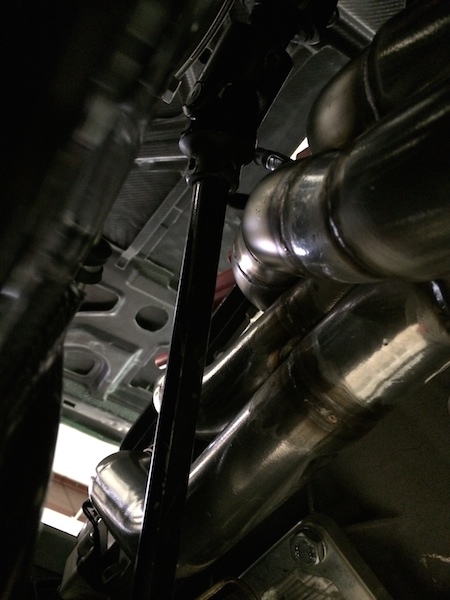

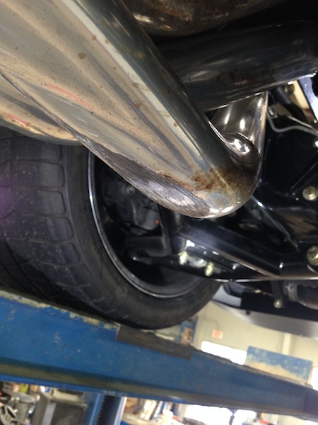

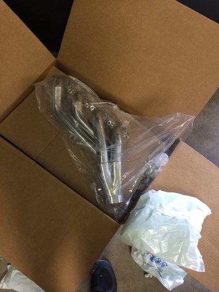

A while back I mentioned I would post some pics of the Dynatech to Ultimate Header swap.
Here is a before...we had roughly 2.25" of clearance. Not good. They lasted less than a month of driving once we got it off the transporter.
Name:  Dynatech Header Scrapes.jpeg
The replacements: Ultimate headers
In the box:
Name:  Ultimate Headers in Box.jpeg
Installation was great on the passenger side:
Name:  Header Installed-Passenger.jpeg
The driver side did not fit and needed modified:
Name:  driver side header modified to clear steering.jpeg
Name:  Driver side header clearanced around steering.jpeg

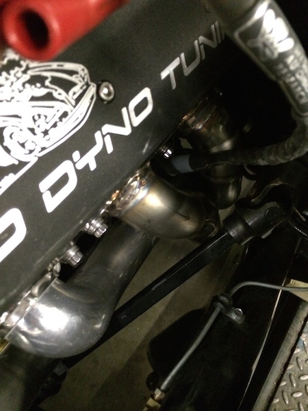

Once modified and installed we picked up all kinds of ground clearance:
Name:  exhaust extensions to headers.jpeg
Name:  Header and Exhaust Installed.jpeg
Jay

Hi Jay,
Thanks for sharing the info on the headers. I ended up doing shorty's on the 70 for just this reason. I am going to consider these for the new Scott Mock Subframe that is for sure.

Jay, is it me or does the O2 sensor bung got installed wrong? Looks to me the bung is at the bottom of the header.
I had the same issue with the Dynatech headers as well, until I flipped the mounts 180*.

Pictures are deceiving. The bung is on the part that is parallel with the firewall not the floor pan.

The pics are deceiving. The header and exhaust runs parallel to the firewall and the bung is tucked up in the engine bay. You barely see it if looking at it from above.
