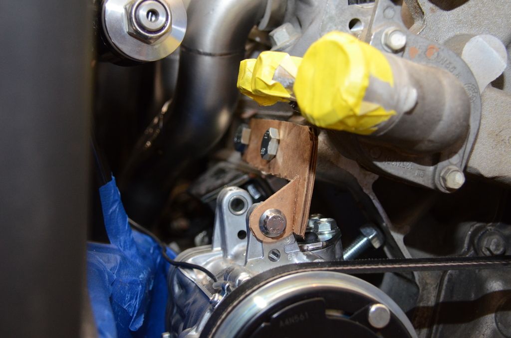

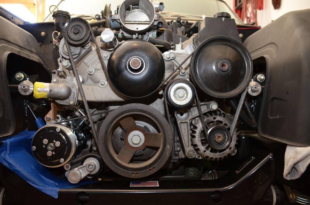

Still chipping away a little at a time, I started messing with compressor mounts really desperately trying to avoid the cost of a front runner setup. Not that I wouldn't like one it's just not in the budget, plus the rest of the accessories fit with zero modification. So, when I ordered the vintage air gen iv I had them send me an Alan Grove low mount and compressor. Well the 508 was never going to work, I swapped the 508 out for a sd7, I had to drive a flange bushing out of the compressor tab and just flip it. Now the Alan Grove lower mount works with the sd7. I still have to fab an upper mount, rough cardboard template shown in pictures. Overall I am really happy with this setup, I though I'd have to move the compressor to the front serpentine belt, but I was able to keep it on the factory rear pulley. The tensioner is very close to the crossmember, so I may have to address that too.

Oh, and here's the metal version on the upper compressor mount. Haven't welded it yet because I am stressing about belt alignment.

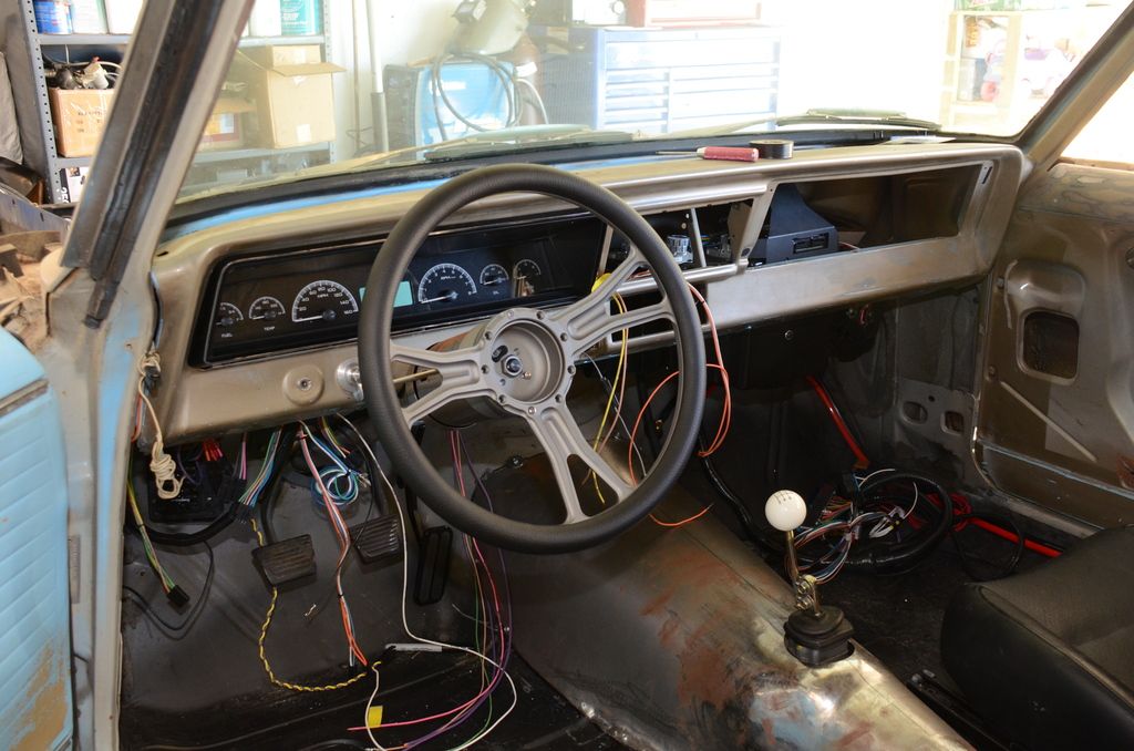

Ididt column, Budnik wheel, dakota digital vhx gauges, and the beginnings of some wire layout

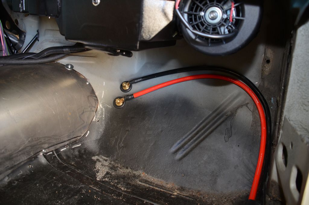

Battery bulk head fittings and vintage air evaporator mocked.

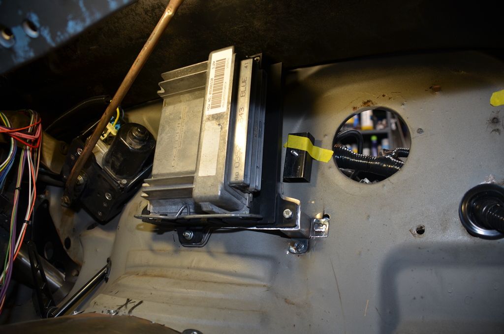

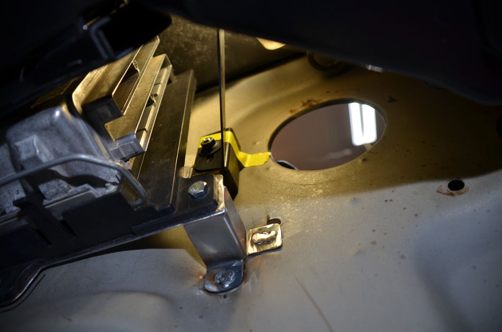

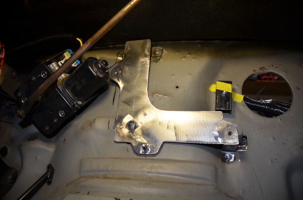

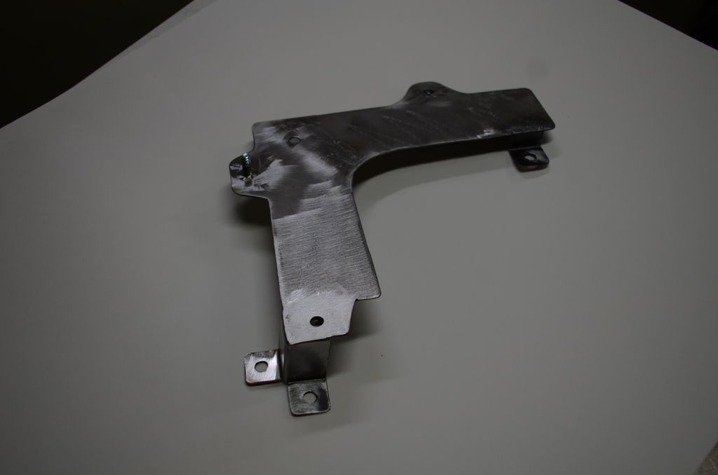

Been cold but managed to check a few to do's off the list. Fab'd a PCM mount to be welded to the firewall.
Bracket welded and pcm mounted

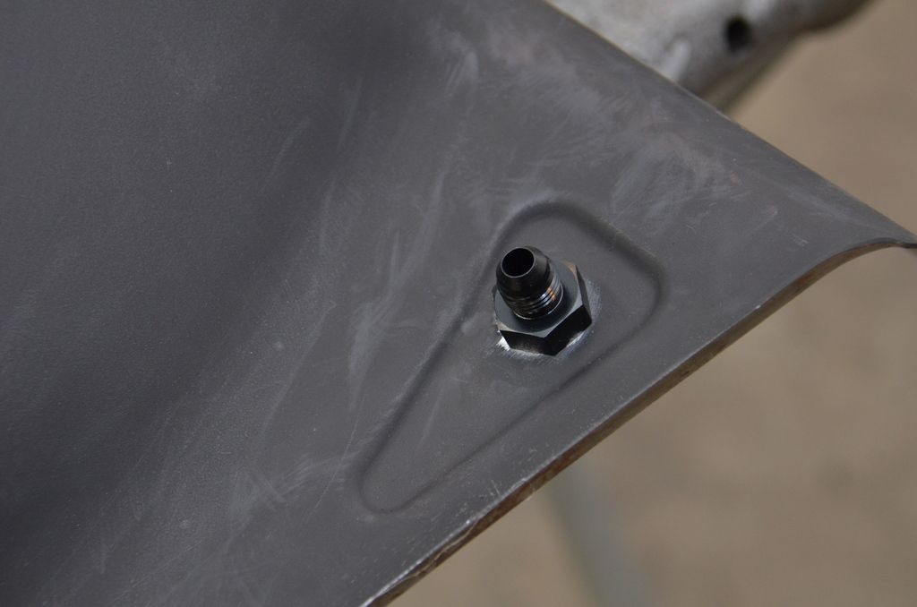

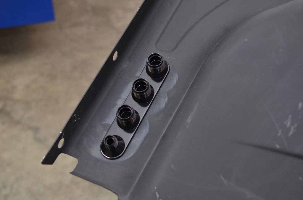

Also, drilled holes and installed bulkheads for the a/c fittings. And A single 6an bulkhead for the fuel line.
