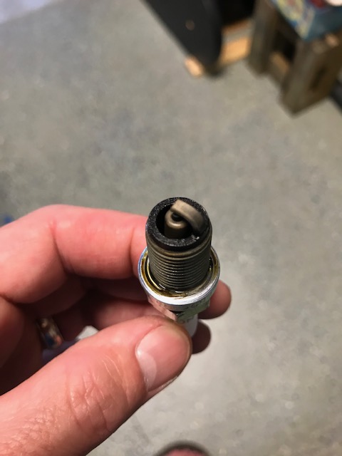

Here are the #3 and #4 cylinder plugs from last week. BUT, this was just after having the engine warm up at idle. I haven't done a proper shut down after WOT plug reading.

Daniel, just throwing out all possibilities. If you're able to check with the guys you bought the engine from, try to see if you can find out the specific crank they used. I realize it had external components but just in case the wrong parts went on.
You purchased a new flywheel, is it the one with the weight pad that's bolted on? I realize this is a alot of bs but maybe take the weight off and see what happens.
The plugs look okay, the cam specs seem to be a bit high for the compression you're running. I'm wondering if that has an effect on the run cause Lunati says it requires a minimum of 10.5 compression.

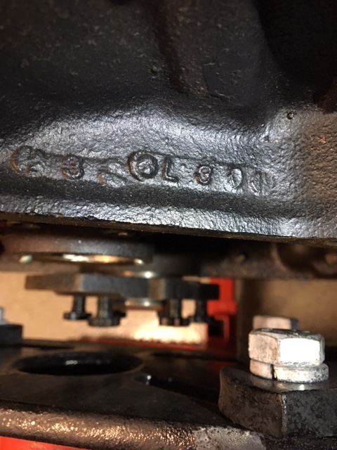

Simon- I appreciate ANY ideas, really. At this point, I've resigned myself to pulling the engine this winter. So, I don't mind chasing any possibilities up until that point.
After I bought the engine, I removed the oil pan to verify it was a 383 stroker and see what the cylinders looked like, etc. I've attached the photos I took while the pan was off (sorry for the low quality). The number cast into the crank counterweight is hard to read. After a lot of research time online, I *believe* the crank is made by CAT (Cal Auto Transpeed). A lower quality, chinese import, that subsequently is out of business from what I can tell.

that plug does not look happy. have you verified which advance springs are installed? Are you using a non-digital timing light to time it?

ScotI- No, I haven’t had the timing lower than 36* total. I’ll decrease it 1 or 2 degrees and see what i get.
Mike- the 21* bushing is in it. I’m using a basic, non-digital, Craftsman timing light.

Daniel......which spark plug part number are u using?
Do you know if they are the right heat range?
Do you know how far they protrude into the combustion chamber?
Plugs are available in regular reach as well as long-reach.....maybe u have the long version. Look up plug manufacturer charts and cross-reference charts.
Call up the head manufacturer to get plug recommendation.
Try side-gapped plugs to minimize protrusion into chamber. Too much protrusion will create a hot spot because the ground electrode stays too hot and promotes "dieselling" which is also pinging. Auminum heads would draw enough heat from the plugs as not to be an issue if heat range is correct but not if protrusion is too much.

The plugs are NGK BKR5E, per NGK's tech support that I spoke with.
I've also tried NGK BKR7E and Autolite 3922 plugs.
