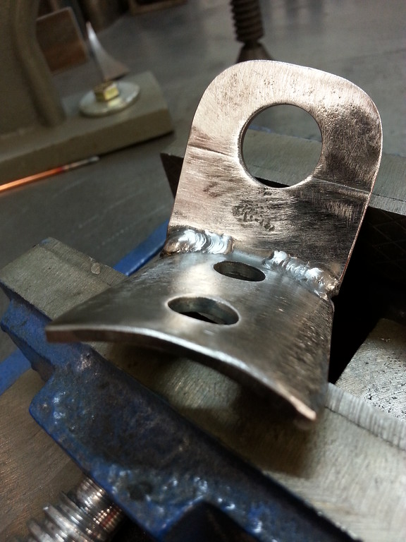

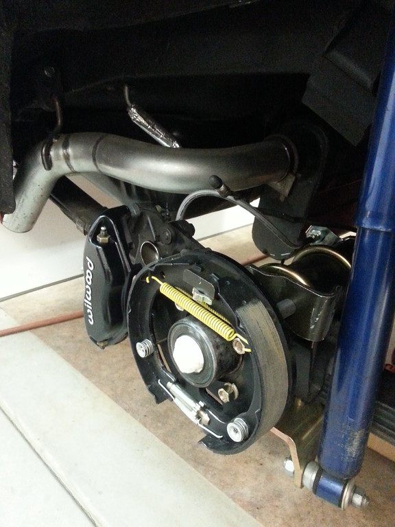

Back to business......
Decided to stay with hard lines inside stainless 'gravel guard' on the rear end housing with a stainless flex lines to the housing and calipers.
Prepped the calipers for paint
Applied Krylon BBQ paint and about 20 minutes after painting used a razor blade to remove paint from the raised lettering.
Made these brackets out of 2x2 tubing then decided the base was overkill and cut it in half before plug welding to the tube.
Mockups
Hopefully today I'll slip the axles back in and index the backing plates and get them secured, fab the hardlines, mock fit it all again and align the calipers then disassemble and paint, and tomorrow reassemble and bleed the system.
Hopefully......assuming the rotor and caliper alignment doesn't create challenges.
