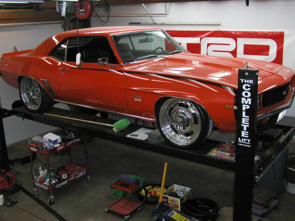

Just Wonderin On Your Smoothies What Sizes Did You Use I Loved That Look I Have Your Car As My Screen Saver .did You Use A Shortened Rearend ,or If It Was Stock What Offsets Did You Use ?
Tire And Wheel Combination Did You Use?
I Wish I Would Have Bought Them Please Help Me Out With The Info Thank You
I was running a 20x8.5 with 5 1/4" b/s and 285/30R20 tire. My rear end is a 12 bolt housing that was built to stock width, but I'm running big ford bearings (no c-clips). The leafs are globle west cat 5's dearcked about 2 1/4 inches. I think a total of just over 3.5" inches.
In the front a 18x8 with 5" b/s and 235/40R18. On the fornt I run 2" dropped spindles and QA1 adjustable coil overs. After installing the dropped spindles I had to run a 1/4" spacer for clearence between the tire and tie-rod end.
If your going to order rims I would just use this as a reference. I've probely let about 3 or 4 other people try my rims on their cars (all camaro's 68,69's mostly stock) and they never fit the same way on each car..

I had issues with my drop spindals as well I had a 18x8 with 5" b.s. and it rubbed the tie rod end... changed to the 4 & 1/2" b.s. and it fits fine...woulda never used the drop spindals in the first place had i known it....
I felt the same way but at the time I had sent all my front bear set up back and exchanged it for the drop spindle set up.
My car sat to high without the spindles so I had to compromise. Now with the 20's in the front there is lots of room even with 5" b.s.

Sure looks great on the photo! Can't wait to see the new pics once you get the wheels mounted!
