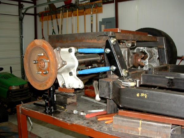

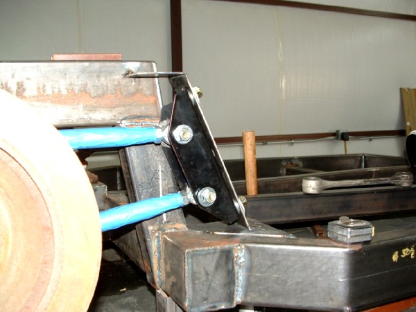

Default Update -- and pics!
Well, here are a few shots of the suspension tacked into place so I can find the optimum location for the camber bar. Oddly enough, I get the best results with the camber bar located right under the half shaft....getting just a little over a degree positive camber in rebound, and a little over 1.5 degree negative in bump.
Using .120" plate for the boxes for the trailing arms, and the boxes will be just that -- fully boxed on the inboard side with gussets top and bottom on the outboard side.
Thoughts? Something tells me that .120" is too light for mounting the trailing arms, but the main tubes are .120" wall for the chassis, and these will be fully boxed sections, not just three pieces of sheet tacked together.
-jeff d
