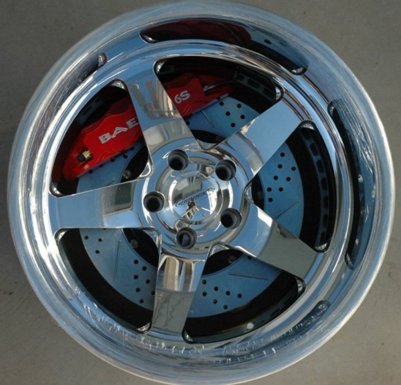

Old 02-03-2008, 02:11 PM
SDMAN SDMAN is offline
Join Date: Nov 2007
Location: Mesa, AZ
Posts: 80
Quick update. Here is a wheel, tire and brake shot. Wheels took longer than they were supposed to, but so is everything else.
As for the frame, the rear frame rails have been moved in 3" a side, we have the custom 4 link complete, watts link is fabbed and the mount is almost ready. Coil overs are mounted as well. Should have the frame out of the race car shop late this week.
Currently stripping everything off of the body shell in preparation for cutting the floor out of it so we can mount it on the frame. Have the motor plates, dummy block and gutted 4L80-E tranny for mocking up the drivetrain. And the glass front end is going on at the same time. Once the body is on in the final position, we can position the tires, cut the axle tubes and order the axles. Then it rolls.
Likely wont post again until this is all done. See ya in late march.
