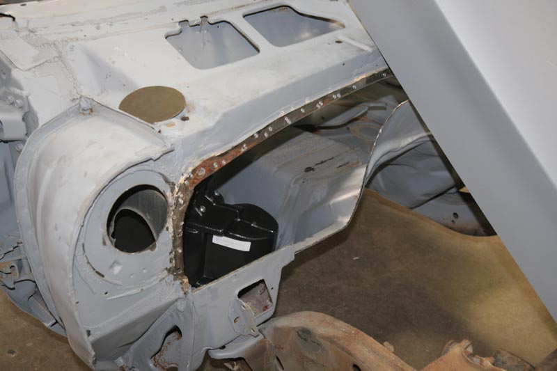

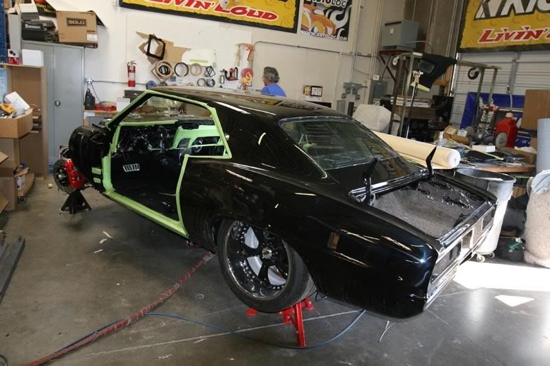

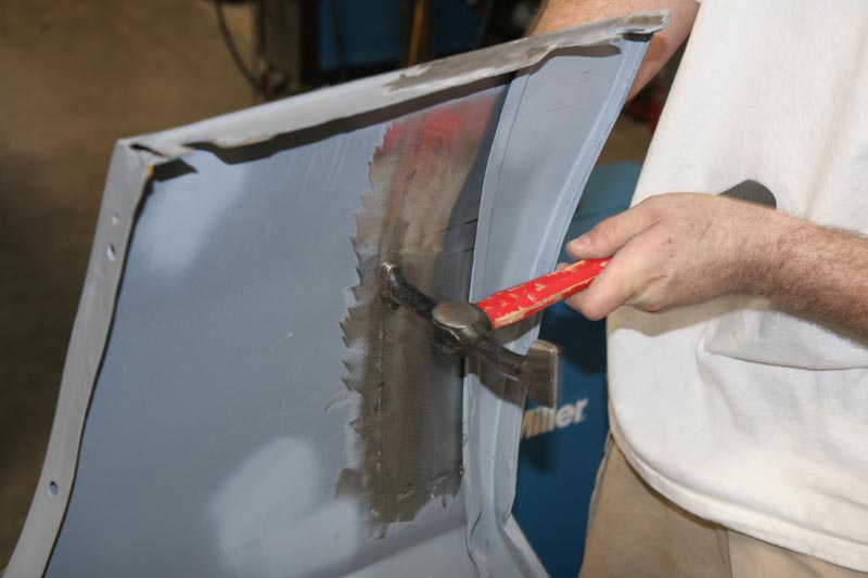

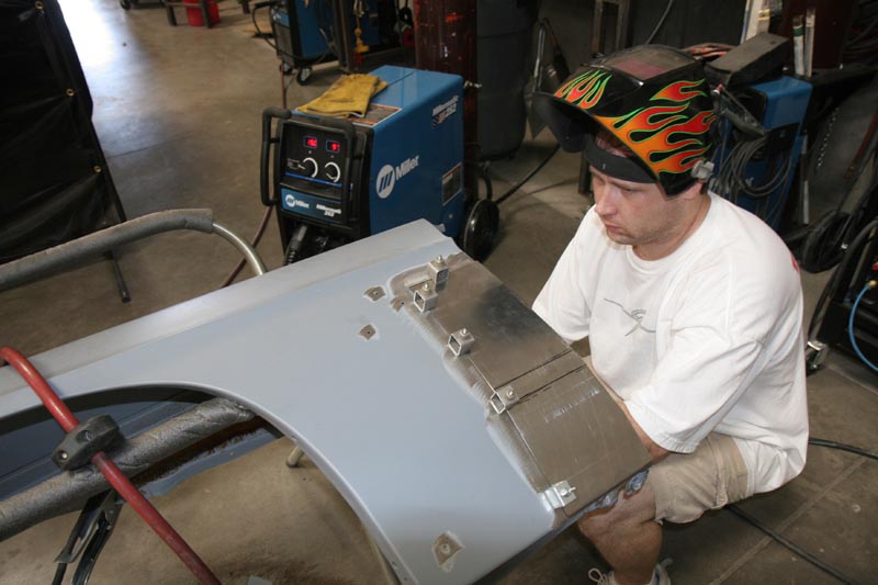

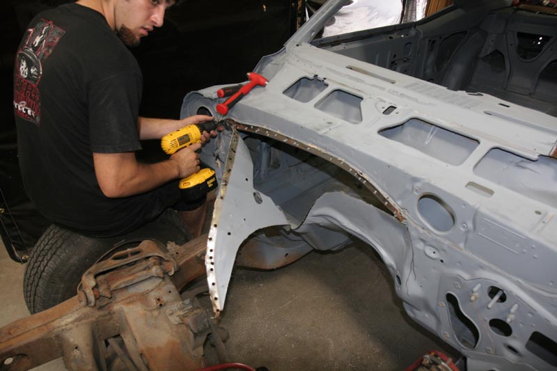

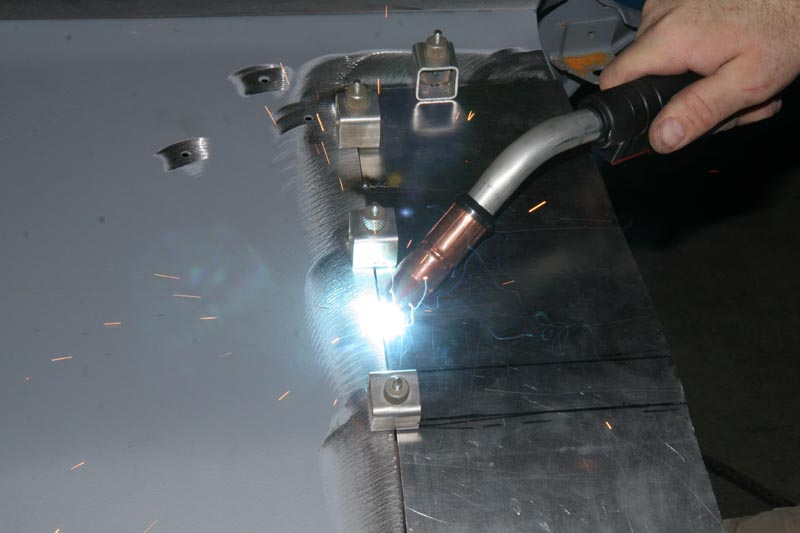

Here are some shots of fixing some rust on the door and getting the firewall ready to be smoothed out. We do the car right we cut out any and all rust and weld in new metal for a rust free body.
Chris Fesler
Fesler Built - Scottsdale, AZ

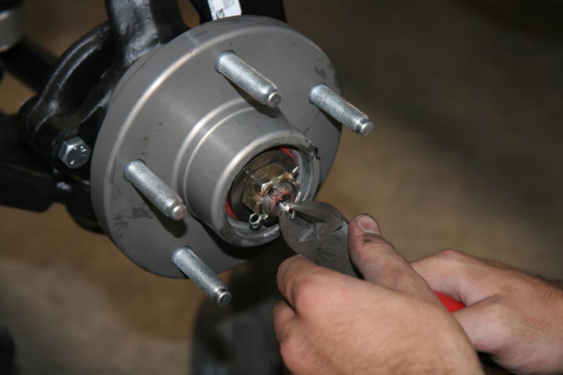

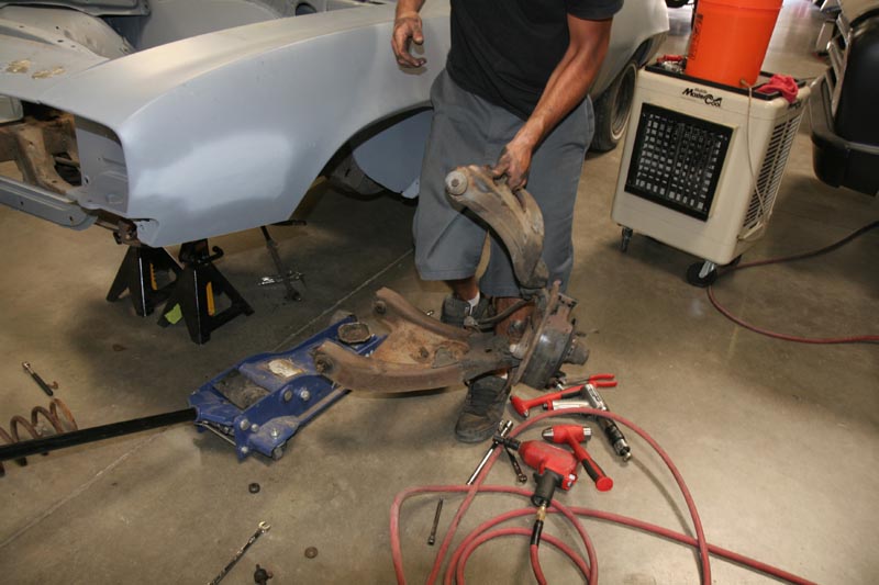

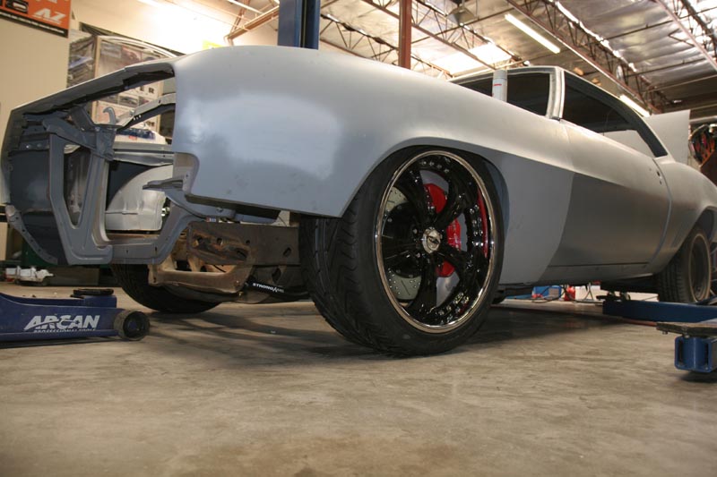

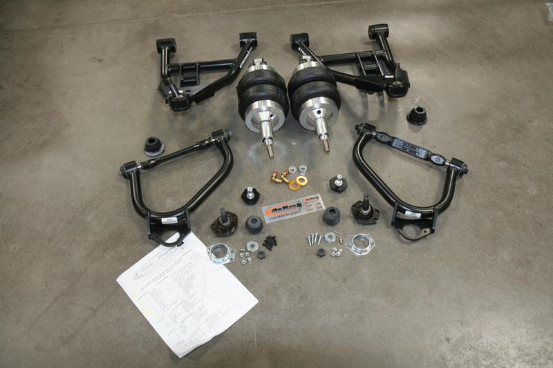

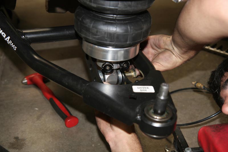

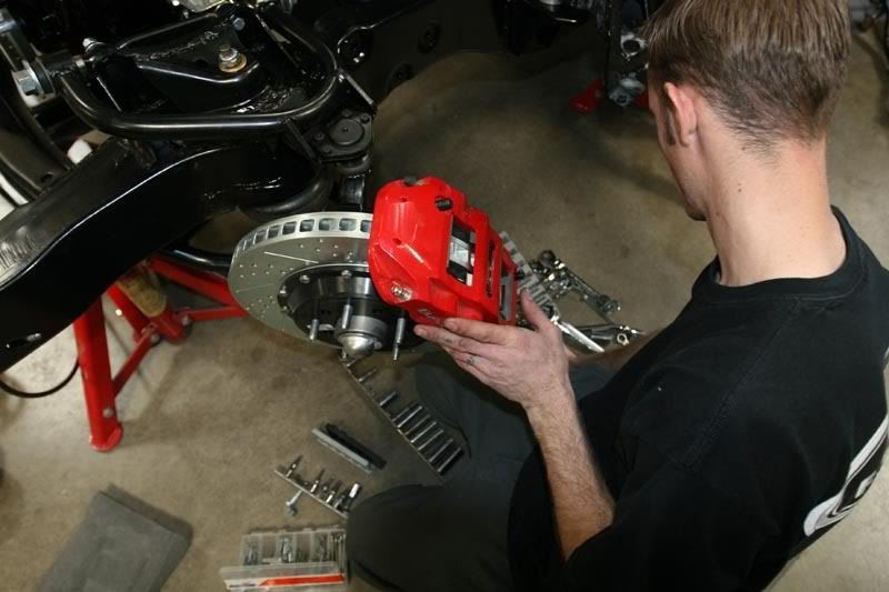

The Suspension, we removed all the factory suspension and installed the Air Ride Technologies upper and lower control arms up front with the Shock waves so we can get the car low.

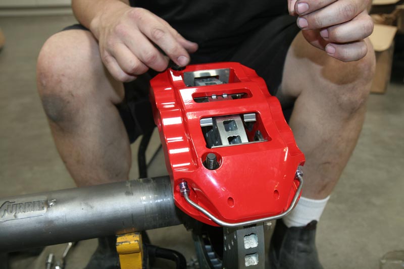

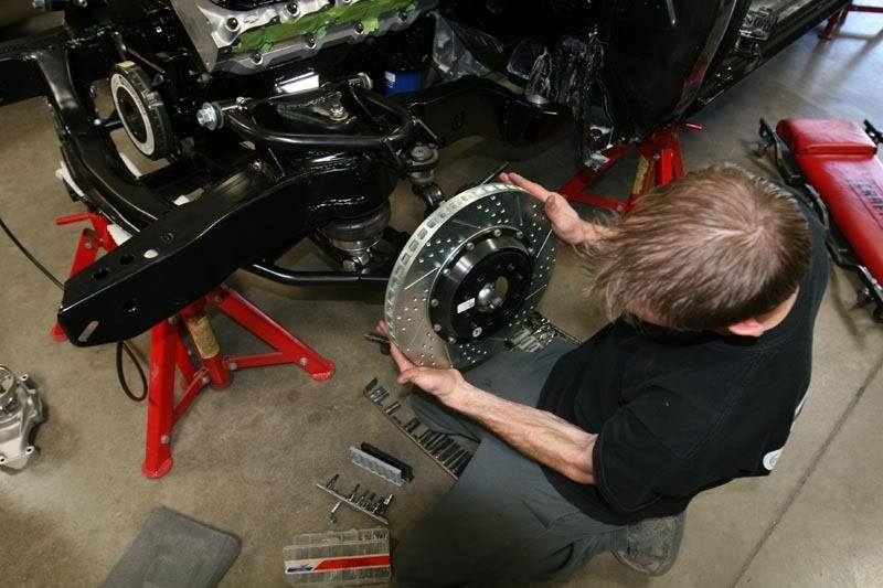

Huge 6 piston Baer brakes all the way around
Chris Fesler

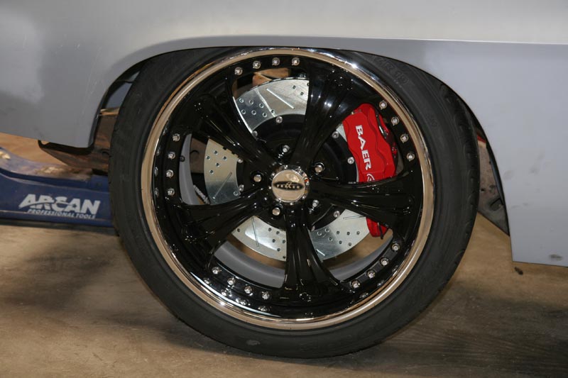

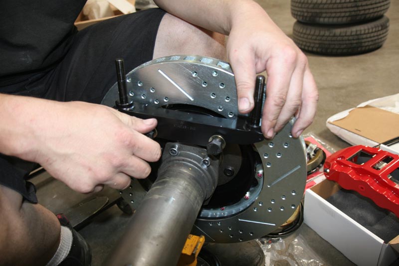

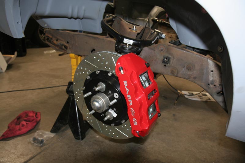

19X10-inch FS901 Fesler wheels with black centers installed up front

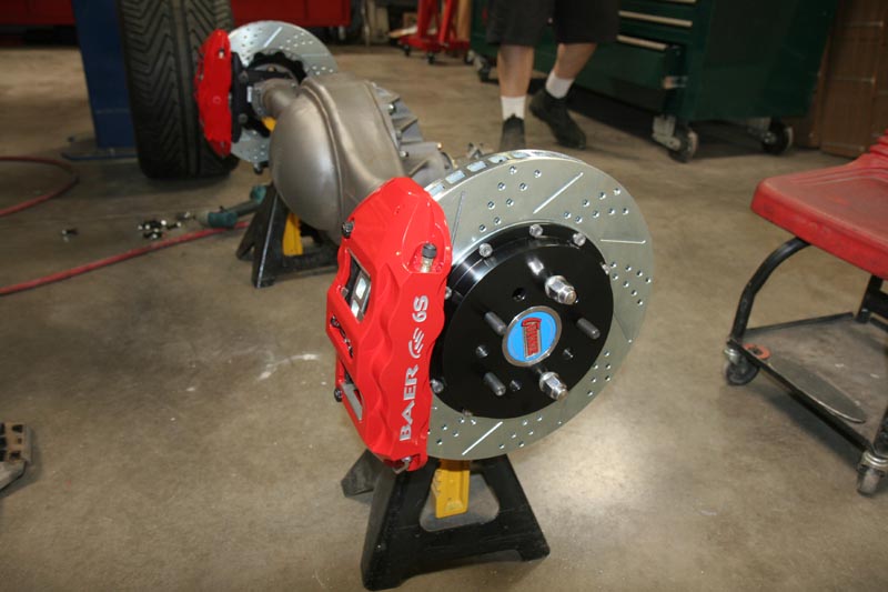

6 Piston Baer brakes installed on the rear custom built Currie 9-inch rear end this car will be able to run a 13.5 wide rear tire if desiered.

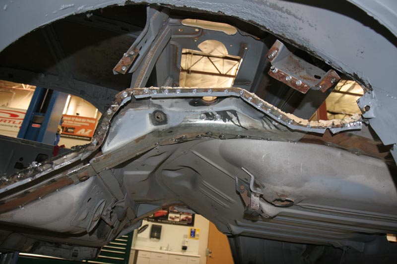

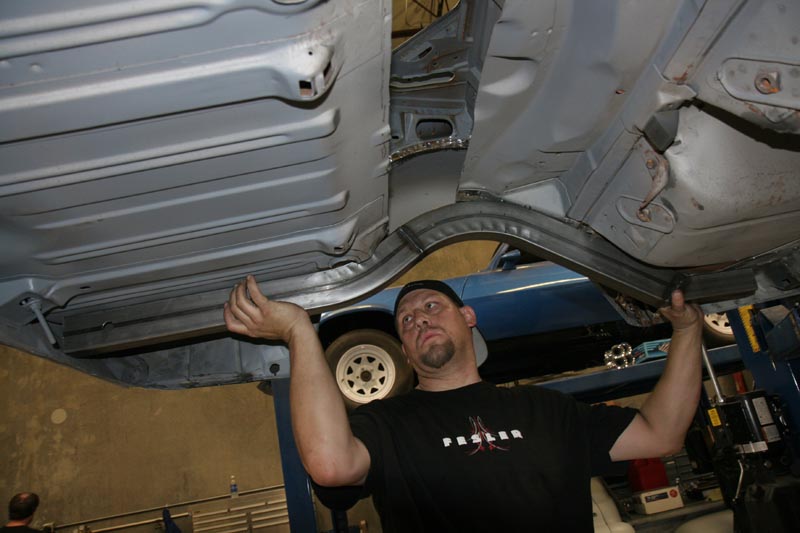

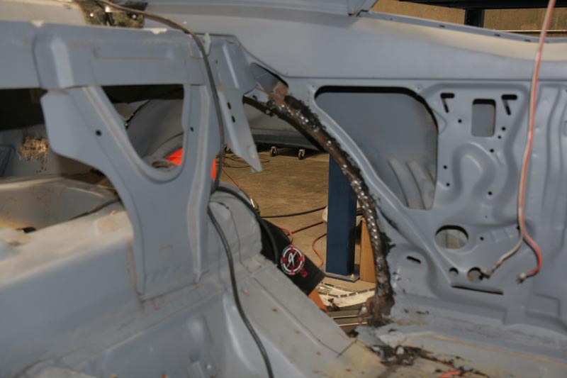

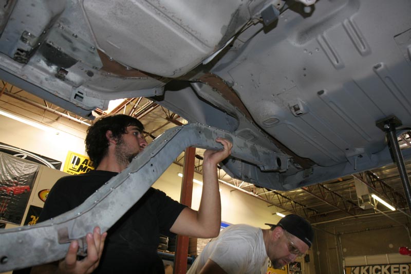

Tubs
The rear of the Camaro is pointless from the factory with the way the rear frame rails are installed any kind of horse power would bend them up so the best thing to do with them is to remove the factory ones and install some good ones that can handle horse power
So we cut out the stock rear frame rails and inner fenders so we can make some new ones that will fit the larger wheels
The rear frame rails will be moved over a bit as well to clear the larger wheels and then we will build some custom sub frame connectors so strengthen the under side of the car
Chris Fesler

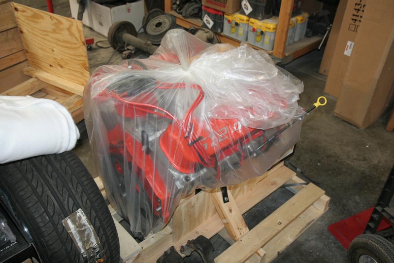

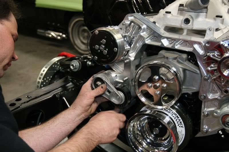

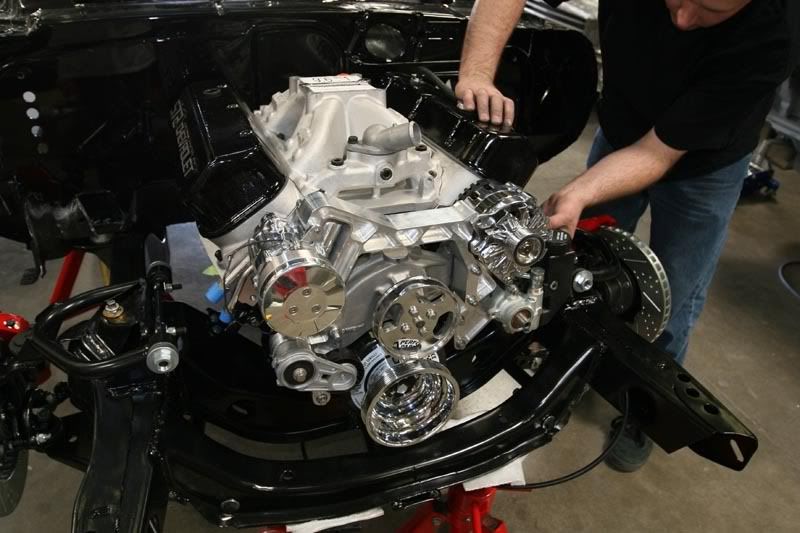

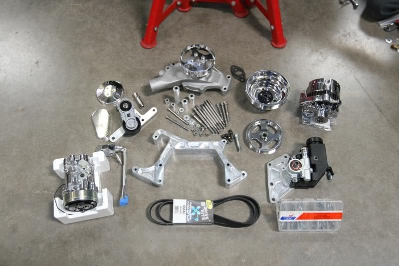

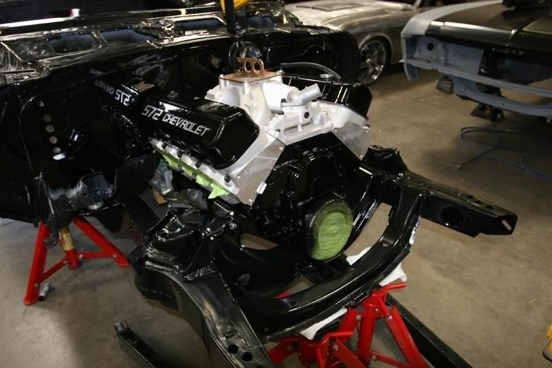

The Engine

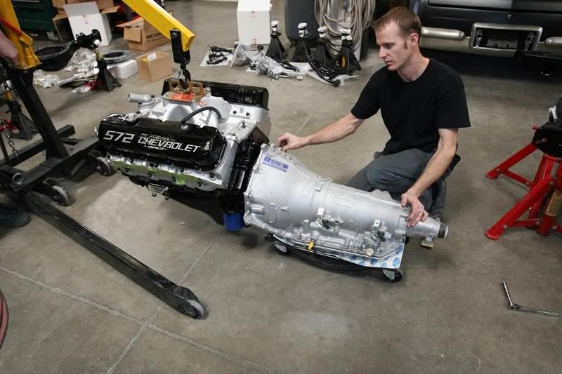

for anyone wondering why we wanted to strenghten the underside of the car maybe this will answer your questions
GM Crate ZZ572 Deluxe engine
stats
620HP on pump gas
650FT
Forged Crank
Forged Pistons
Forged Rods
.623-inches of valve lift
Compression 9.6:1
Rocker arms Aluminum roller style
850CFM carb
Aluminum water pump
will run on 92 octane all day long
Add the Vintage Air Frunt Runner system and its good to go
Chris Fesler
