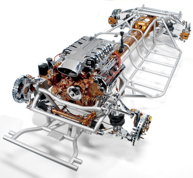

Send me some specs on the chassis geometry and design. I want to do something similar with my 67 chevelle. I already have the c5 components and ready to go!

The front has been narrowed 9 inchs and the rear has been narrowed 7inchs , the torque tube is 9 3/4 inchs longer ,I used an earlier corvette rack ,all custom made sway bar front and rear ,as for the design ,it all has to do with how low you want the car to sit ,floor height ,wheel size ,ect . I wanted a low floor height ,so I made my main rails run in the centre of the car ,
