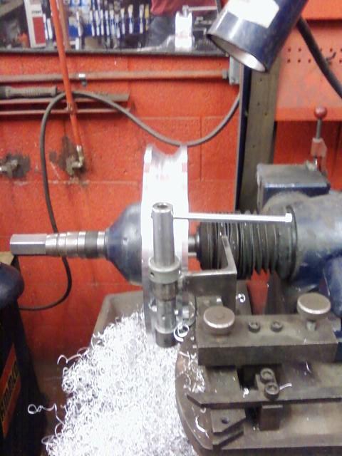

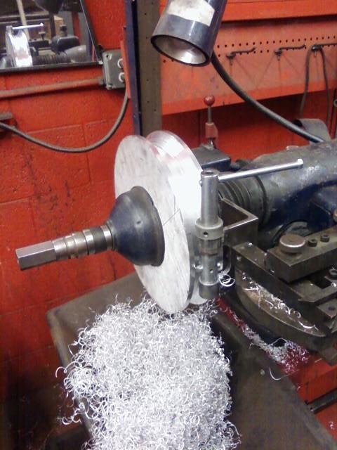

Been wanting to get a tubing bender for a long time. Downloaded the HMP200 plans from Pro-Tools several years ago,but just got around to start building my version recently. I deviated slightly from the materials list to use what I had for materials and to fit the tools I have at my disposal for the fab work( drill press, chop saw, Lincoln SP-175 Plus MIG, and the brake lathe at work). It's almost done; I'm making the 1.75" x 6" die from 6061 aluminum using a brake lathe and a radius cutter I made myself. The die groove isn't finished yet in the pics. I just roughed in the cut before using the radius cutter. Makes a huge mess! So far I have $108 in materials spent.
I'm planning on turning my '66 malibu into a track car and have to revise the rollcage to different specs( 1.75"x .120 DOM vs. 1-5/8"x .134 ERW).

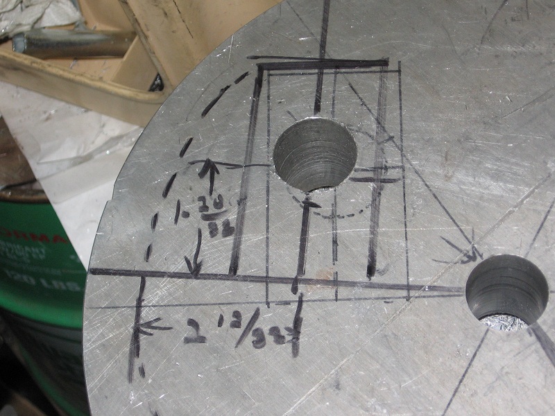

Here' s a pic of my 6"CLR x1.75" die so far. Almost done.

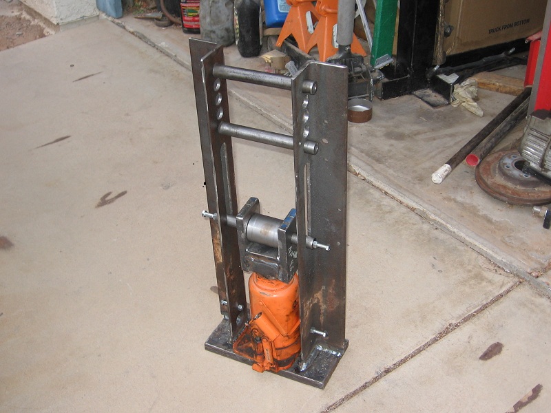

Default Homemade bender all done

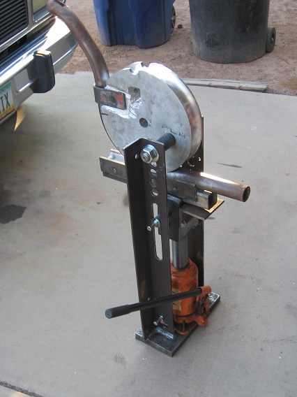

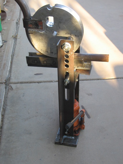

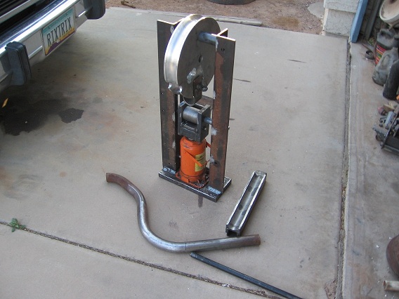

Finished my Pro-tools HMP200 type tube bender. Only thing I had to buy prebuilt was the top pivot bolt assembly from Pro-Tools. Works very well. Only takes about a minute to bend 90 degrees. Now that I know it works. I'll wait 'til HF has another sale and get an air/hydraulic jack(I'm old and lazy!) I did just recut the die to make the fit tighter and the distortion is very minimal now. I have enough material in the die to make another pivot hole to do 180 degree bends, I think. That's the next experiment. Total cost so far: $184

Congrats ! Nice job !!
Be careful when you do off-set bends. You'll end up with dog legs if it's just slightly off between the 2 bends. I purchased a smart level and set that on a 12 inch piece of conduit mount, tightened the clamp down on the tube and set it to zero before pulling the bend.
