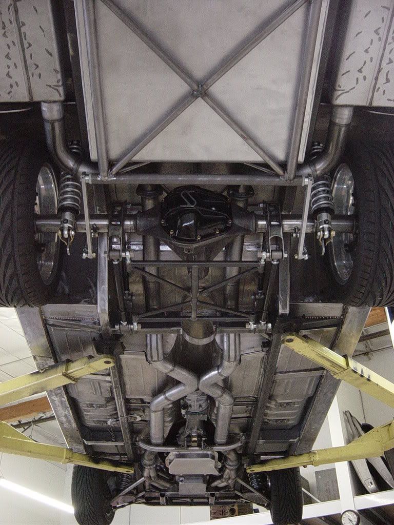

We just got the car back from Tom Face(scottys mufflers) with the headers and exhaust system done. Here are a few underside shots.
Scottys used the following parts:
SPD 3/8 cnc flanges
SPD merge collectors
2" primary tubes
SPD V-band clamps
Spintech 3" oval tubing
3" round tubing
6 heavy duty hangers drilled and tapped to the frame.
Spintech 3" round in/3" oval out mufflers
  #16
