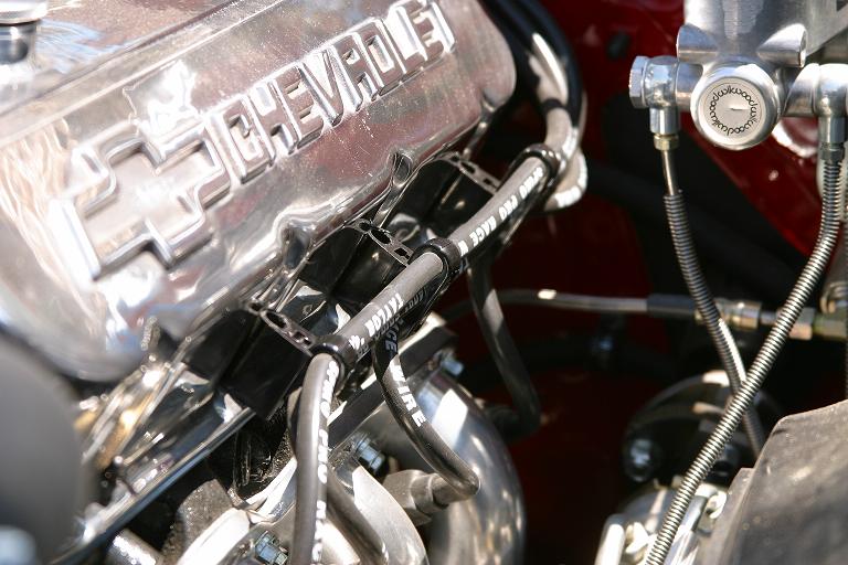

I called the Wilwood tech and realized a major issue on my brake lines to the front brakes, i made the dumb mistake of using the 2 front ports to plumb the lines when i should of ran one to a tee, I will make this change this weekend and try again.

We do 100s of Wilwood systems. It will still be the wrong master Rick. Go ahead and change it while you fixing the plumbing.
