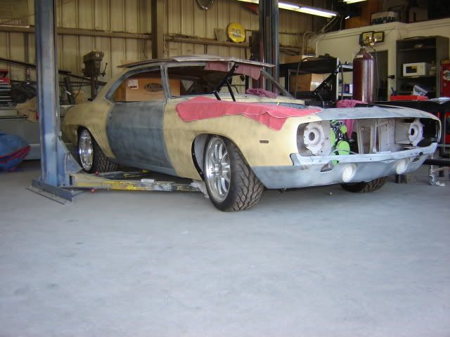

We got the DSE 1/2 drop body mounts which have become a pain. The ATS crossmember wouldn't fit so HR&CS modified the stock one
and here it is almost at ride height
I remember reading the problems they can cause in Vegas69 build thread.

Yeah those 1/2" lower body mounts can be fun to work with! I had to do the raised tunnel and all too! Never again!!

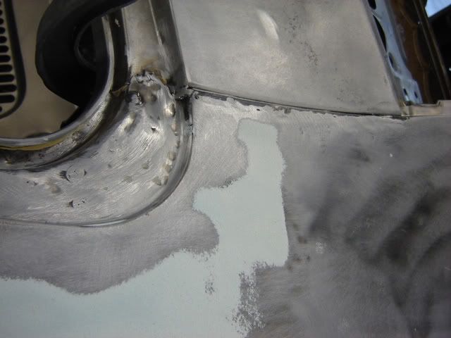

Been a while since there's been much progress on the car. I spent a bunch of time copying receipts for Hagerty trying to convince them about how much it's worth. After that was done it it got soda-blasted, this past week, actually. I was really sweating what was under the filler, hoping we hadn't picked out a pile. Fortunately, everything looks pretty good, and it seems all of my time spent lurking around reading up on this stuff really paid off. the quarters were replaced in kind of a strange way, but everything is solid so I can't complain.

Only other weird little thing was the warping with this vent:
Fixed it once but it ended up just the way we found it.
