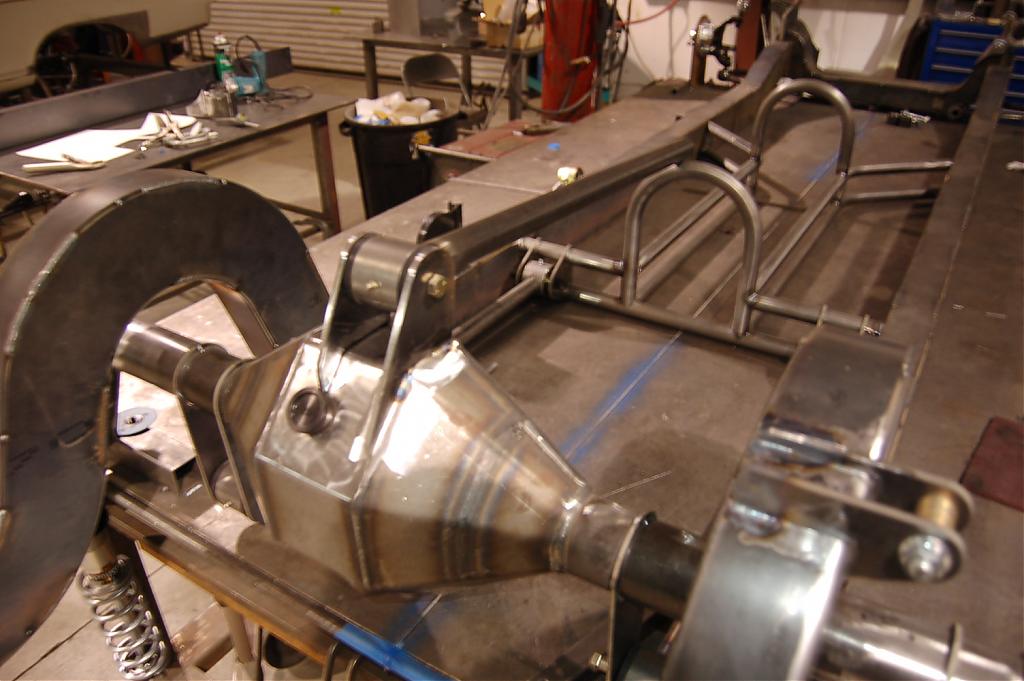

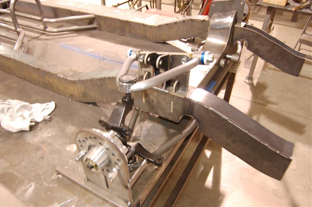

Default Crap pics
Well here are some crappy pics of the chassis. We developed all the control arms and delrin bushings. We are using Global west crossshafts at this point. It offers about a 3 inch roll center and with the rack mounted low it should give pretty good engine clearance. In the rear it has Johnny Joints for the 3 link to allow bind free movement with Big poly bushings. The driveshaft hoops are tall to allow the engine to be pretty high in the frame since the ride height is 6 inches from the ground.
I hope to have it on the ground by the time I'm back on Sunday from the Super Street Car Nationals.
We also have about 75" of the tri five chassis layed out now in Solidworks and will be starting on the Prototype very soon and begin filling sme of the pre orders we have.
Sorry about the crappy pics,
